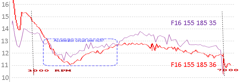

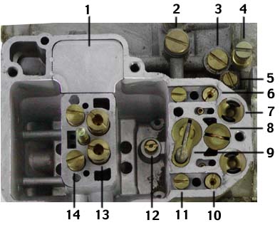

October 10, 20177 yr comment_532046  Just a thought:  I think the characteristic shape we see with all E Tubes where the richness over-shoots on launch may be due to the squirt from the accelerator system. The area in the dashed box below is what I refer too. I think the liquid fuel squirt is too much and it over enriches the A/F ratio.   I also think it continues for a while as the liquid will hit the manifold walls and will take time to evaporate and become consumed. (See the MP4 video below)  Weber 40 DCOE acceleration jet.mp4  To test my hypothesis, once your valve train is sorted and you do some F2 runs. I would be grateful if your could do a run with the spill jet (item 12 in drawing below) blocked by metric bolts. This will turn off the accelerator circuit and hopefully remove the rich dip on start.  Thanks!      Edited October 10, 20177 yr by 240260280 Link to comment https://www.classiczcars.com/forums/topic/56375-weber-selection-and-initial-jet-tuning/?&page=14#findComment-532046 Share on other sites More sharing options...

December 1, 20177 yr comment_536381 Thanks for the update! I'm glad the tapping has gone. We can pick it up in the spring. I have been reading a great deal about DCOE's in the last month and it is possible the rich at high rpms could be due to the acceleration jet leaking. We can look into it in the spring. I should have my SK's running then and can work in parallel. Merry Christmas!  Link to comment https://www.classiczcars.com/forums/topic/56375-weber-selection-and-initial-jet-tuning/?&page=14#findComment-536381 Share on other sites More sharing options...

December 2, 20177 yr comment_536399 FYI what Passini says about Pump Jet leaking at WOT (btw Keith Franke claimed this did not happen). It is why I tune main circuit with bleed/spill jet's blocked. A very large pump jet can enrichen the top-end mixture to such an extent that a larger air corrector may be needed in order to prevent over-richness. This may, of course, in certain contexts achieve the desired mixture slope but, on the whole, large pump jets making up for the main system weakening off too much in the top range cannot be recommended.  The pump jet is also in operation during full-throttle running. There being sufficient depression at high revs and a wide throttle opening to lift the weight holding down the delivery valve ball. Once the flow has been initiated, only the weight returning the ball to its seat will stop it entirely because the pump jet orifice lies below the fuel level in the float chamber. This is one important reason for not mounting DCOE carburettors with the trumpets tilted upwards more than about five degrees, or the siphon effect will overcome the weight and the flow will continue in the form of a dribble which will enrichen the mixture detrimentally.  In addition to the depression in the venturi, high gas speeds past the pump jet are in themselves capable of drawing fuel because of the streaming effect of the low-pressure area which forms downstream of an obstruction (e.g. pump jet protrusion into the throat). The very mixed blessing conferred by the fact that there are, in most cases, several combinations of main jet, air jet, emulsion tube, nozzle, and pump jet (leaking) that will all produce the same flat-out (WOT) maximum power.  None of these three items (rod length, discharge bleed, spring) have any effect on the delivery from the pump jet at full chat (WOT) when it is acting as a high-speed fuel bleed (leaking).  Figure 5 shows that the pump jet is also in operation, there being sufficient depression at high r.p.m. and a wide throttle opening to lift the weight holding down the delivery valve ball. Once flowing, only the weight returning the ball to its seat will stop the flow entirely, because the pump jet orifice lies below the fuel level in the float chamber. This is one important reason for not mounting the DCOE carburettors with the trumpets tilted upwards more than about five degrees (absolute max: 7degrees), or the siphon will overcome the weight and the flow will continue in the form of a dribble and enrichen the mixture detrimentally.  The pump jet is the only one that delivers fuel in liquid form and not as an emulsion. So, unless the gas velocity is sufficiently high there will be little break-up of the stream. High gas speeds past the pump jet in themselves are capable of drawing fuel due to a 'streaming' effect of a low pressure area downstream of an obstruction. Link to comment https://www.classiczcars.com/forums/topic/56375-weber-selection-and-initial-jet-tuning/?&page=14#findComment-536399 Share on other sites More sharing options...
