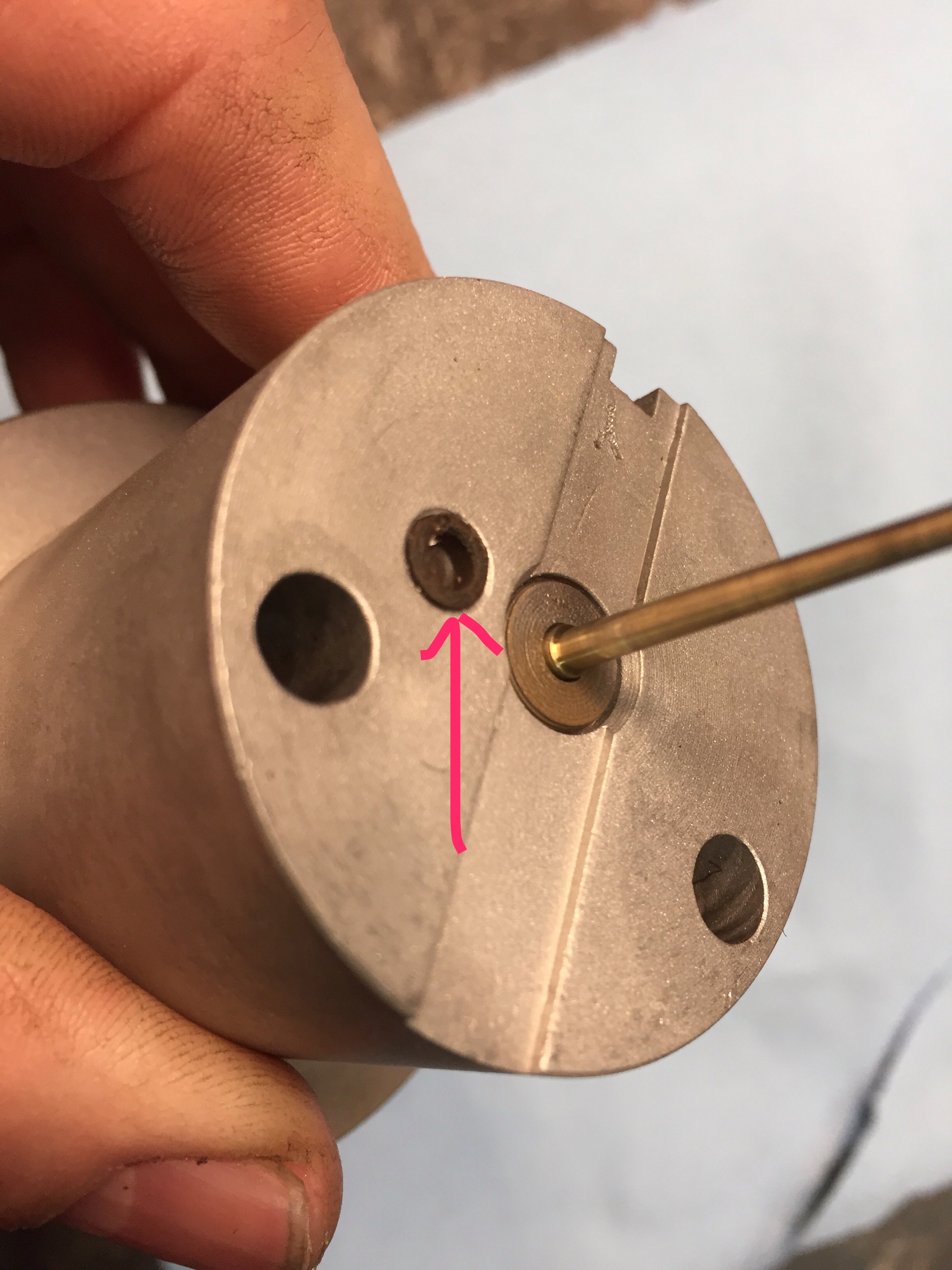

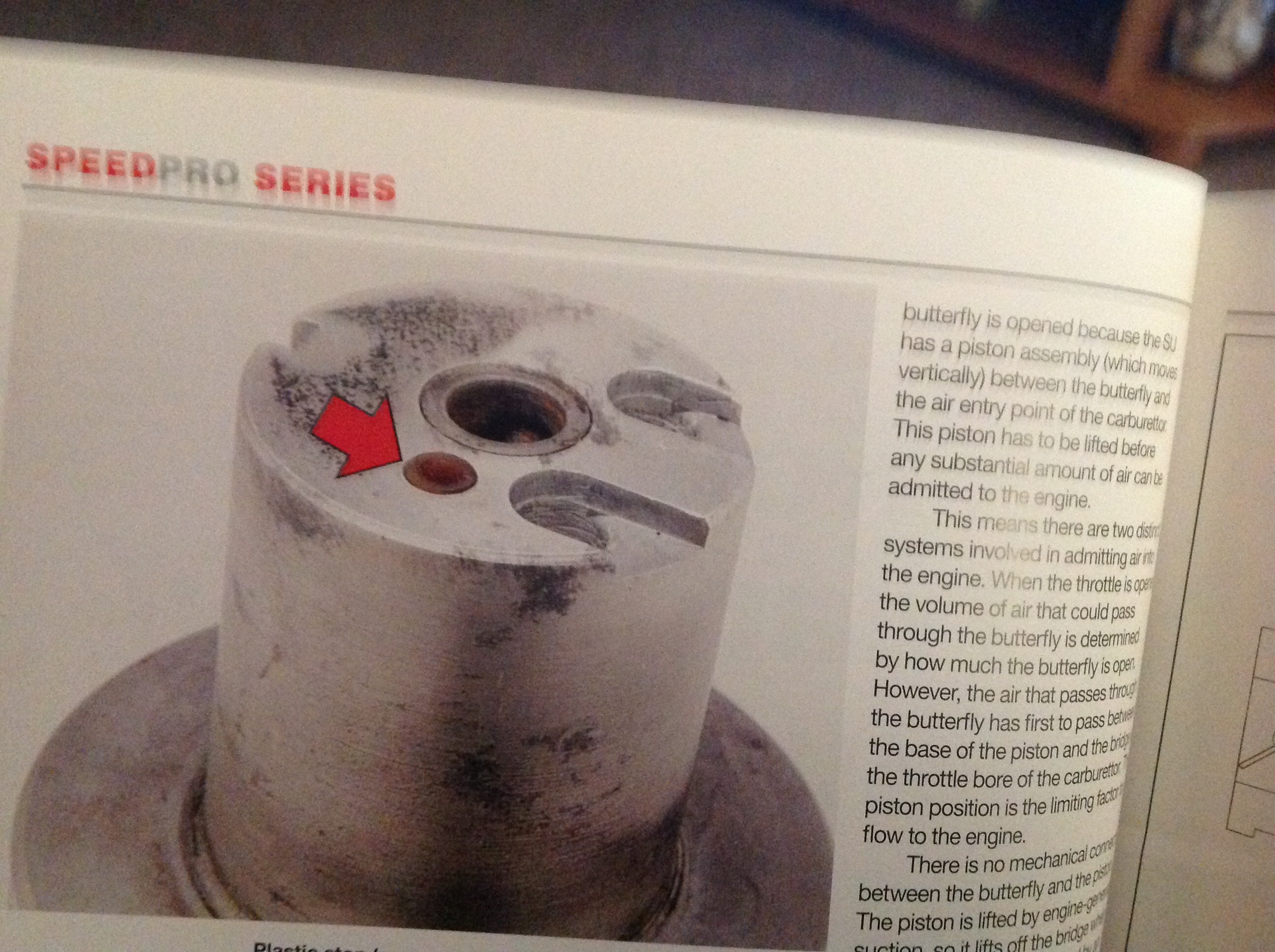

It talked about piston movement and how venturi vacuum makes it move according to load. Great. Then they mention the special case where the piston is all the way down, like at idle, or at startup when the flow rate is so low that the DeltaP over the bridge hasn't gotten high enough so that the pressure diff can't move it yet. The piston has to be held mechanically slightly off the bridge to allow SOME air to get through. How is this accomplished? WIth this apparently long forgotten item on the bottom of every piston.
That little round plastic thing is supposed to stick up ~.010 below the piston face to keep it off the bridge.
So far I've checked two sets of darn near fresh SU's, and found both to have that little spacer guy mostly flush with the surface on both pistons. I have another car with a fresh set and a couple of local cars with more fresh sets to check yet.

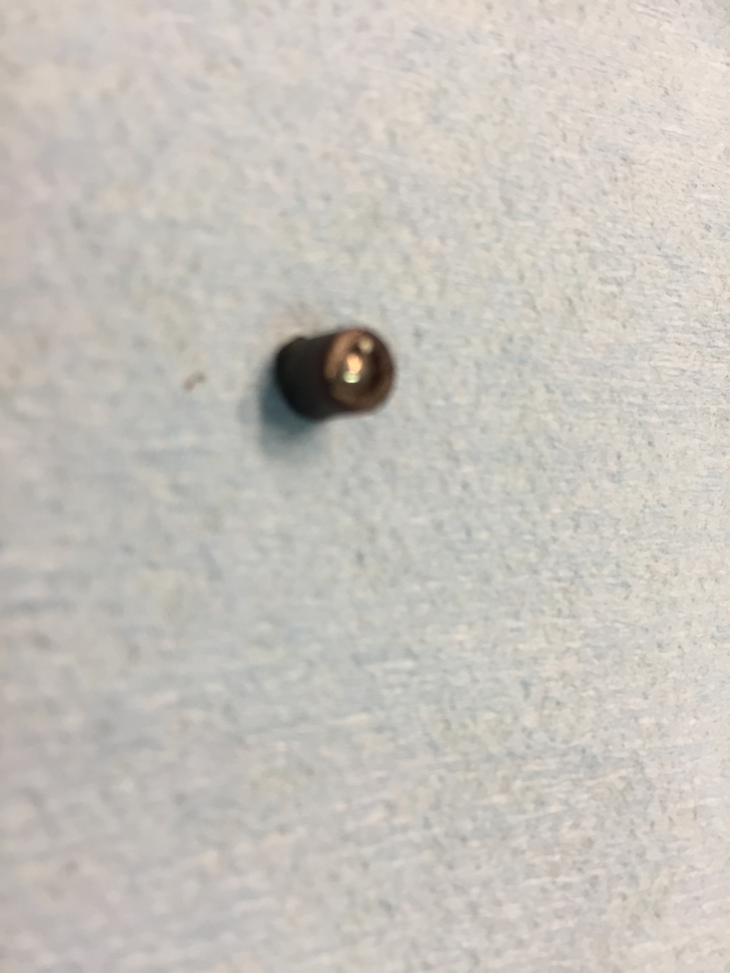

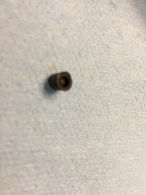

Here is it in (crappy) close up. Its a little plastic tube with a ball bearing pressed into it to slightly expand it. It needs to be pressed into the piston, and left proud 0.010 or so. I suppose it gets pressed in a bit everytime the piston drops if its old and doesn't have enough friction to stay put.

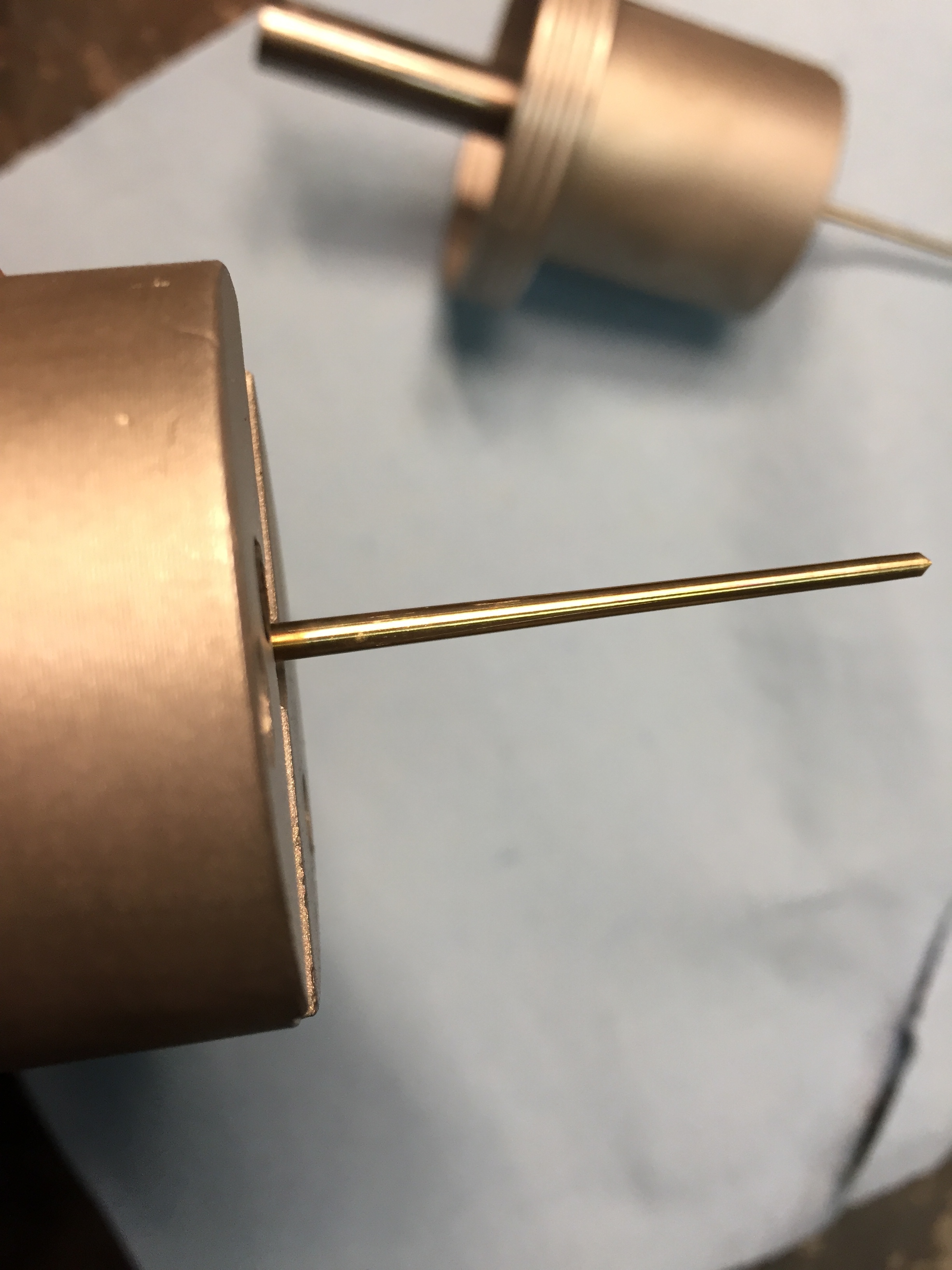

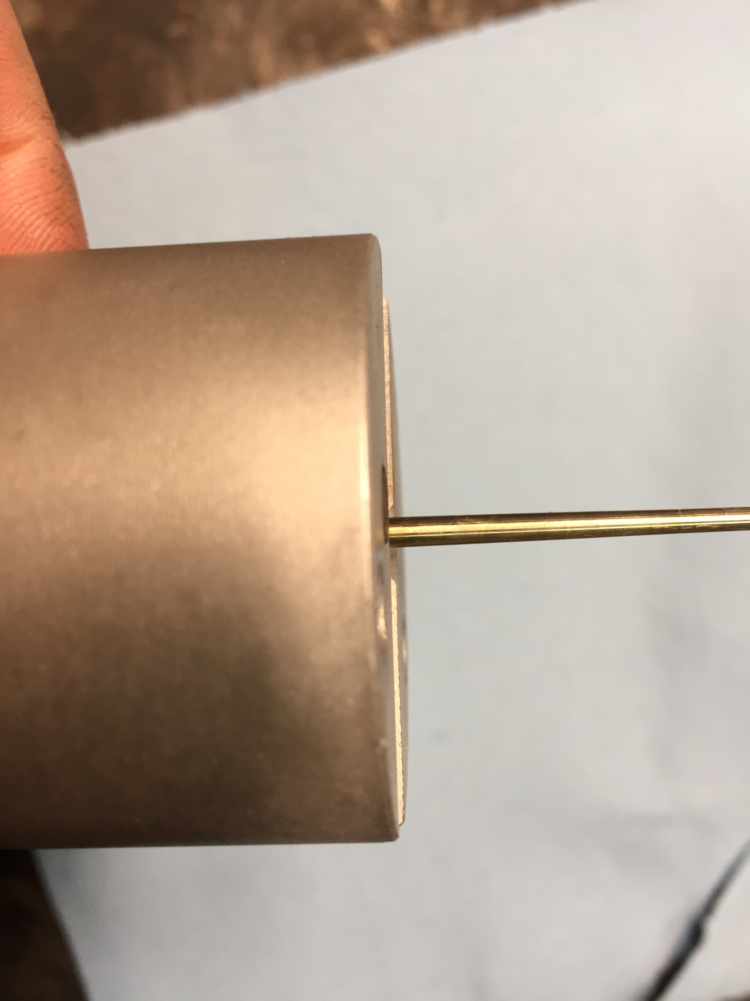

Here is pictures of how I found them in my Z, looking from a sharp angle you can barely see the black line that just proud of the surface (like .001)
I have added a blob of epoxy on top of the button thing on the SU pistons in the 71, then shaved them down to 0.01. This will provide a more stable and lasting bridge spacer. The car starts better, not that it was poor before, and idles at a more stable rate.

I would propose that's what the milled slot down the center of the piston does. It provides a passageway across the bridge right at the needle even when the piston is all the way down.
That slot down the center is in fact the key to all this. Thanks CO.
The book I was reading, when making reference to this plastic stop, shows a piston without the slot we have in our version of the SU. I have set of SU's (not the ones above) that have this piston style as well, which just served to confuse me more.
This style of piston clear depends on that stop to provide at least startup air access. Ours do not have this issue. The plastic stop likely should be flush or just slightly off to do nothing more than provide a soft landing for the piston.
