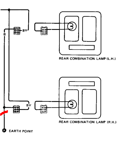

My battery is only 2 years old and measures 12.03 volts. When I measured at the socket, I put the neg on the outside of the socket and then touched the parking light pin getting the 10 volts and 5.3 volts. Looking at the schematic, isn't the ground for both the rear lamps the same and so I'm not sure why one would work fine and the other not if it was a ground issue?
There's a splice along the way.  The right side has essentially two ground points, one at the splice and one at the terminal end of the wire.
I put a picture n my other post.  Maybe you're reading your own schematic?

Hi Zed, I guess I don't follow you on where there might be a splice. I'm just going by my service manual schematic and I'm not very good at this wiring stuff.
Are you on a phone?  I posted a picture from the Body Electrical chapter and underlined the splice.

Nissan would make splices in the harness for efficiency sake. Under the loom tape in the harness somewhere will be a small splice. They strip a little section off a wire and then strip the end of the other wire and attach them to each other with a small copper crimp. They can be hard to find. Sometime they corrode...another thing to check is take your meter and with a long lead or a long piece of wire tie the black meter probe to the negative battery post and post up your voltages again...
So between where the harness comes through the grommet on the right inner fender wall and where it branches off for the right lamp (about 1 foot of wrapped wires), there would be a splice?
