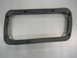

Wouldn't the rear spoiler disrupt the "back draft" effect on his car, for better or worse?  I've got the part number for the tailight rubber if you need them. Still available from Nissan, my local dealership ordered mine. Maybe that's why I have no smell but I was thinking my spoiler caused it to ramp up and away instead of rolling back into the hatch area?
What kind of shape is the rubber boot under the leather boot at the shifter?
Google/images these numbers to make sure. The date matches up to my new tail lights purchase  butt they have different descriptions and are priced a couple more bucks for one than the other? Same exact gaskets just different sides.
26552-E4100 RIM-COMB LAMP $34.29
26557-E4100 GASKET-LAMP $28.96

I'm almost positive those lights come out through the back. No need to remove the finisher panel.
I would do this first. Mine were bad dried up and cracked. Zed Head reccomendation on sealing that vinyl access panel on the inside bottom of the hatch would be next, for me. I had my spoilers painted and removed them. While that piece was off I was overwhelmed with fumes. DUI defense? LOL
