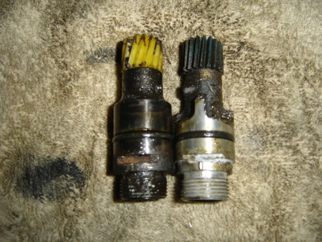

June 10, 20169 yr Author comment_496681 Well that was easy. they're totally different in design. 4 speed is on the left and won't fit into a 5 speed I have taken the blue one out of. Link to comment https://www.classiczcars.com/forums/topic/55612-speedometer-gear-question/#findComment-496681 Share on other sites More sharing options...
June 10, 20169 yr comment_496686 People have cut new slots in the housing. Easier to poke the little roll pin out and swap gears. Link to comment https://www.classiczcars.com/forums/topic/55612-speedometer-gear-question/#findComment-496686 Share on other sites More sharing options...

June 10, 20169 yr Author comment_496690 19 minutes ago, Zed Head said: People have cut new slots in the housing. Easier to poke the little roll pin out and swap gears. That's a good idea, thanks again! Link to comment https://www.classiczcars.com/forums/topic/55612-speedometer-gear-question/#findComment-496690 Share on other sites More sharing options...
