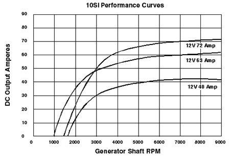

The ammeter's aren't accurate.  Different alternators have different output curves.  They're all much lower at idle though.  That's the basic problem.  A 60 amp and a 90 amp alternator can have the same output at low RPM.  Added a picture of some GM alternator curves, same model but still different curves.
You can waste a ton of time with reman alternators.  Most people describe them as "crap". in general, after having several fail.  On the plus side though, you are learning quite a bit output your charging system which will help you in the long run.  One problem you can run in to is that while working on the charging system, the battery gets run down, then the system is using  significant extra amps to recharge the battery.  So the battery load maxes out the available current at idle.  Starting with a fully charged battery can get you back on top.
