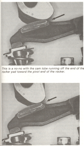

March 27, 200322 yr comment_31568 Well, I happened to look in the drawer and there is another book also, How to Rebuild Your Nissan/Datsun OHC engine by Tom Monroe. It also goes into detail on how to check you contact patch on the rocker pad, basically what you want is the contact patch to be centered on the pad. You can check it with layout dye, or even a black magic marker. You need to cover the pad of the rocker with this, doing one rocker at a time, and assemble the valves, lash pads, etc with a good cam lube, and rotate the cam 360 degrees with the while the rocker pivot is threaded all the way in and the jam nut is up as far as it will go. Then you will be able to remove the rocker arm and check the contact patch. Thicker lash pads will move the contact patch toward the rocker tip, and thinner moves it towards the pivot. BTW, some of the aftermarket cam manufactures may be able to supply the lash pads, as well as Nissan Motorsports. The are available in thicknesses from 3.85-8.5mm (.150-.330 inch) in .010 increments... So you can see, this can be a very involved process.... One which I haven't done either, I'm learning it while I read it myself....:cross-eye Link to comment https://www.classiczcars.com/forums/topic/5338-lash-pads/?&page=2#findComment-31568 Share on other sites More sharing options...

March 27, 200322 yr comment_31575 Here's the pic... The top pic shows what you don't want to happen. The top pic would need a thicker lash pad to correct.... As far as doing it while the engine is running? You doing one of those Zedrally type porting jobs? Link to comment https://www.classiczcars.com/forums/topic/5338-lash-pads/?&page=2#findComment-31575 Share on other sites More sharing options...
