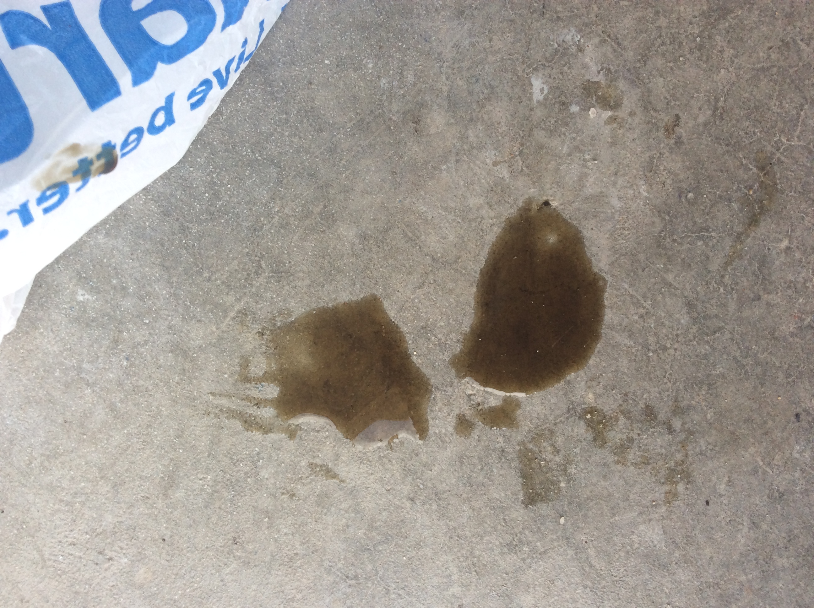

My father and I put the oil in the gallon container the new oil came in,that way we can dispose of it correctly. So I dripped some on the ground.
That oil doesn't look milky.  It seems clear, I can see the concrete underneath.  You might be on a wild goose chase (this would be good).  Looking at your engine picture, the blue stuff looks like tape.  Are those wire ends that are taped together?  Could be that your coolant temperature sensor wire came loose.  There's hope, don't do anything crazy.

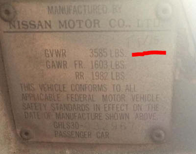

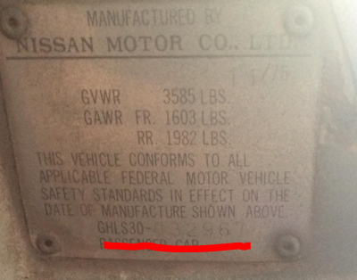

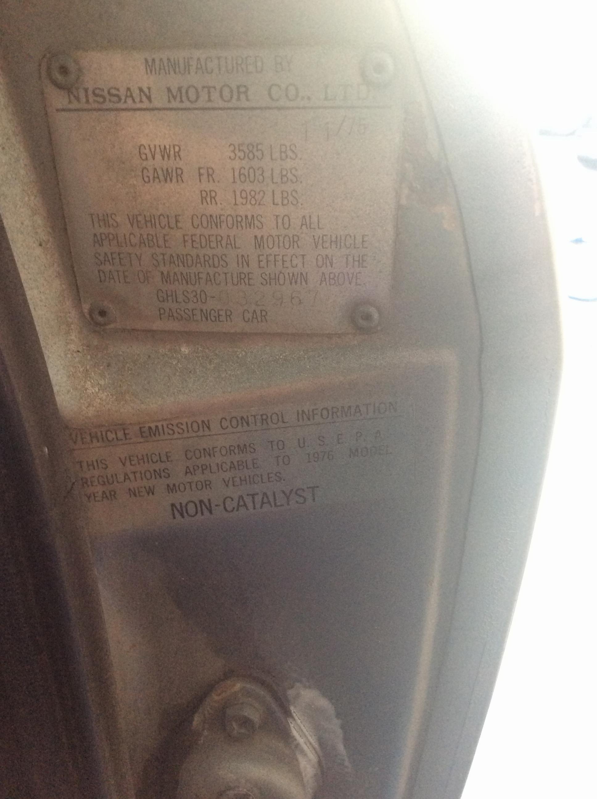

What is the date I underlined in the picture.  Can't see it.
If you really want to know, you'll pour the oil in to a clear container.  Water will separate out eventually if it's in there.

You have a 1976 car.  Site was right.  That's probably the stock engine.  Compare the title VIN to the VIN I underlined below.
