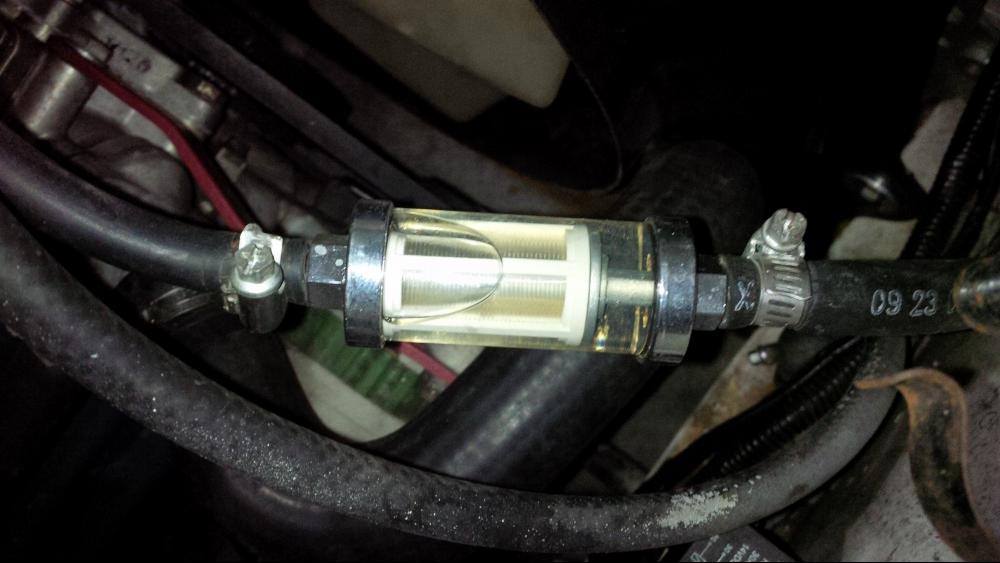

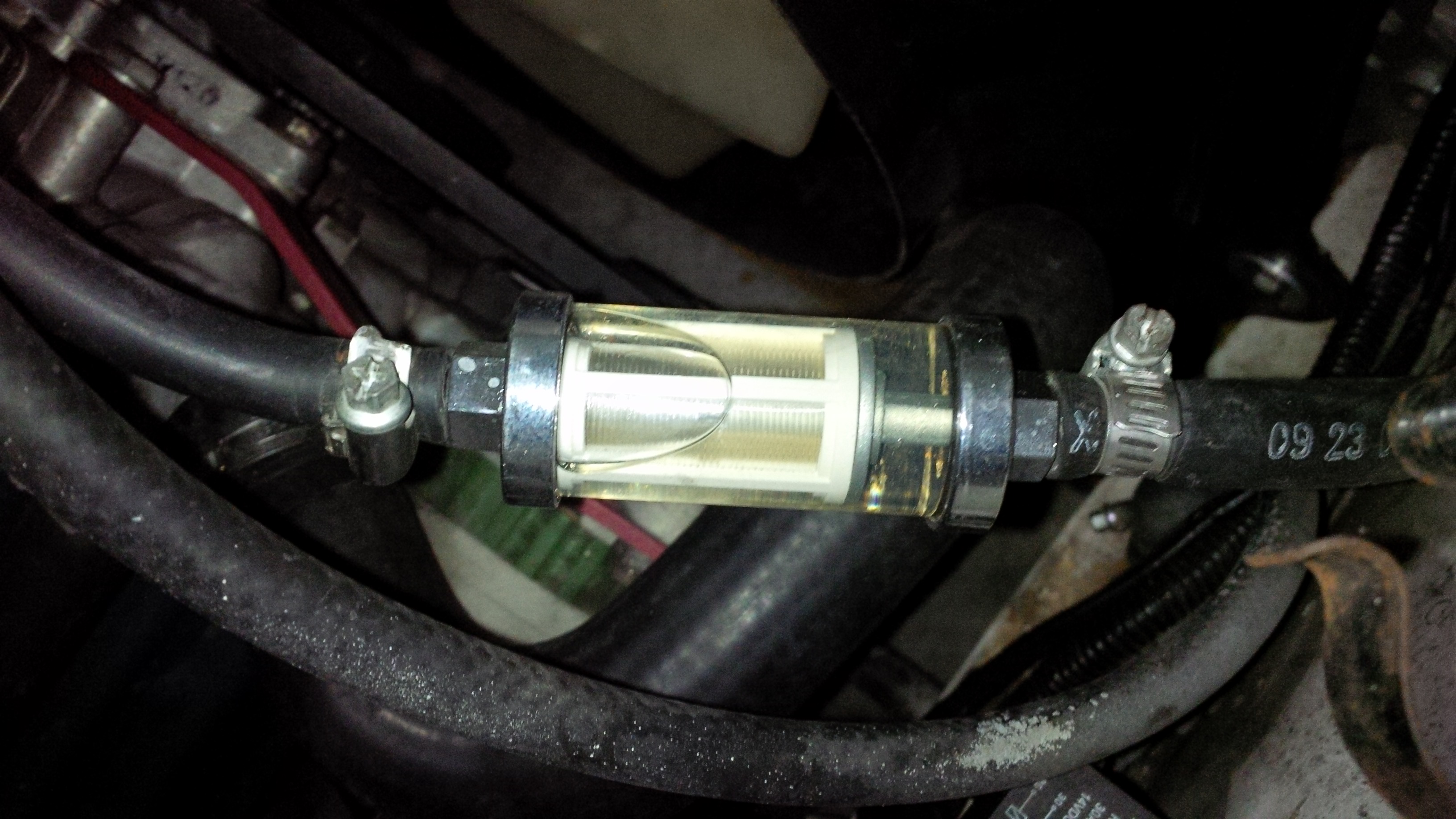

Here's a question for the carb guys - would measuring fuel flow on the return line be worthwhile?  I don't see it in his pictures but I don't really know what I'm looking at.  Could be that his guy is running it dead-head style and the insulation is being overpowered at a stop, or he just has low flow for other reasons.  If I had carbs I'd probably use that as an overall check of the lines and fllters.  Without good fuel flow past the carbs vapor-lock could still be a problem.
Also - I attached a picture of what looks like a hose laying on your throttle linkage.  Could cause throttle feel issues.

I moved the fuel lines further back so it does not make any contact with the linkage!

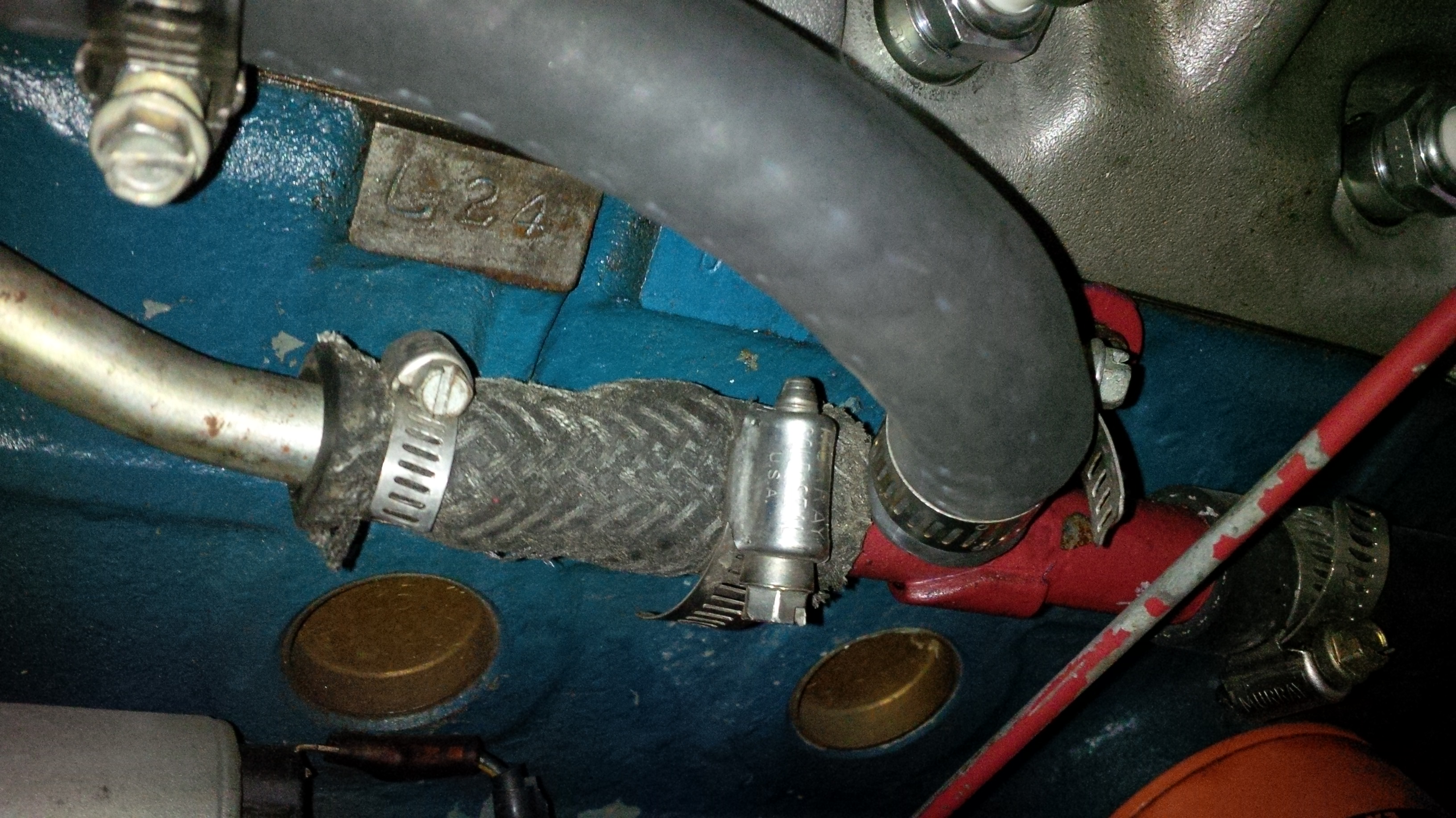

Here's something easy to look at that might be significant, especially since you're in Panama and probably don't use your heater - are the heater core coolant lines from the back of the head blocked off or are they looped back to the water pump, from the head?  Or are they connected properly to the heater core?  Looping the line back to the pump inlet (bypassing the heater core) can cause overheating, in a perfectly fine cooling system.
And, still wondering about fuel pressure, and the return lines for your fuel supply system.  Important.

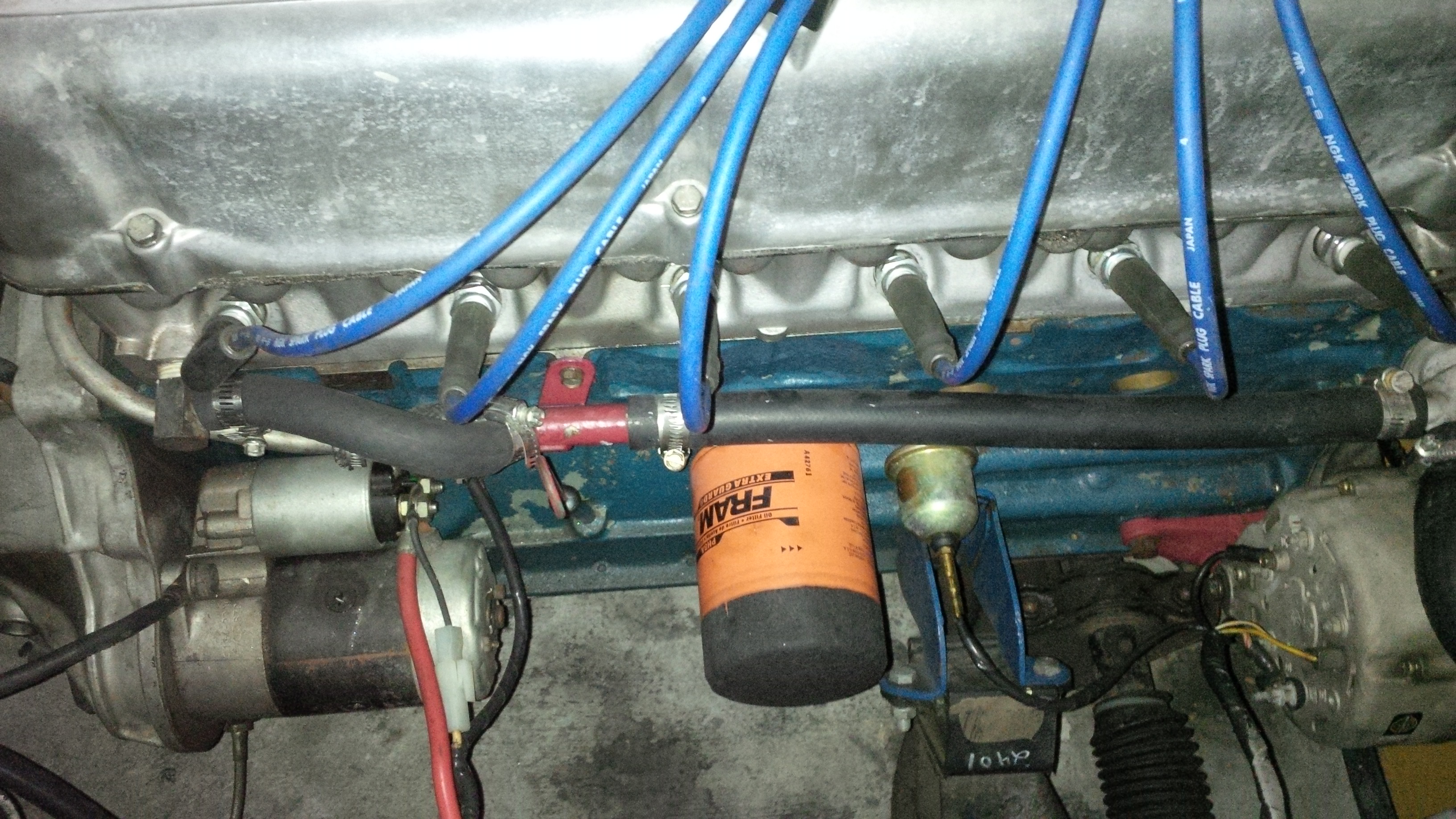

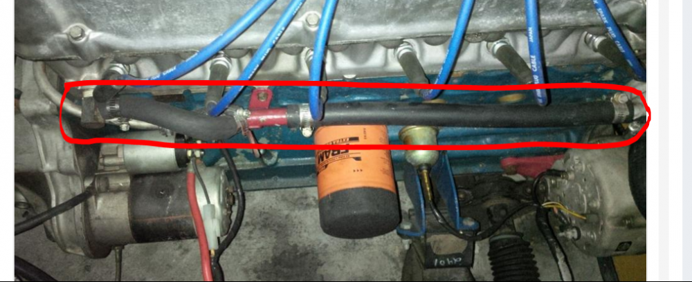

Mechanic came yesterday. We tested the car!! No backfire either on intake or exhaust. Car ran fine. When parking the car after waiting 15 minutes at idle, RPM started to drop from 1000 to 800 and raised again. We even took the thermostat out, He ruled that the problem was the radiator and i needed to take the car to a rad shop for flushing and cleaning. If this did not solve the problem, he will need to remove both lids shown on picture 2 and do a complete cleaning removing any rust inside the wáter channels. By the way who sells these lids? How are they called?
Anyone here has a different approach to the solution he has offered?

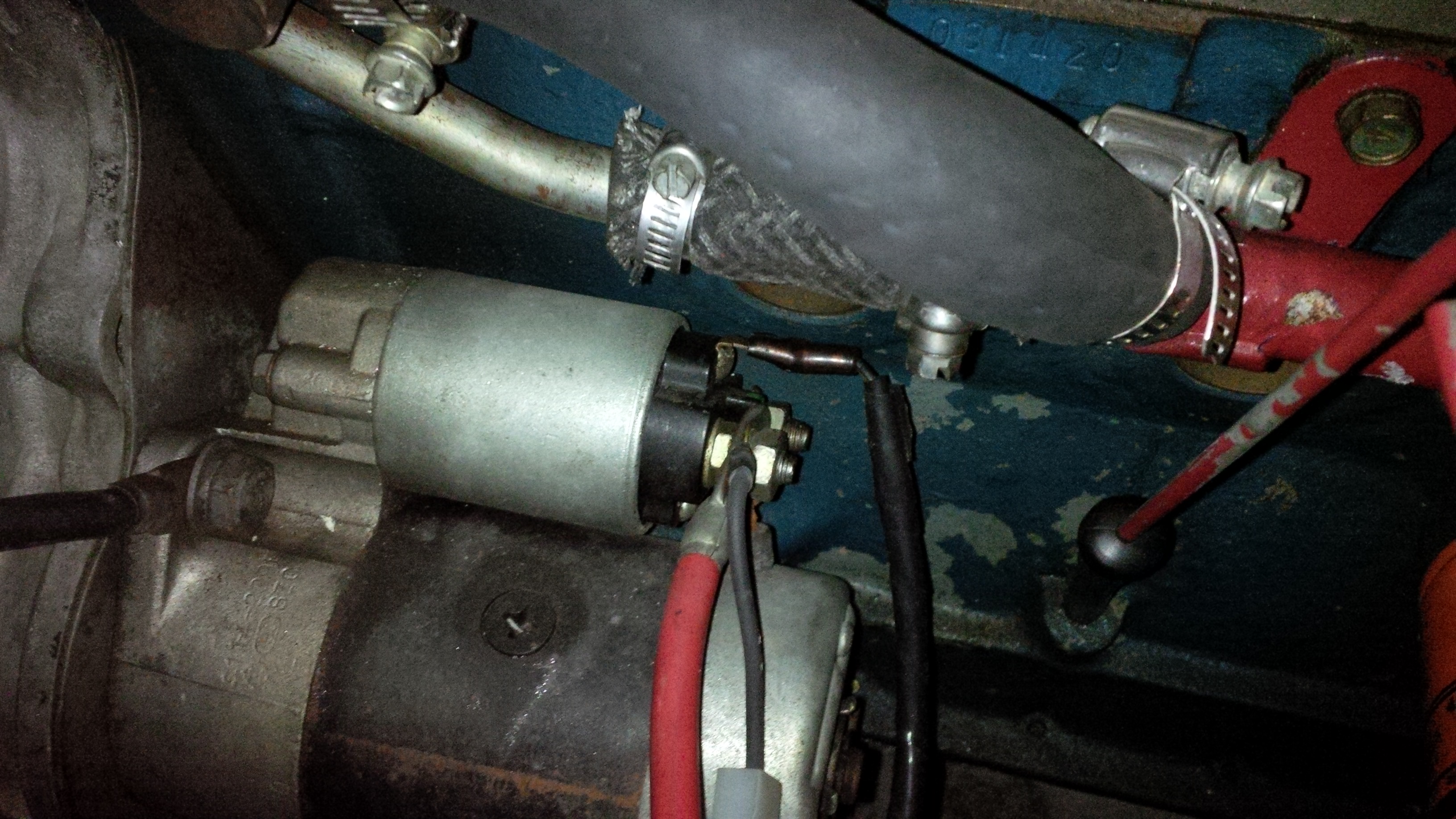

It must be tough down there to find someone who knows these cars.  You said that the radiator works fine "while running the car".  And overheating when stopped is more likely to be an air flow issue.
But I do see that you have the coolant hose looped back to the water pump inlet.  This will allow the coolant to flow back to the pump without passing through the head or through the radiator.  Try blocking that path before doing anything.  No guarantees but it's cheap and easy and will help cooling.

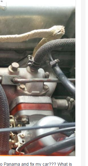

Also, it may be that the way you have those hoses connected runs the hot water through the carburetor heating plates.  I think that there's supposed to be another thermostat in that line to the carbs, but don't really know the system.  But, being in Panama, I think that you could block both of those lines and improve cooling for the engine and avoid overheating the carbs.  That might be the whole problem right there, you're overheating the carburetors.
Hopefully one of the carb experts will chime in.  If I'm off-base feel free to send a torpedo.

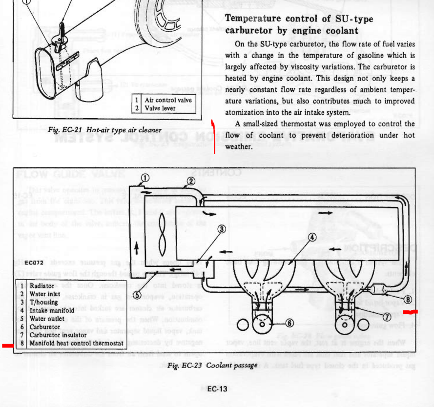

And here's the picture and description from the FSM.  I would check for that thermostat first, and block the line at the back of the cylinder head.  That should give proper flow and control, for cooling and carbs.

The caps are freeze plugs. They look new.

I meant the the thermostat in the picture I posted, at the carburetor heating line.
