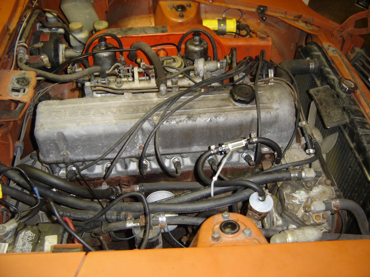

My car has the same A/C, Yorx I believe.  I replaced my pump and it was a huge pain.  Alternator is in the way of that bracket that holds the compressor.  It's a big job, be careful not to break your inspection light, take it loose and lay it off to the side.
Here's mine when I first bought it, the A/C is gone now. :)

I danced all around your question! sorry.  Read this thread and see what you think about rebuilding on the car, I don't think it's possible but I didn't think I's gonna get that old pump off with all the crap in the way.  LOL
