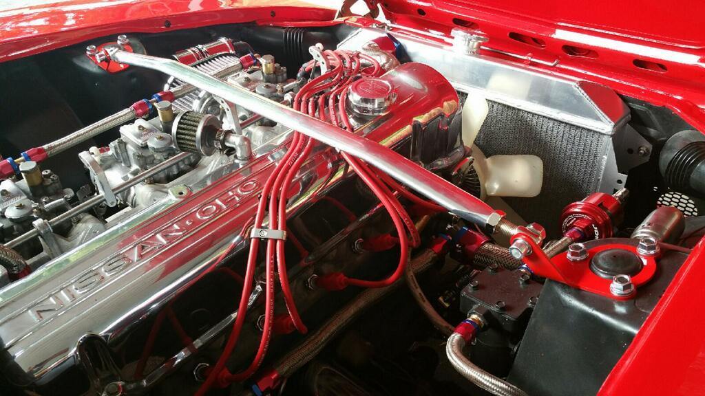

July 23, 20178 yr Author comment_526374 5 hours ago, Consigli said: Gorgeous restoration! Are you going to add a front stabilizer bar like this pic? What are your thoughts? im still debating the strut bar. i do like this one https://technotoytuning.com/nissan/240z/front-strut-tower-brace-datsun-240z-260z-280z-0 https://technotoytuning.com/nissan/240z/z-front-tri-bar-add Link to comment https://www.classiczcars.com/forums/topic/52787-sweatys-rebuild/?&page=29#findComment-526374 Share on other sites More sharing options...

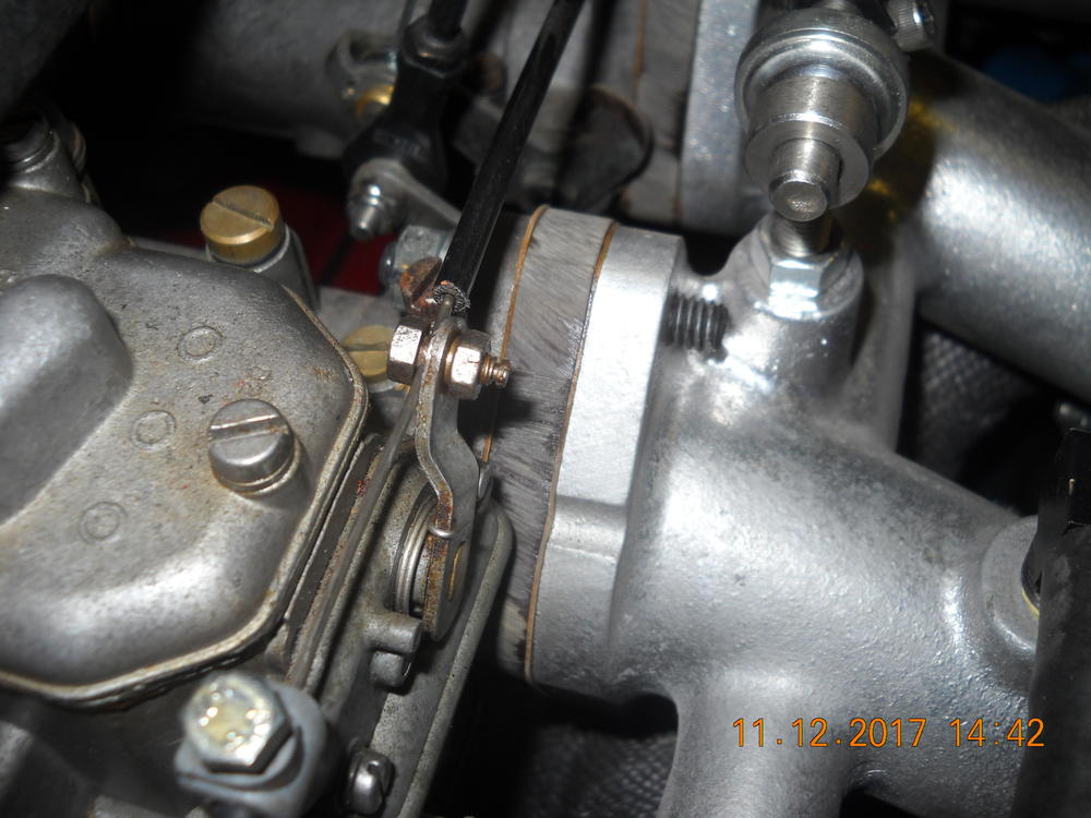

November 13, 20177 yr Author comment_534693 so, after 3 orders from amazon i finally got a FLAT sheet of phenolic resin (24" x 24" x 3/8" thick) that i used to make insulators between the carbs and manifold. i had percolation issues after driving the car and shutting it down. anyhow, i measured the temperature of the manifold and the carb where they meet. the manifold was 145 and the carb was 104. it seems that the spacers are working. i may get some more tuning done this week if the weather stays dry, but it will probably have to wait until spring Link to comment https://www.classiczcars.com/forums/topic/52787-sweatys-rebuild/?&page=29#findComment-534693 Share on other sites More sharing options...

November 19, 20177 yr Author comment_535357 took the pig for a nice drive yesterday and am happy to find that the hard, hot-start issue is gone. little throttle and it fires right up! Link to comment https://www.classiczcars.com/forums/topic/52787-sweatys-rebuild/?&page=29#findComment-535357 Share on other sites More sharing options...
