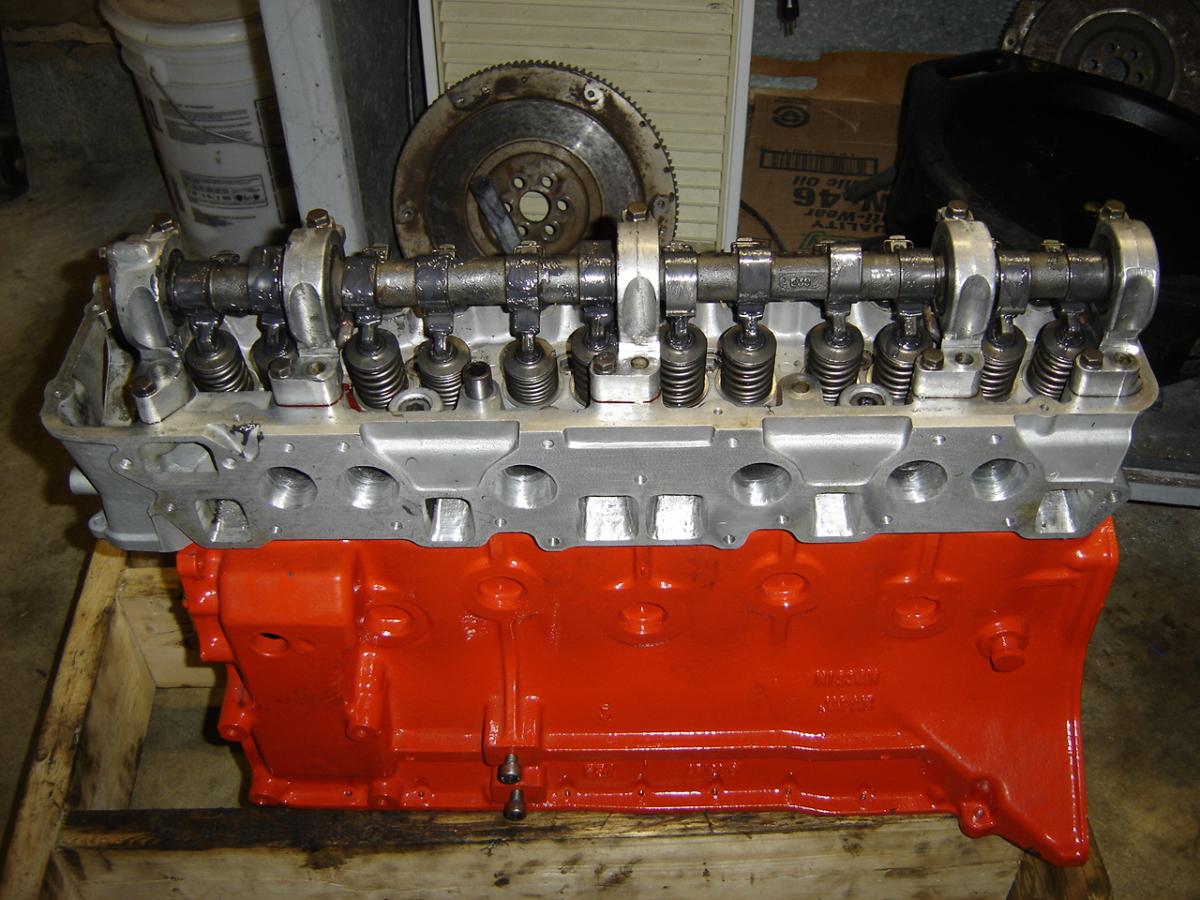

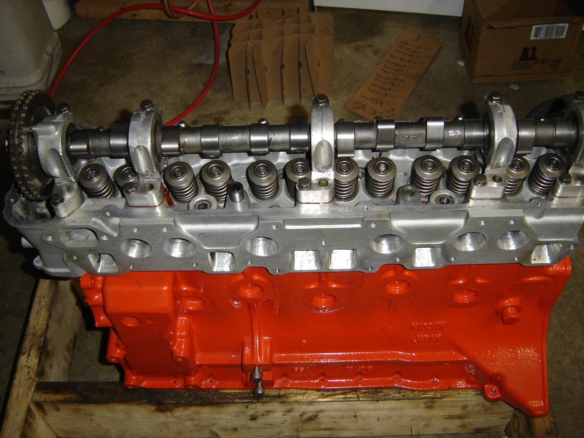

September 19, 20159 yr Author comment_477773 Done!Had to use a lash pad off the p79, thinner brought it closer to the pivot end. They're not perfect by any stretch but they look good to me for a temporary e88. Learned some things too.Happy Hour has started at my local pub (my house). Link to comment https://www.classiczcars.com/forums/topic/52405-checking-cam-wipe/?&page=2#findComment-477773 Share on other sites More sharing options...
September 20, 20159 yr Author comment_477785 Learned to put the head on a block on a cart with wheels. Link to comment https://www.classiczcars.com/forums/topic/52405-checking-cam-wipe/?&page=2#findComment-477785 Share on other sites More sharing options...
