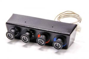

Just ordered a Vintage Air Gen II mini rotary control pod to actívate a Gen II mini evaporator and Sanden 508 Compressor:
http://www.summitracing.com/int/parts/vta-49200-rha/overview/
I would like to know the following:
1. Where exactly is the best location to install this control pod under the dash?
2. How do i install it? It seems its made of plastic so i must fine a way to secure it to the plastic dashboard also.
Anyone has done this installation?

I really do not want to deal with opening any holes or damaging the heater control panel. I just want to find the best location and way to install the following pod controls:
http://www.summitrac...0-rha/overview/
Please advise!!!

to be specific i want to know if i can keep the original heater control panel and heater box, leaving it intact and install the vintage air gen ii mini evaporator which will be operated with the above pictured controls.
There is no room under the dash to have both the original "heater box" and the Gen II mini. Either or. I'm assuming you mean "heater box" both the box that contains the heater core (dash center) and the fan/blower assembly on the right side of that.

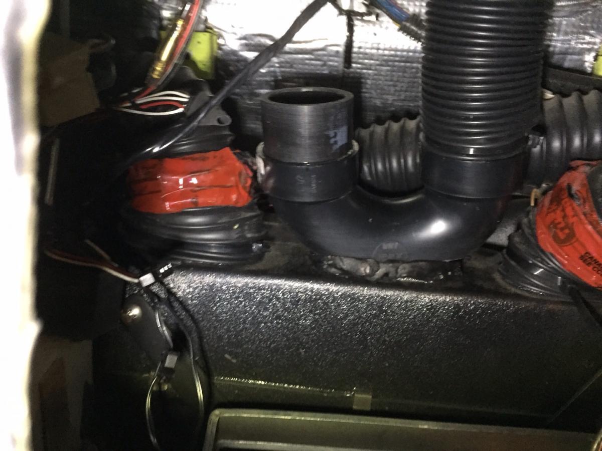

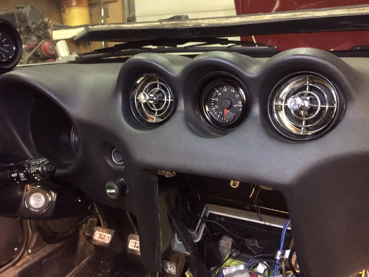

Perhaps I will take this opportunity to blow your mind on what the "right way" to use the Gen II system huge cold air output might look like! ;)
post-11371-0-05038000-1441891417_thumb.j
and how those two eyeballs get air from the center Gen II outlet.
