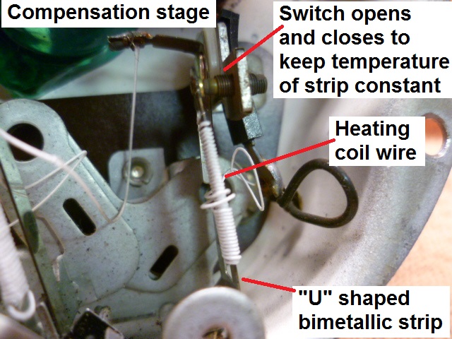

May 5, 20213 yr comment_621104 Excellent work. So I measured the loose fuel gauge I have here and I get about 50 Ohms. There are several possibilities to explain the difference... 1) You measured it wrong 2) I measured it wrong 3) They dramatically changed the design between your 73 and the later 280's (I think my test gauge is from 78) 4) Your voltage regulator switch is dirty and has way more resistance that it should Of all those possibilities, I consider #4 to be the most likely. Especially in light of your result backfeeding the gauge. So I'd try pulling a narrow strip of printer paper through the switch contacts and see what happens. This is a 280 gauge, but the switch should look something like this: Link to comment https://www.classiczcars.com/forums/topic/52170-fuel-gauge-issues-73-240z/?&page=3#findComment-621104 Share on other sites More sharing options...

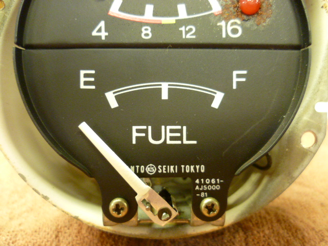

May 5, 20213 yr comment_621120 1 hour ago, JDziark said: I wondered if the regulator switch was like a set of points. Imagine how many times that switch turned on and off over the last almost 50 years! Yes, the regulator switch is similar to a set of points. It doesn't open and close as quickly, and it doesn't handle nearly as much current, but yeah... It's opened and closed an untold number of times over the past 50 years! So that pic I posted is from the front of a 280 gauge with the faceplate removed. On the 280, the faceplate for the fuel/volt is split down the middle and you can take either half off. Two screws and half the faceplate comes out. Here's a pic of the gauge with the plate intact. Take out the two small screws at the bottom and the "VOLT" faceplate comes off revealing the guts insde. Be careful and gentle and make sure you don't bend the needle. Don't know if the 240 is the same, but the 280 looks like this: If SteveJ works up a video, that would be fantastic. Link to comment https://www.classiczcars.com/forums/topic/52170-fuel-gauge-issues-73-240z/?&page=3#findComment-621120 Share on other sites More sharing options...
