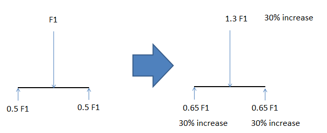

June 5, 20187 yr comment_550470 A comment on using only water. The pressure exerted by the water in the hose pushing down on the fuel needle to open it is 33% more than gasoline (assuming density of gas is 750kg/m^3) The pressure exerted by the fuel float pushing up to close the fuel needle valve is ~ 33% more in water than in gasoline. So using water is not very inaccurate as the two forces nearly cancel each other. The key point in using water is to use the table above to get ~3.4psi of head. Edited June 5, 20187 yr by 240260280 Link to comment https://www.classiczcars.com/forums/topic/52084-setting-fuel-level-weber-dcoe/?&page=2#findComment-550470 Share on other sites More sharing options...
July 7, 20204 yr comment_602269 Quote A comment on using only water. The pressure exerted by the water in the hose pushing down on the fuel needle to open it is 33% more than gasoline (assuming density of gas is 750kg/m^3) The pressure exerted by the fuel float pushing up to close the fuel needle valve is ~ 33% more in water than in gasoline. So using water is not very inaccurate as the two forces nearly cancel each other. The key point in using water is to use the table above to get ~3.4psi of head. I am not sure that this is correct. How much the floats are submerged in either water or fuel is determined by the requirement that the buoyancy force is required to a) counteract the force on the needle valve from the head of liquid and b) support the weight of the floats. Let's assume the ball bearing in the needle valve is 1/8" diameter and the head is 4psi, then force on the needle valve from the head will be 4* pi / 8^2 / 2 or 0.05 lb. This needs to be counteracted by the buoyancy force of the floats - but remember the floats are further away from the pivot that the needle valve and therefore the buoyancy force required is lower. My very rough calculation is the centre of the floats are 4 times further away from the pivot than the needle valve. Therefore, the buoyancy force required is 0.0125 lb. The floats are about 2" diameter and let's say 1/2" width and I think they weigh 0.05 lb (20 grams). So, to displace their weight (i.e. to float), they would need to be submerged by (switching to millimetres) 19mm in water and 23.5mm in fuel. To add the extra force to keep the needle valve shut then the numbers are 23mm and 29mm. The difference of the last two figures is 6mm i.e. the fuel level needs to be 6mm higher than the water level to give the same force upwards. Obviously, these numbers are only approximate - for example I have ignored the spring in the needle valve. But, rather strangely, setting the float levels to 29mm in water would appear to be the same as setting it to 23mm in fuel i.e not very far away from Frank's 25mm. Link to comment https://www.classiczcars.com/forums/topic/52084-setting-fuel-level-weber-dcoe/?&page=2#findComment-602269 Share on other sites More sharing options...
July 7, 20204 yr comment_602278 I agree Keith Franks 25mm recommended fuel height is due to the difference of specific gravity of fuel vs water. Makes much more sense this way. Link to comment https://www.classiczcars.com/forums/topic/52084-setting-fuel-level-weber-dcoe/?&page=2#findComment-602278 Share on other sites More sharing options...
