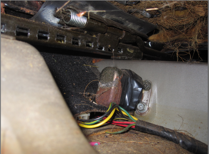

August 4, 20159 yr comment_475071 Zed Head, Water mark on the outside of the relay body? Nice! That's an interesting story if it could tell it, huh?  So if you measured 0.3A to the relay, then you're dissipating between 3 and 4 Watts inside that tiny little box. It's gonna get hot in there.  For both you guys, next chance I get, I'll take some pics of my 77 relay with the cover off. Mine went intermittent after being on and baking for however many hours it took to accumulate just under 100K miles on my car. IIRC, it's crispy... I think that's normal relay pull isn't it.  The EFI and fuel pump relay pull the same?  Here's a picture.  At the time, I was in "just make it work" mode so didn't even look inside the relay.  I'd forgotten how bad it looked.  Definitely on the fix list now.  I think that the electrical tape is there to hold my fuel pump power circuit tap line in place.  After I had the car a little while and started parking it outside I found that it had a pretty serious leak through the windshield seal.  It probably sat outside and filled with water before I got it.  Had a hole under the driver's seat also. Link to comment https://www.classiczcars.com/forums/topic/51963-internally-regulated-alternator-trivia-bootstrap-current/?&page=3#findComment-475071 Share on other sites More sharing options...

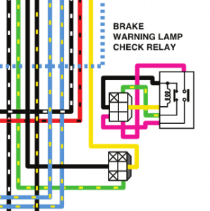

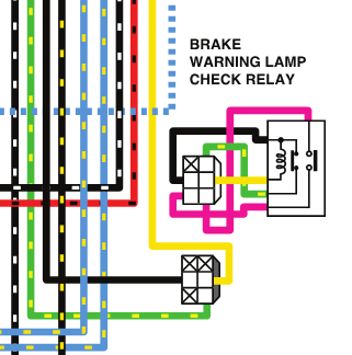

August 4, 20159 yr comment_475112 If I read this diagram right, two of the pins on the BWLCR aren't even used and a simple normally closed relay could replace it. Â Looks it might even be a two way relay, maybe the same one is used in 78, just wired NO instead of NC. Â I'd take it out and look but seat removal is required, and we'll be up in the 80's today. Â Â A common Bosch relay. Â I can get my current draw back down and cool things off. Â Might keep the old rusty one there though, just for the history. Â Â Â Link to comment https://www.classiczcars.com/forums/topic/51963-internally-regulated-alternator-trivia-bootstrap-current/?&page=3#findComment-475112 Share on other sites More sharing options...
August 5, 20159 yr Author comment_475146 Yup. You're reading it right. There are both NO and NC contacts in the 76 relay, but only the NC contacts are used. With the way you have your relay connected, you could replace it using the NC contacts inside pretty much any SPDT relay that is designed to run on 12V. In 77 they used the exact same normally closed scheme, but they changed the relay. The way I know that is the number of contacts in the connector going to the relay. Your 76 has six positions. Five of which are populated on the relay side and three that are populated on the harness side. The 77 has four positions in the connector with three populated on both sides. And I wouldn't worry to much about your fuel pump relay, even if you are overdriving the brake check relay some, I bet the fuel pump still draws way more than the relay. In other words, I bet the fuel pump draws the lion's share of the current and the brake check relay is a drop in the bucket compared to the total. I also wouldn't worry too much about the brake check relay either. If it eventually decides it doesn't like the current any more, it will just go open circuit on the coil side. You'll know it has happened because your brake warning lamp will stay lit and won't go out like it's supposed to. At that point, reach under the seat and pull the connector off the brake relay and the lamp should go out. Link to comment https://www.classiczcars.com/forums/topic/51963-internally-regulated-alternator-trivia-bootstrap-current/?&page=3#findComment-475146 Share on other sites More sharing options...
