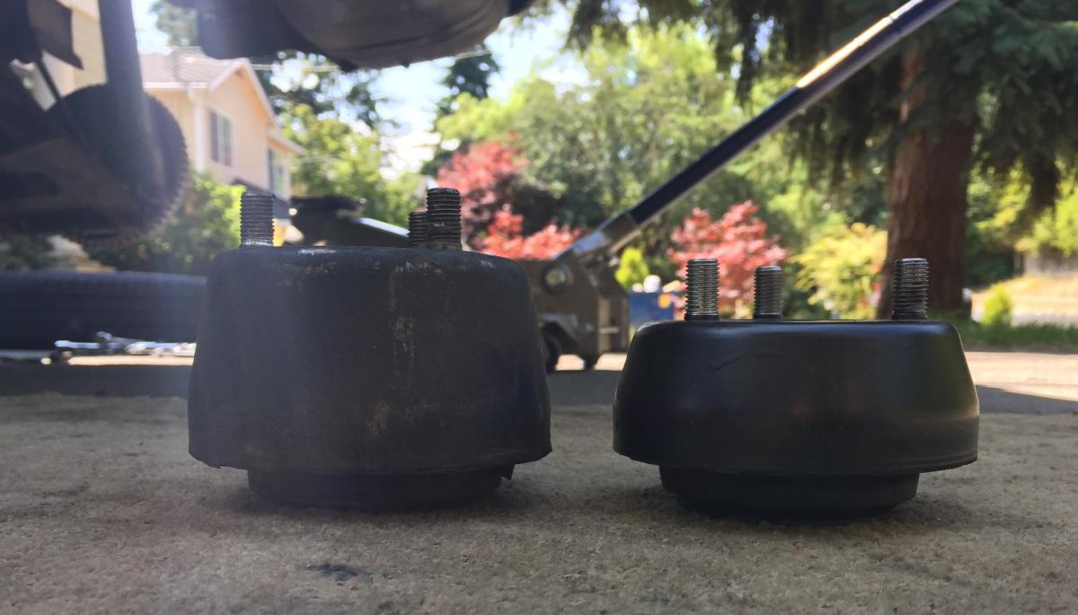

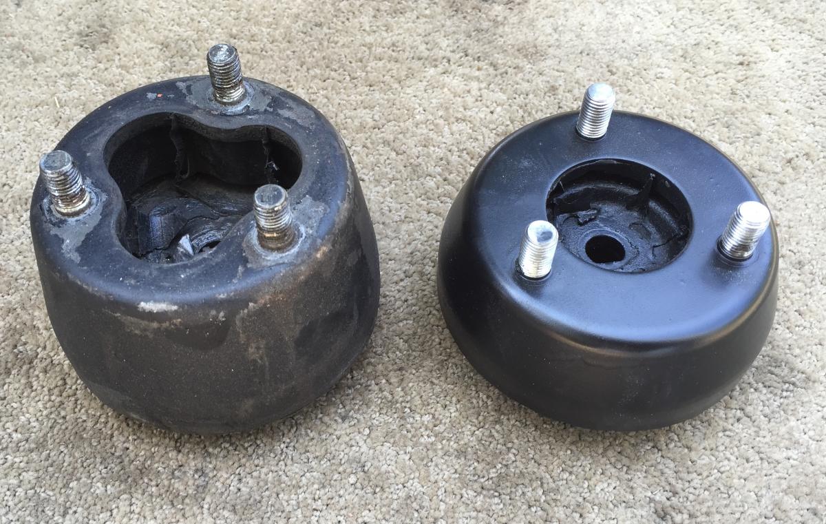

280 isolator on the left, shorter 240 on the right
post-28907-0-55459900-1437104324_thumb.jpost-28907-0-96655200-1437104332_thumb.j

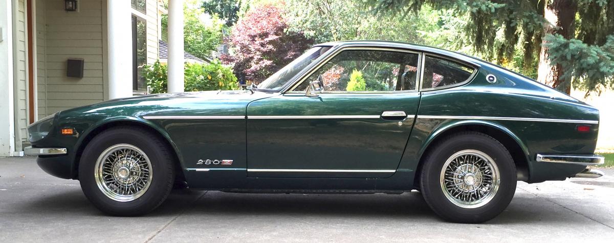

before:
post-28907-0-40287000-1437104352_thumb.j

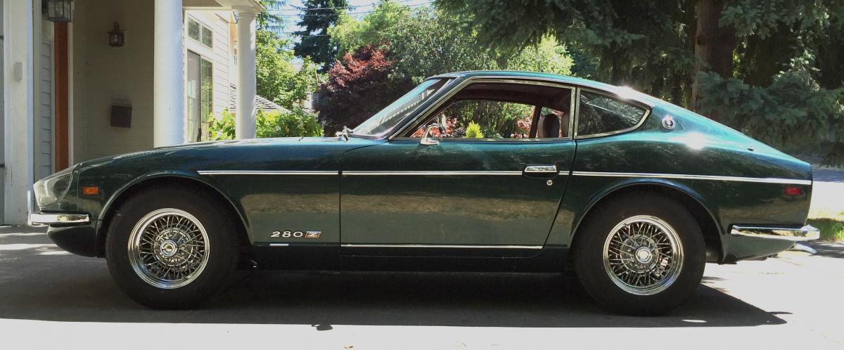

after:
post-28907-0-05639200-1437104341_thumb.j

Nice subtle change, I like the new stance.  Mine sits about 1/2" lower in the rear when measuring the distance from ground up to the underside of the fender lip at center.  With this set up the body line near your body side molding is quite parallel with the ground.

And rossiz that is an excellent write-up. And you're right about the stance...it's just enough to forget that it was a little high.
