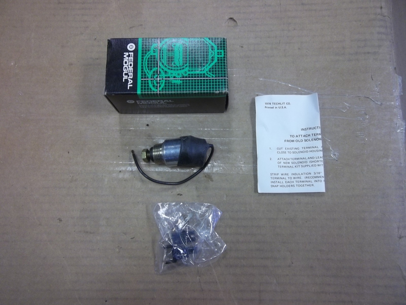

GM made idle Stop solenoid on most of their carburated cars through out the 1970's and 1980's. They are adjustable and ideal for using as an AC idler " kicker ". They extend when +12v is supplied and collapse when power is removed. Fabricate a bracket and just splice a wire from your Compressor clutch power wire ( Blue wire ) and you're good to go. Much easier and more reliable than the Vacuum nonsense.
Plentiful at Auto wreckers and cheap from most Auto Supplier. Here's just one I found on E-Bay. $24.75 :
http://www.ebay.com/itm/Federal-Mogul-Carburetor-Idle-Stop-Dashpot-Solenoid-213-267-Chevrolet-GMC-/291501541853?hash=item43ded889dd&vxp=mtr

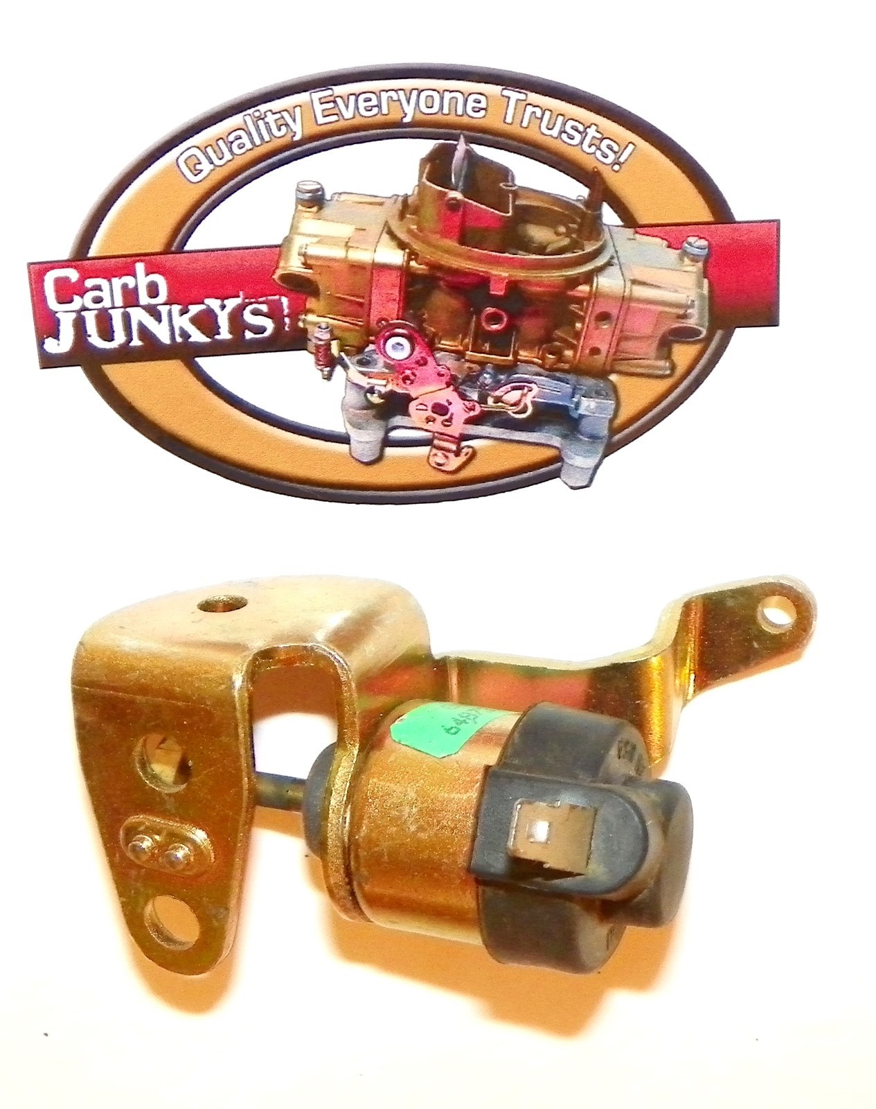

The $19.95 USD solenoid from Carb Junky's should work fine. You'll have to fabricate a mounting bracket. Browse these pages:
http://www.ebay.com/itm/Idle-Stop-Solenoid-Rochester-Quadrajet-Carburetor-75-83-Buick-Chev-GMC-Pont-Olds-/331272717308?hash=item4d216483fc&vxp=mtr
