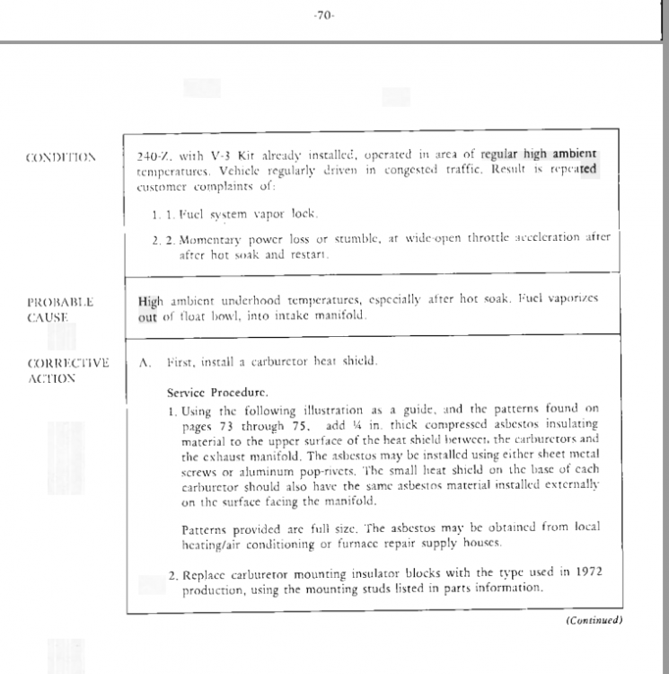

Darn it, the site is dumping on me.  Edit and Reply function getting all tied up.  I'll just post a picture and a link.
Fuel 1973.... file
Write the text and now a the file I attached earlier that had disappeared is back.  The site is saving some weird stuff.
this is magic!! THis is exactly what my car has!! The same Vapor lock problem!! Where do i get a copy ot this manual? Does it still applies to a 1972 240z?

I think that he might have been talking about this post.  Click on the "S30 Manuals..." and it will take you to another page,   Then click on "Download this file", then click on "Fuel-1973...".  It should apply to 1972 also.  Heat is heat.  Lots of good information in there.
