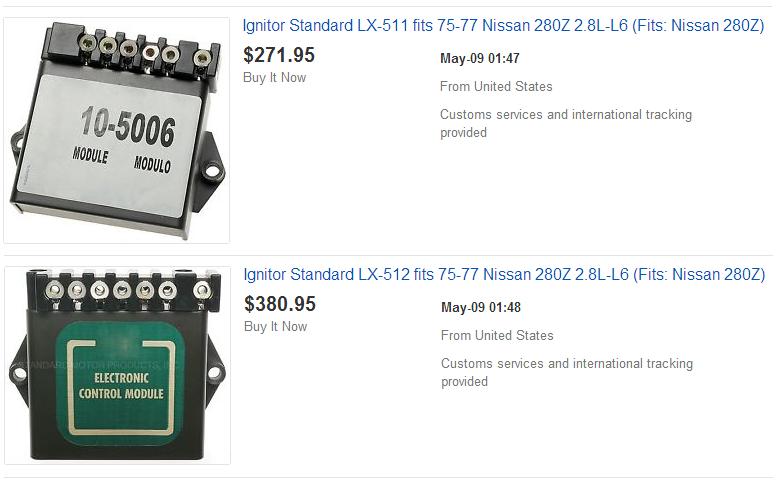

Edit: Found these two on E-bay. Not cheap, but it is plug and play so to speak.
http://www.ebay.com/itm/Ignitor-Standard-LX-512-fits-75-77-Nissan-280Z-2-8L-L6-/151675480353?fits=Make%3ANissan%7CModel%3A280Z&hash=item2350902921&vxp=mtr
http://www.ebay.com/itm/Ignitor-Standard-LX-511-fits-75-77-Nissan-280Z-2-8L-L6-/161699689867?fits=Make%3ANissan%7CModel%3A280Z&hash=item25a60d758b&vxp=mtr
The LX-511 is basically the Californian model for the 76-77 280Z
The LX-512 is the FED model for the 76-77 280Z with the dual pickup.

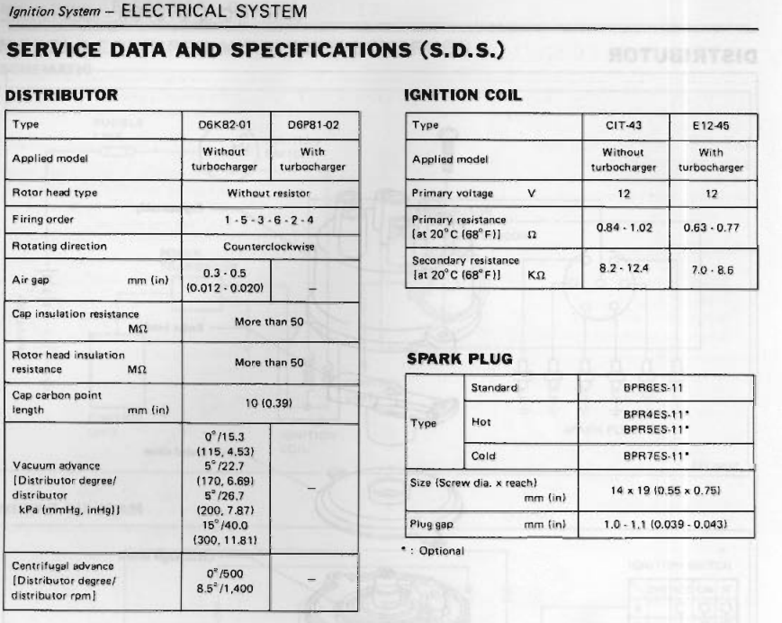

I only started this for Tomohawk's question about a direct module swap.  It's interesting though how fast the technology changed.  From 74, with the big box under the dash, to 79 with the matchbox on the distributor, then to ECU timing and dwell control in 81 with the turbo engines.
I've always wondered about the timing curves for ECU control.  Not so easy to figure out what the ECU is doing, and no specs. published like with the distributor control.
Nissan doesn't even try to explain it, they just leave it unknown.

You are right about Nissan not giving any details on the leter units they seem to have changes the way of informing technicians and choosing the Test and Replace black box method.
