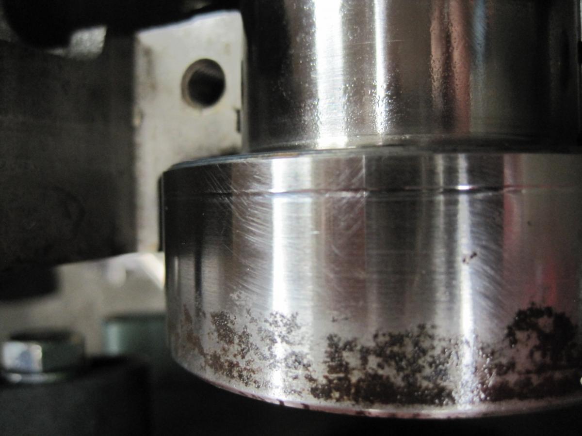

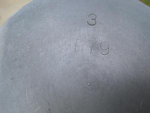

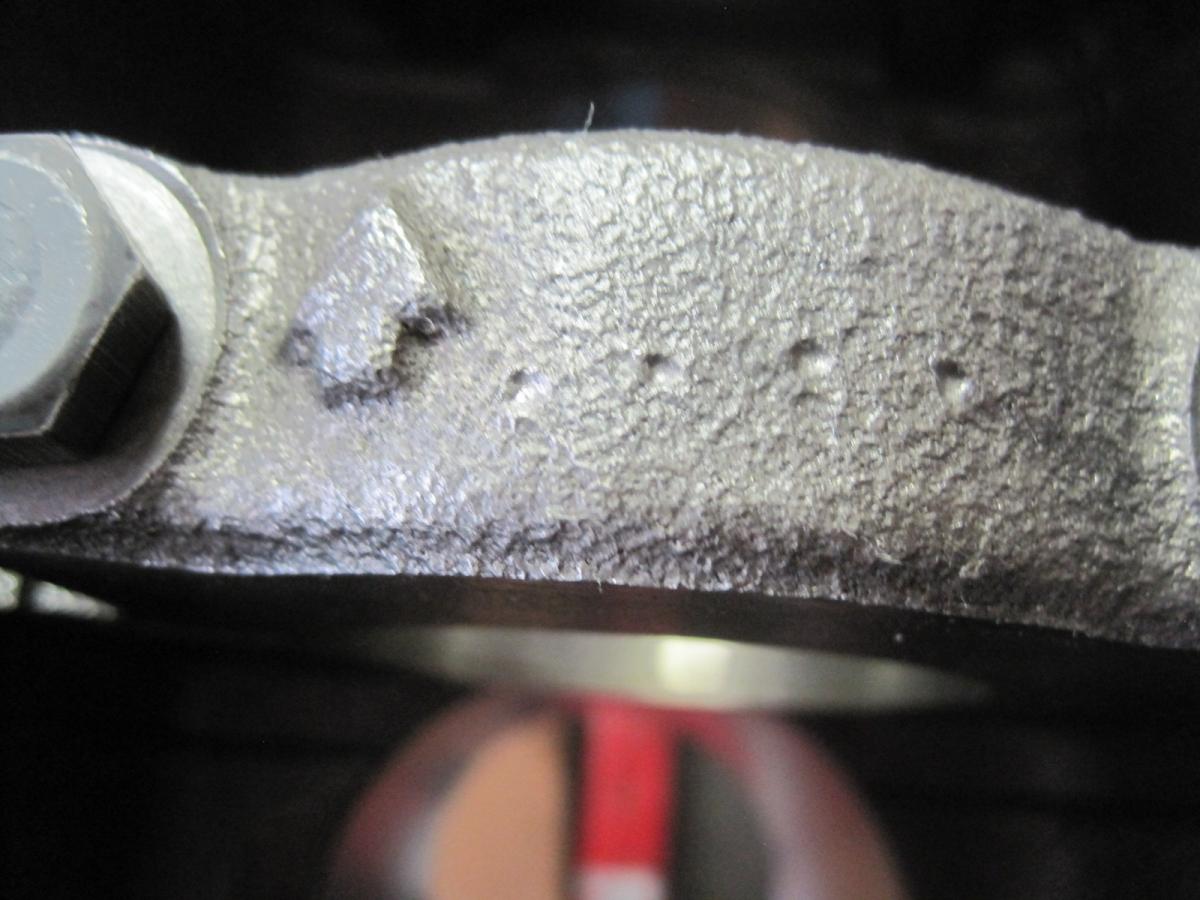

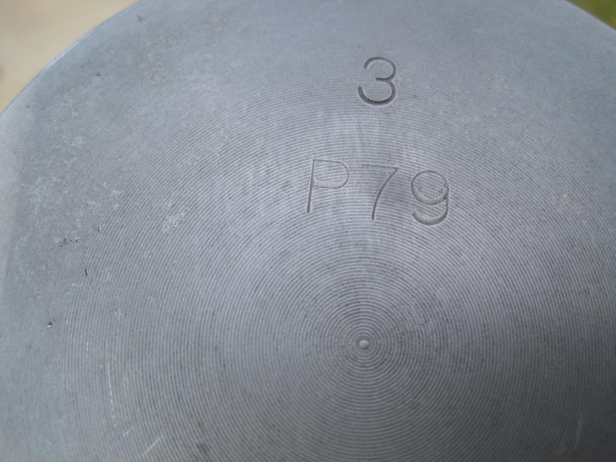

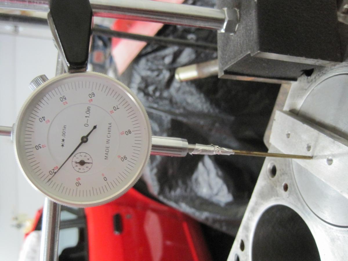

May 13, 201510 yr Author comment_469743 Here's some more pics of the project, mostly of the L-28 that supposedly only had 100k. The cylinders looked great as I said, but a good amount of rust on the crank around the flywheel end. A very strong groove in the seal area that I think might be an issue. The issue being that the amount of surface rust across the whole surface doesn't allow for moving the seal much to avoid the groove. I think I will be installing a speedy sleeve on there. Also interesting to me that the pistons all were labeled P79, I wasn't aware that Nissan did that. Am I assuming too much? Also asking(which makes me wonder if this engine was not touched) is the markings on the main bearings a normal numbering system? The machine shop said the block was straight across the top and I decided to reassemble the block with one piston to check deck height. Well it seems the rumors are true- about .019 above the deck. I guess I will be taking the block back to get shaved!! Link to comment https://www.classiczcars.com/forums/topic/51459-l28maxima47-build/#findComment-469743 Share on other sites More sharing options...
