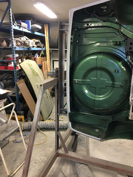

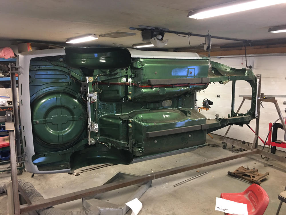

wheee! Posted November 22, 2017 Author Share #1621 Posted November 22, 2017 It is a huge benefit having the rotisserie in the shop! 1 Link to comment Share on other sites More sharing options...

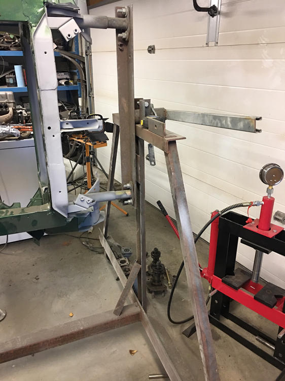

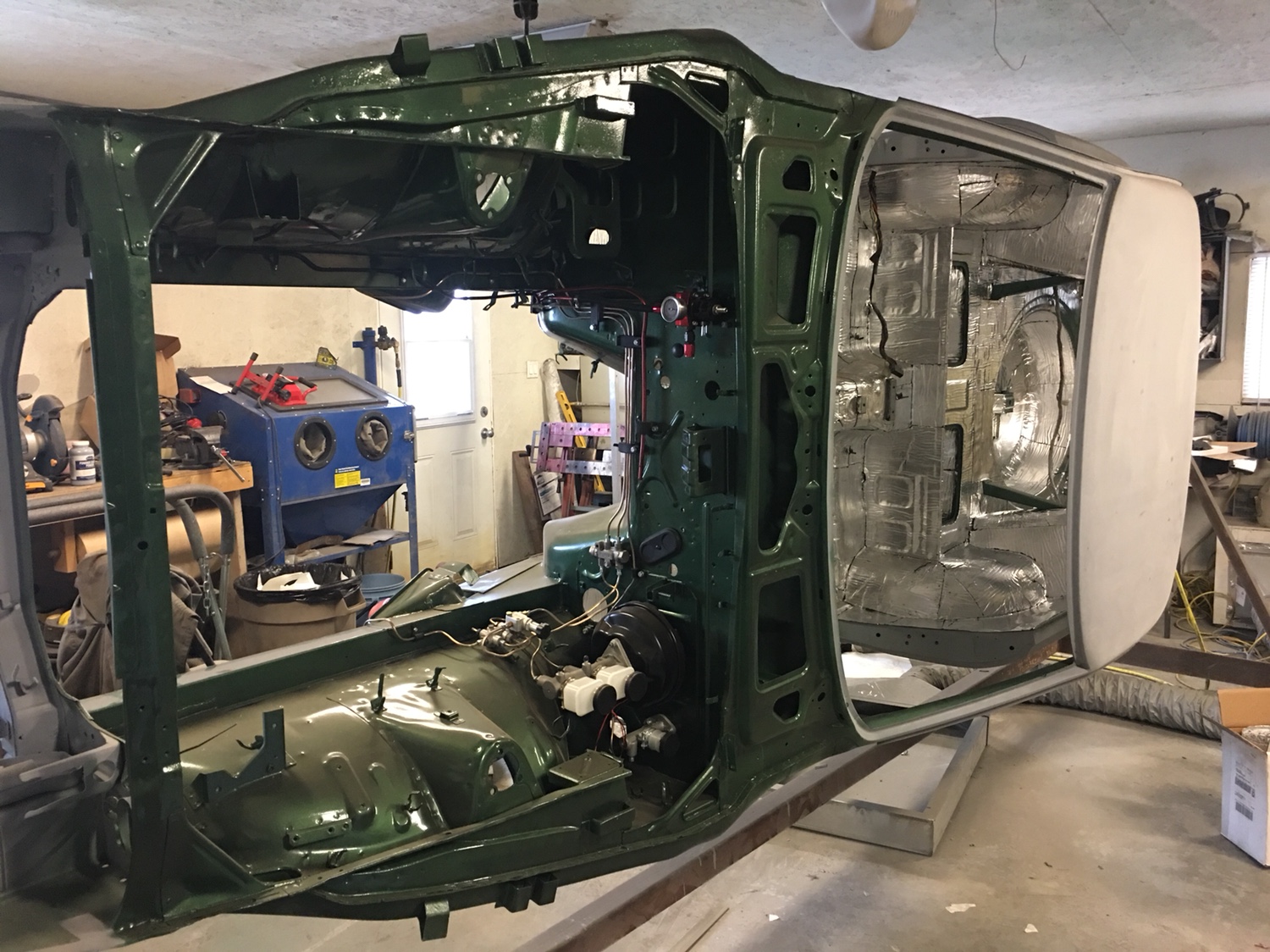

pclements Posted November 22, 2017 Share #1624 Posted November 22, 2017 I am getting ready to build a rotisserie may I ask on your rotisserie what the distance is from the top of your horizontal front/rear to the lower side of the pivot? Are you using the bumper mounts at both ends? Any drop from the pivot or just straight? Thank you Link to comment Share on other sites More sharing options...
wheee! Posted November 23, 2017 Author Share #1625 Posted November 23, 2017 This is a dead simple rotisserie. No drop or balance, just a welded angle iron beast bolted to the bumper mounts. Front is bolted to the 76 shock mounts and the rear is bolted to the bottom valance bumper mounts as used by the 240’s. I welded in the openings from the rear bumper shock mounts. I will get some measurements for you. Link to comment Share on other sites More sharing options...

wheee! Posted November 23, 2017 Author Share #1628 Posted November 23, 2017 I am getting ready to build a rotisserie may I ask on your rotisserie what the distance is from the top of your horizontal front/rear to the lower side of the pivot? Are you using the bumper mounts at both ends? Any drop from the pivot or just straight? Thank you 50” from floor to pivot point. The ceiling is only 8’ so it’s tight. But it works! Link to comment Share on other sites More sharing options...

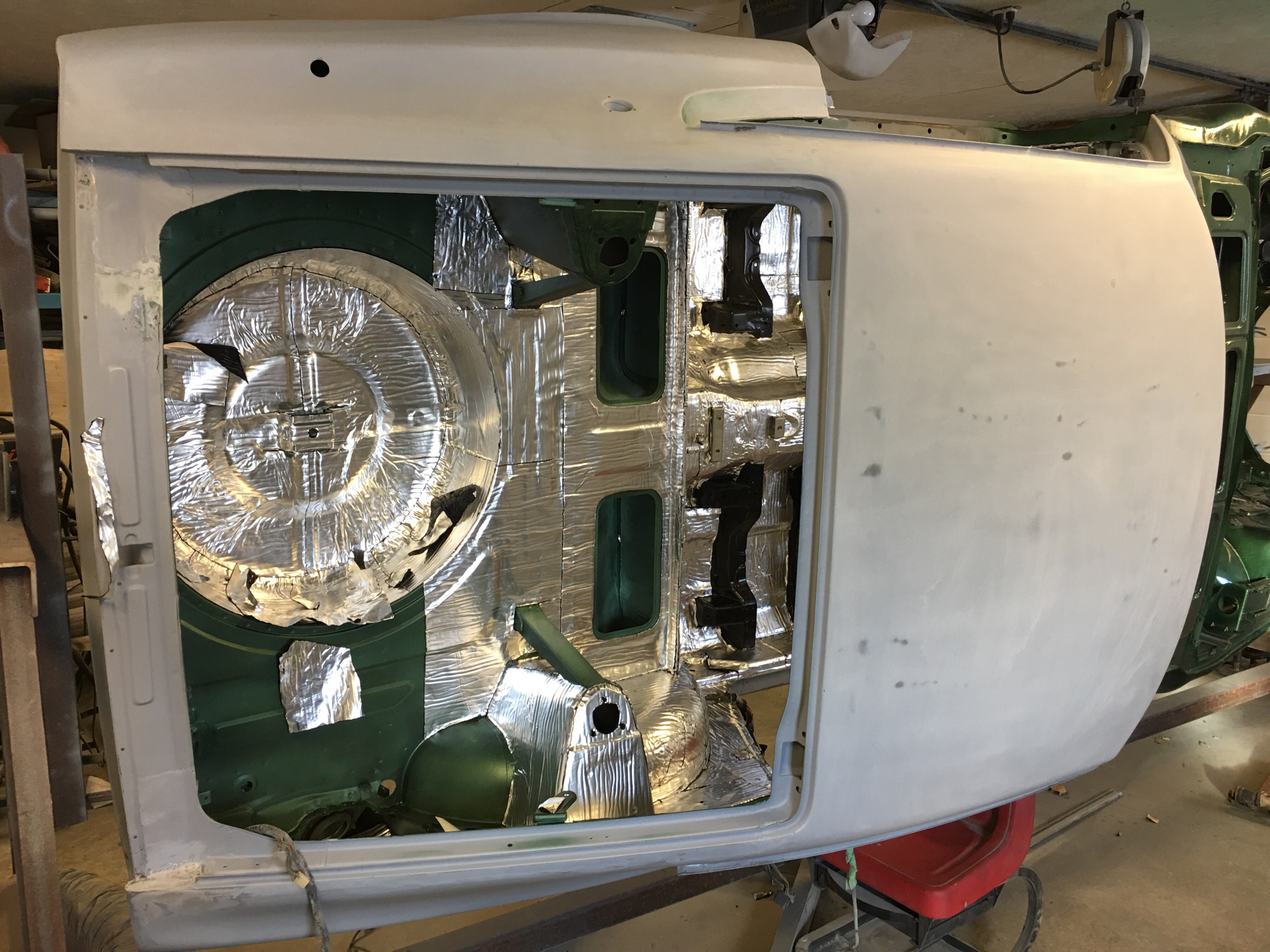

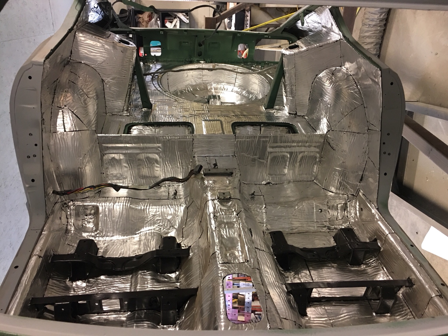

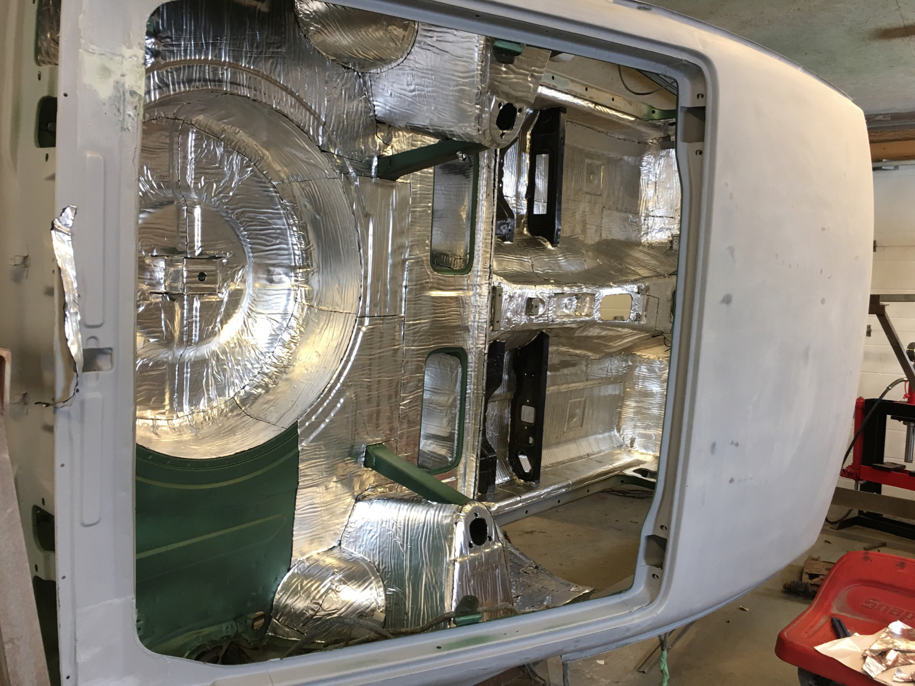

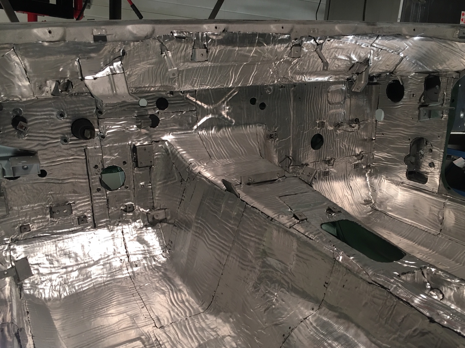

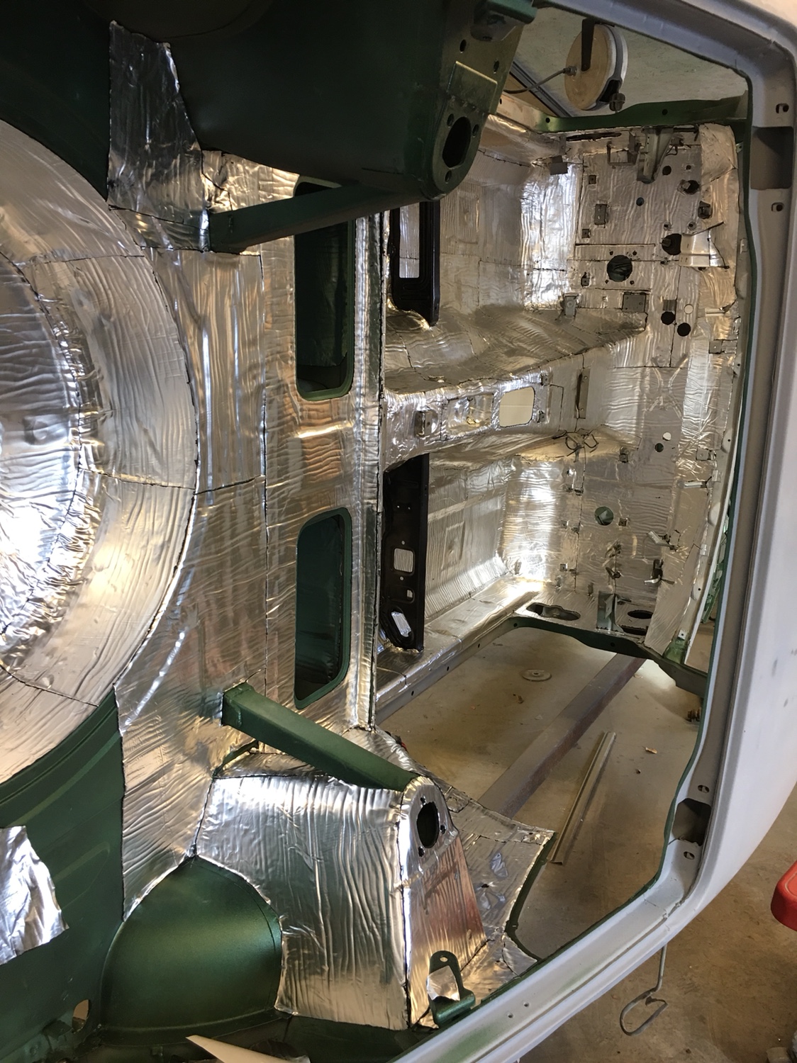

wheee! Posted November 23, 2017 Author Share #1629 Posted November 23, 2017 Sound mat complete! 1 Link to comment Share on other sites More sharing options...
pclements Posted November 23, 2017 Share #1630 Posted November 23, 2017 Thank you very much for those measurements. Your work is a inspiration for me and my 72. Again thank you. Link to comment Share on other sites More sharing options...
