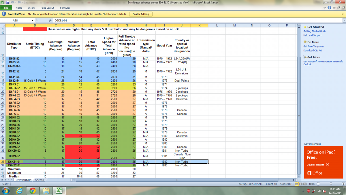

According to this spread sheet you have a '82 non turbo distributor.  Does it have the E12-80 module or the 92 with 2 plugs?

I have the two plugs.
