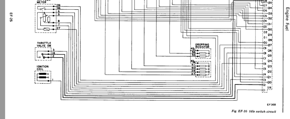

November 3, 20231 yr comment_659010 Pin 1, injector control, is also on that blue wire. I had found that with the stock ignition module my engine would not run when the tachometer was disconnected. But, after the GM HEI modification it would run without the tach. So, Pin 1 seems to be sensitive to whatever comes through that blue wire. At least it was on my 76 and a 78 parts car that I had. I had the 78 running well, and tried to start ito once with the tach out and it was dead. And later, after messing with the resistor on the 76 it fell out after a drive and the engine wouldn't start. Saw it laying on the passenger floor, put it back on, and back to normal. No idea why it worked with the HEI module though. You might try branching the circuit before the big resistor. One to the tach, one to Pin 1. Or, for an experiment, go back to the non-functional tach setup, low resistance, and see if it still breaks up.  Link to comment https://www.classiczcars.com/forums/topic/49588-fitting-a-hei-module-in-transistor-ignition-unit-1977-280z/?&page=15#findComment-659010 Share on other sites More sharing options...
November 3, 20231 yr comment_659022 Thank you @SteveJ @Zed Head With the heat sink, I found posts that said a fin had to be cut off the sink for the GM module to fit, and that the aluminum used was extremely soft. The other factor is that the Bosch one has a polished contact area, so no loss of surface area contact as with an unfinished surface. I'll consider replacing it if I seem to have a ongoing issue. Today, there was nary a hiccup. However, traffic was heavier & I did not have an open road to push the car harder. I'll have to check it further. With my 75, the engine started with or without the resistor in line, with the stock ignition and with the HEI, so I can only assume the harness bridge is not after the resistor on mine.  Link to comment https://www.classiczcars.com/forums/topic/49588-fitting-a-hei-module-in-transistor-ignition-unit-1977-280z/?&page=15#findComment-659022 Share on other sites More sharing options...
