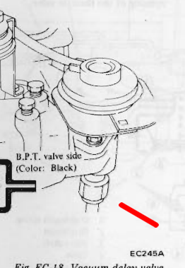

April 22, 201411 yr comment_446336 I was just reviewing this and thought it would be worth mentioning that the EGR system shouldn't engage until the car is up to full temp so its consistent with your symptoms. ZedHead is on to something there worth checking. Link to comment https://www.classiczcars.com/forums/topic/49061-hanging-rpm/?&page=4#findComment-446336 Share on other sites More sharing options...
April 22, 201411 yr Author comment_446347 That's a good point, Kurby. I think I'll buy an egr block off plate and rule that out entirely then. I haven't had a chance to look at it any this week and won't until the weekend most likely. Link to comment https://www.classiczcars.com/forums/topic/49061-hanging-rpm/?&page=4#findComment-446347 Share on other sites More sharing options...
April 22, 201411 yr comment_446348 Just to be clear, you might need to seal the bottom tube also, to be sure. There are two passages in the manifold itself, the valve on top controls the flow between them. The plate will seal the passage but if the wall between has holes, it won't matter. You'll see how it works when you take the valve off the top. Look inside and you might see some damage. Just an improbable possibility. Link to comment https://www.classiczcars.com/forums/topic/49061-hanging-rpm/?&page=4#findComment-446348 Share on other sites More sharing options...
