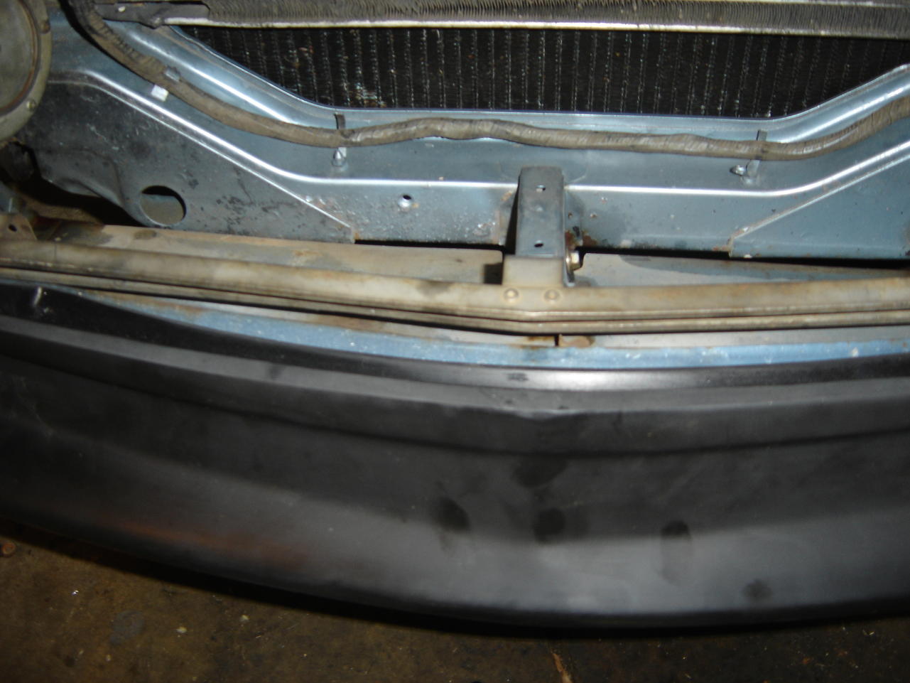

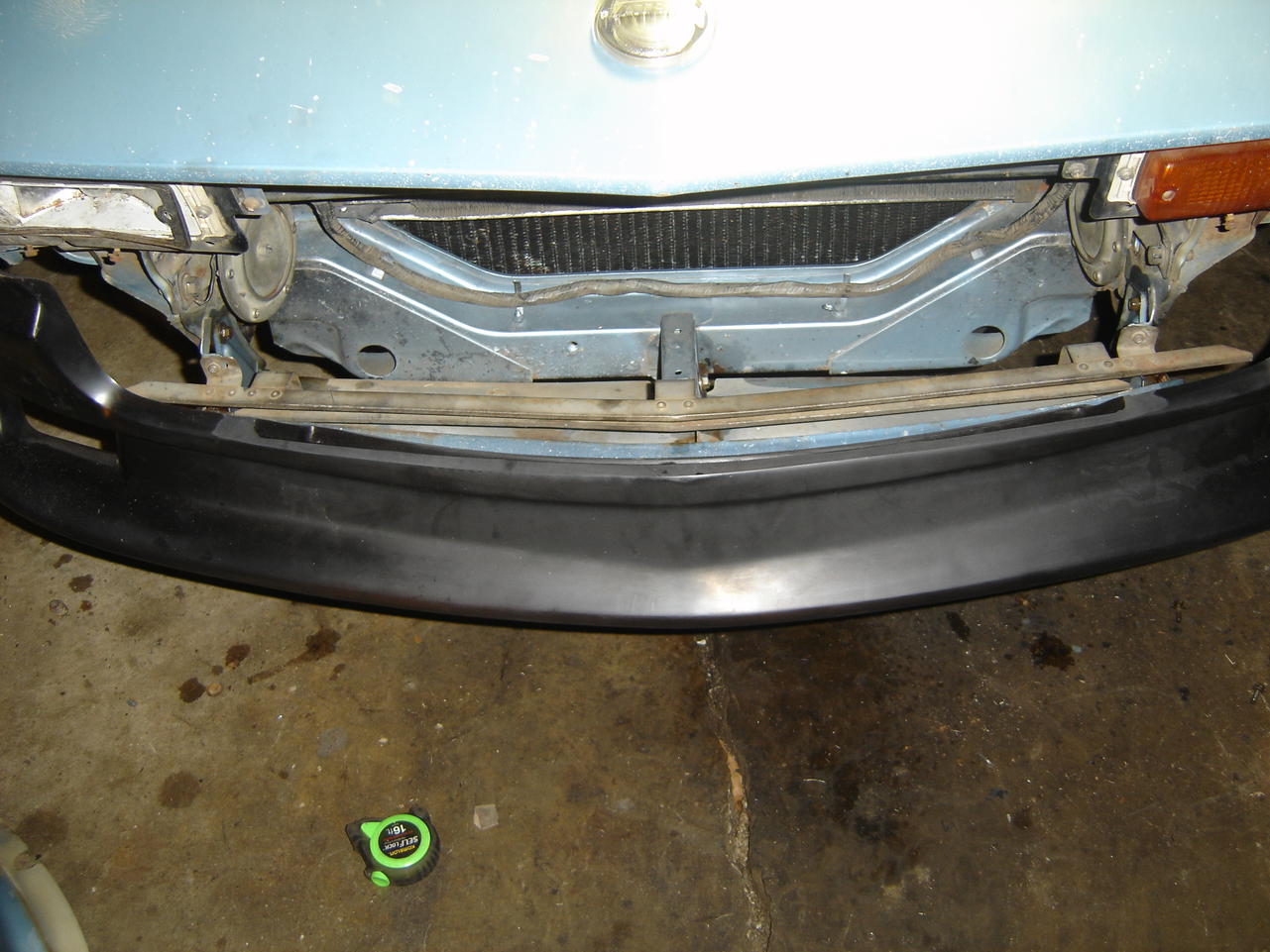

I bought this from JEGS for $167, Xenon #3125. Took about 4 hours to put it on, I had already removed the front bumper and half of a finger nail a couple of weeks ago. The instructions were as clear as mud so I thought I might make it simple for the 9/74 to '78 one.

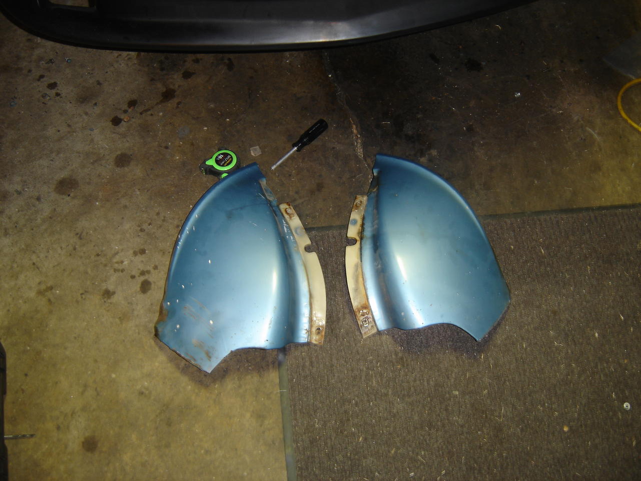

The instructions say remove the body pan? You only need to remove the 2 small 1/4 panels under the headlight buckets.

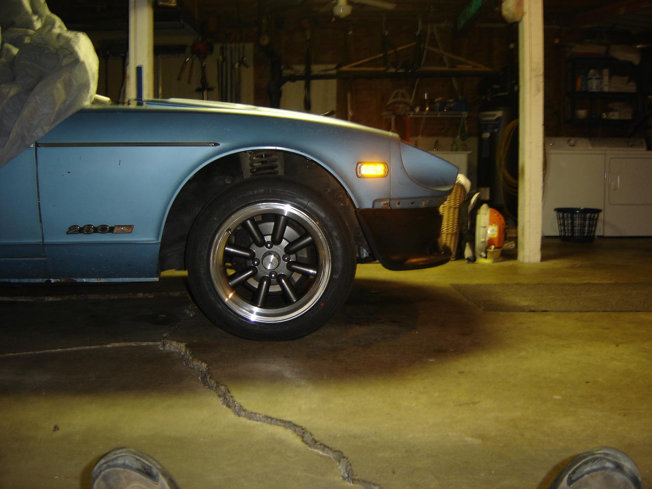

If you leave the middle skid pan it gives it something to rest on. Though it's not secure and could vibrate I'll end up putting a bolt or screw or something when I drive it again.
Squirt the bolts and nuts a day before you start.
I used the bottom of the turn signals as a reference for measuring down in the middle.
I buggered the holes out a little, a little adjustment before tightening down.

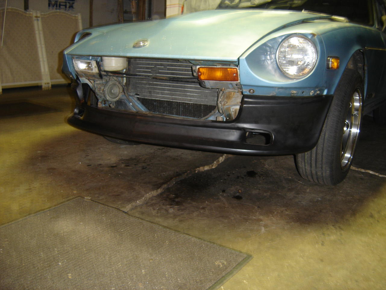

It turned out good, I'm happy with the look for now, fiberglass bumper is next!
