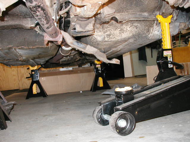

post-4287-14150827470735_thumb.jpgThanks John. I dug up my pictures from 12 years ago when I had it on jack stands. Is that the right place where my jack stand is in the picture or the very outside rear corner of the "tubbed out area just to the right of the jack stand?
Here's the detail from the General section of the FSM: "Front supportable points for stand are both front side members. Rear supportable points are both side of front differential mounting cross member." Photos show stands at the front box member where it tapers to smallest height (at the floor pan). Stands at the rear are pictured at the box member running across the car - just ahead of where your stand is located in the pic.
