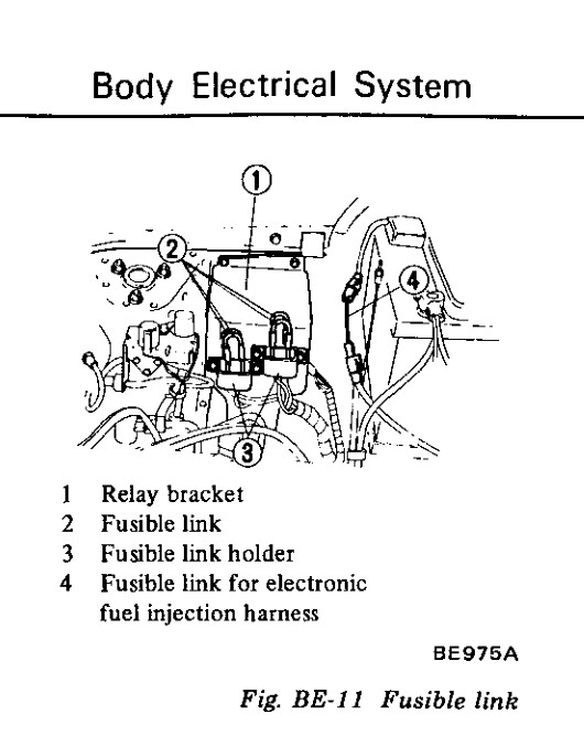

Check the fusible links. One of them is for the headlights but may also power the running lights.
Or, if you have a voltmeter, check for power at the fusebox at the headlight fuse. If you have power at the fusebox then your combo switch is working but the dimmer switch might have problems (not grounding). If you don't have power at the fusebox, then check for power at the fusible link. It might still have a label on the side that says "HL".
I checked them and they are getting power. Just to make sure those are the fuses under the glove box? Someone told me their is another set of fuses under the hood somewhere
You probably can't see this from your phone. They're under the hood.
The other set of fuses would be the fusible links (or fuses if someone did a maxi-fuse swap).
the fusible links are getting power to
