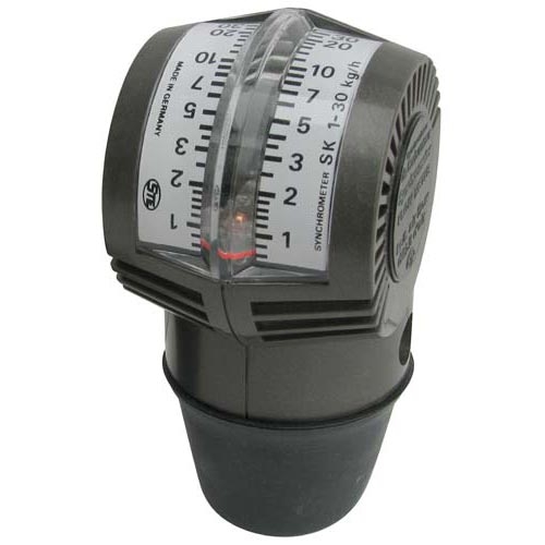

I have weber DVG carbs on my 260z. Not a bad idea making your own meter and I would support you making your own out of sheer coolness. I dont have that kind of time though and found a guy on ebay with a pair of syncrometers he used on a porsche. I picked up 2 meters for 30 bucks, then bought the weber adapters for another 30. technically you only need one meter but it was easier to do with a matched pair. The meters are pretty generic too so with different adapters you can use them on almost anything, they fit round mouthed carbs without adapters. I might be spouting BS here but I have only needed to balance the carbs after tuning them so its not very often i even need to deal with the syncrometers
