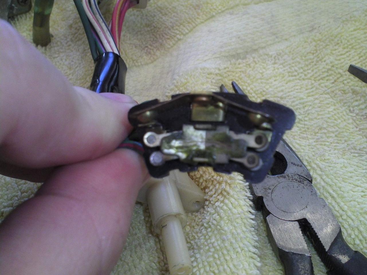

There is a good chance that when you took apart your turn signal switch, the rocker for the brake lights on the driver's side was displaced.
On the image above, it is the rocker at the top.
When you use your turn signal, the switch pushes the rocker away from the contact so that the rear light is part of the turn signal circuit instead of the brake light circuit. If the rocker does not resume contact, the light will not illuminate with the brakes.
I hope this helps.
