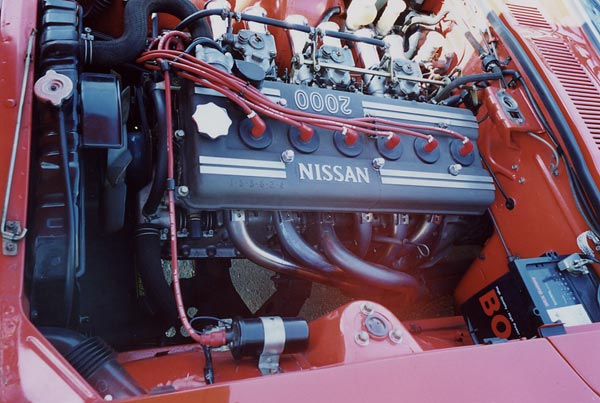

I'm still in the process of looking for a Z to buy. I found this 73' 240z with the Japanese 2.0 dohc engine. Excuse my ignorance but is this a good find? The first time I test drove it I fell in love with it. The car is in decent condition. There's a little bit of rust right above the hatch...and other than that I couldn't find anythign else. Now, both door handles are broken and the gauges don't light up inside. I know all of this is vague but I can't think of anymore. I'd like your guys opinions on what I should do, and if you think the repairs for this car will cost a lot? The price that the guy is asking is $1695 usd. If you need more information, reply and I'll respond with the best of my ability. I look foward to your replies. Thanks.

Hi Chris,
Unless you have accidentally hit the jackpot and found a real Fairlady Z432 ( PS30 ), I don't think that the engine in the car will be a DOHC .
Its much more likely to be an L20 - essentially the same as the L24 but with a smaller capacity.
You didn't mention that the car was RHD, so I would assume that you are talking about a US-market "240Z" that has had an L20 engine transplanted into it. That would not be considered an upgrade by most people.
However, if it is in fact an RHD car you may well be looking at a privately-imported Japanese-market car. Many of these were brought home from Japan by American servicemen ( I've got one of these too ).
Check out the VIN number to make sure ( best place to look to make 100% sure is on the firewall metal above the brake booster - and you may have to push away some tubes and wires to see it clearly ).
We have discussed similar subjects here in the past - so use the SEARCH function ( try words like "Fairlady" or "S30" or "VIN" and you should find some interesting info ). Good luck.
Alan T.
( ps - If it says "PS30" on the VIN code then all your Christmases will have come at once ).

The 'regular' 2.0L is just an 'L' block with a (very) small bore & stroke. Externally identical to the other 6-cylinder engines of the same family.
The S20 on the other hand - twin-cam, triple mikuni's, factory extractors - I wish someone would mistake one for an L20 & sell it to me cheap....:love: :love:
