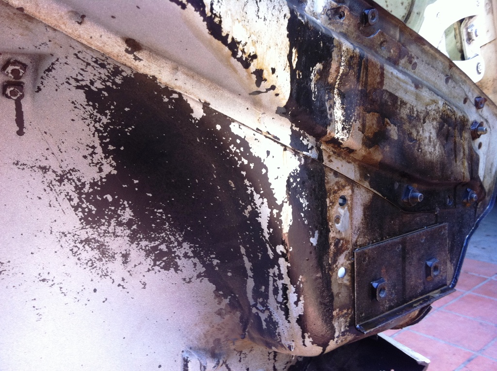

I also need advice on the finish to the underside of the fenders and wheel hub areas? It appeared to be painted white but had a black coat on it that is slowly disappearing. I was thinking of finishing in a similar colour as the rear finisher and grille (Nissan/Datsun Grey) but not sure what is the expected look in this area?

I don't like the clearcoat finish and take exception to the durability claim. I would go with a solid color finish. THe undersides of the fenders should be the same color as the car. The fender supports were not welded on to the unibody, they were bolted. I'll bet, if you look, you have the holes for those bolts and perhaps the captive nuts.

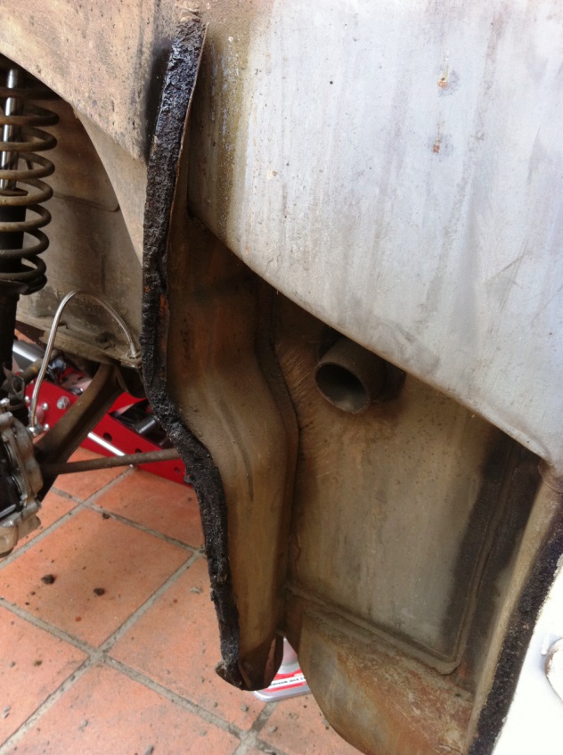

On the other point, no holes whatsoever along this rail. It is why I posted the pic. If you are referring to the fender shield then I had already unbolted and removed it for cleaning before taking the picture.

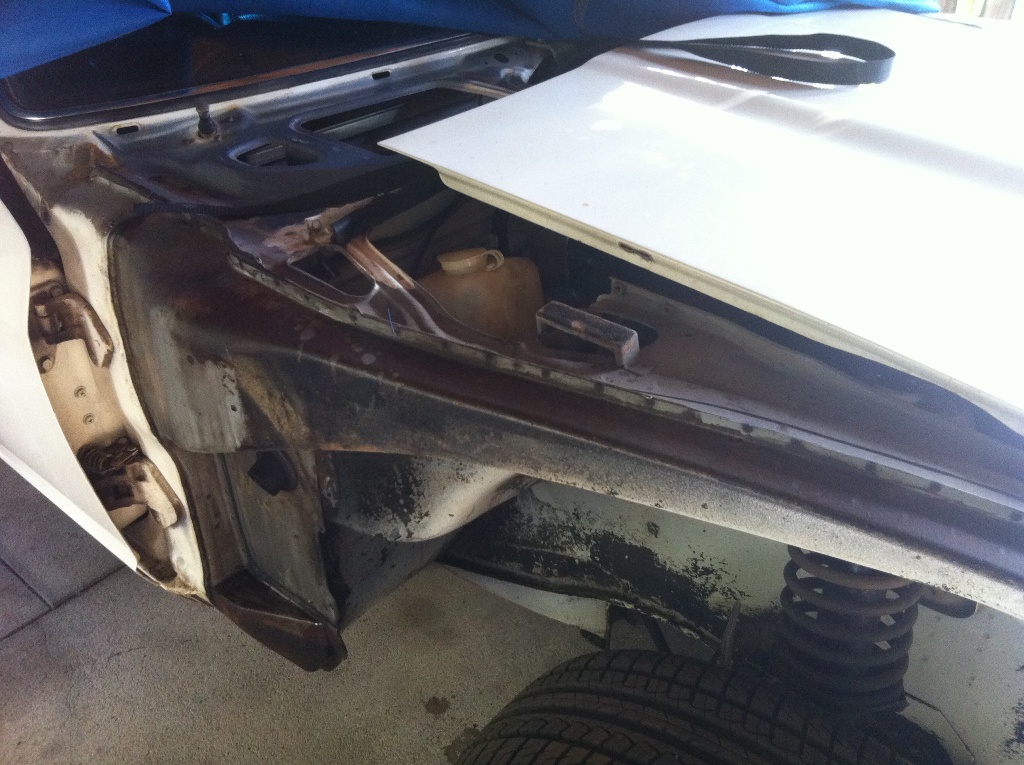

I notice on many threads that there three tabs fixed to the unibody to help support the fender (like in pic) but this does not appear to be provided on the earlier models. I am always accidentally flexing the fender when the head is over the engine.
Curious to also know the factory finish on the body behind the fender shield? It is grey on my car but not sure what it is.

Oh, now I see what you are talking about. No, early cars (at least mine) don't have the supports. Must be careful not to lean on the fenders. What's your serial number, Craig? That's grey primer behind your fender guard with no paint finish. My cars had several areas like this.
