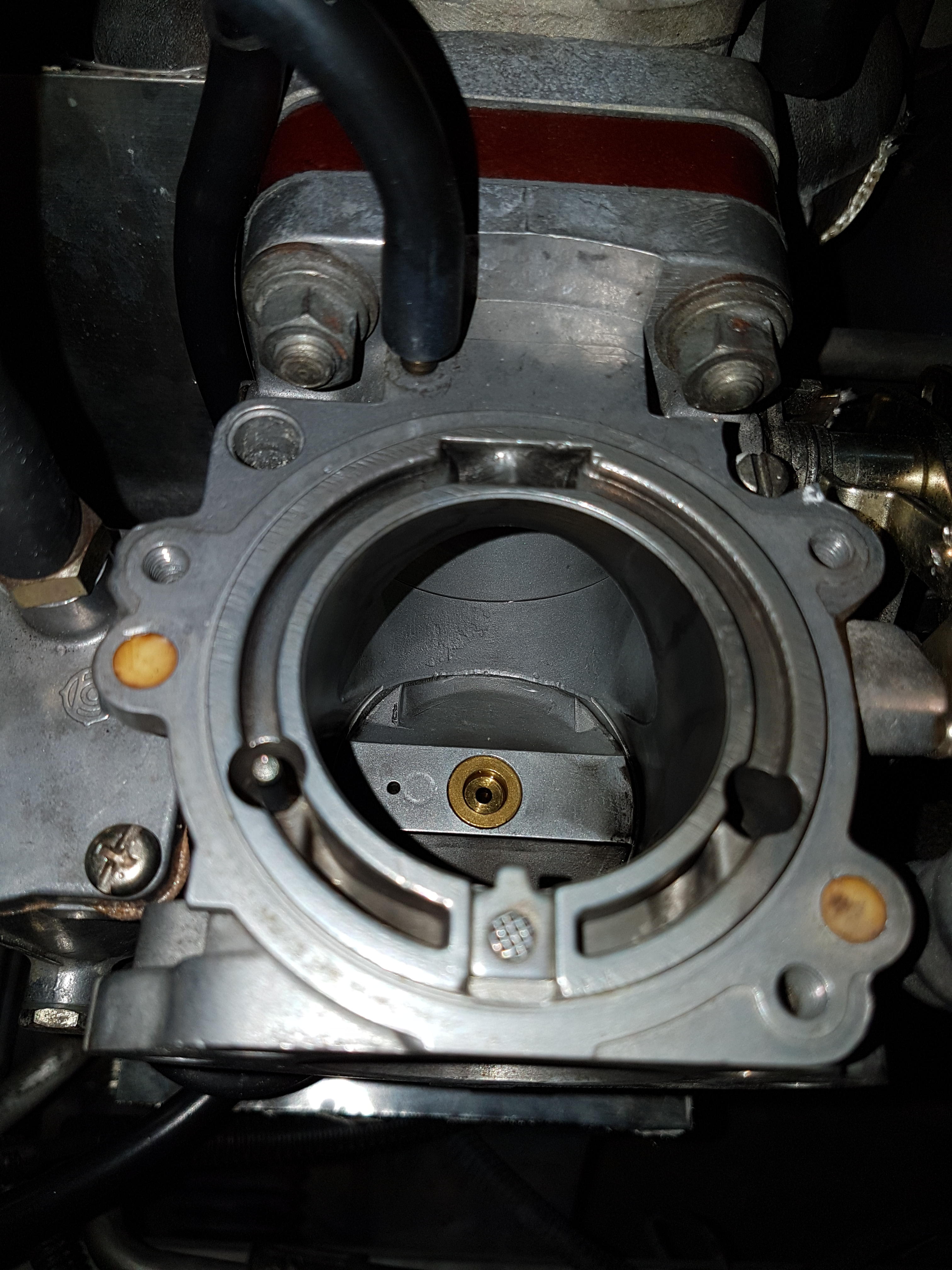

 I'm sure he had a good reason at the time, although I can't explain why. But, if I had to hazard a guess, he may have been trying to compensate for a float setting that left the fuel too low in the nozzle. Let's proceed. Your goal now is to get the fuel level within 1/16" of the top of the hole in the center of the nozzle. (Leave the nozzles at 2 1/2 turns) To achieve the 1 1/6" fuel level,  you'll be adjusting (re-bending) the float tangs either up or down. At this point you don't care about the 9/16" float measurement. Ignore it. Don't even go there. After each adjustment, reassemble the carbs, fire it up, run it for a minute, shut it down and pull the domes and pistons. Look again to see the new fuel level. Readjust the floats until the fuel levels are correct. Then we'll go into fine tuning with the mixture screws. Piece of cake.

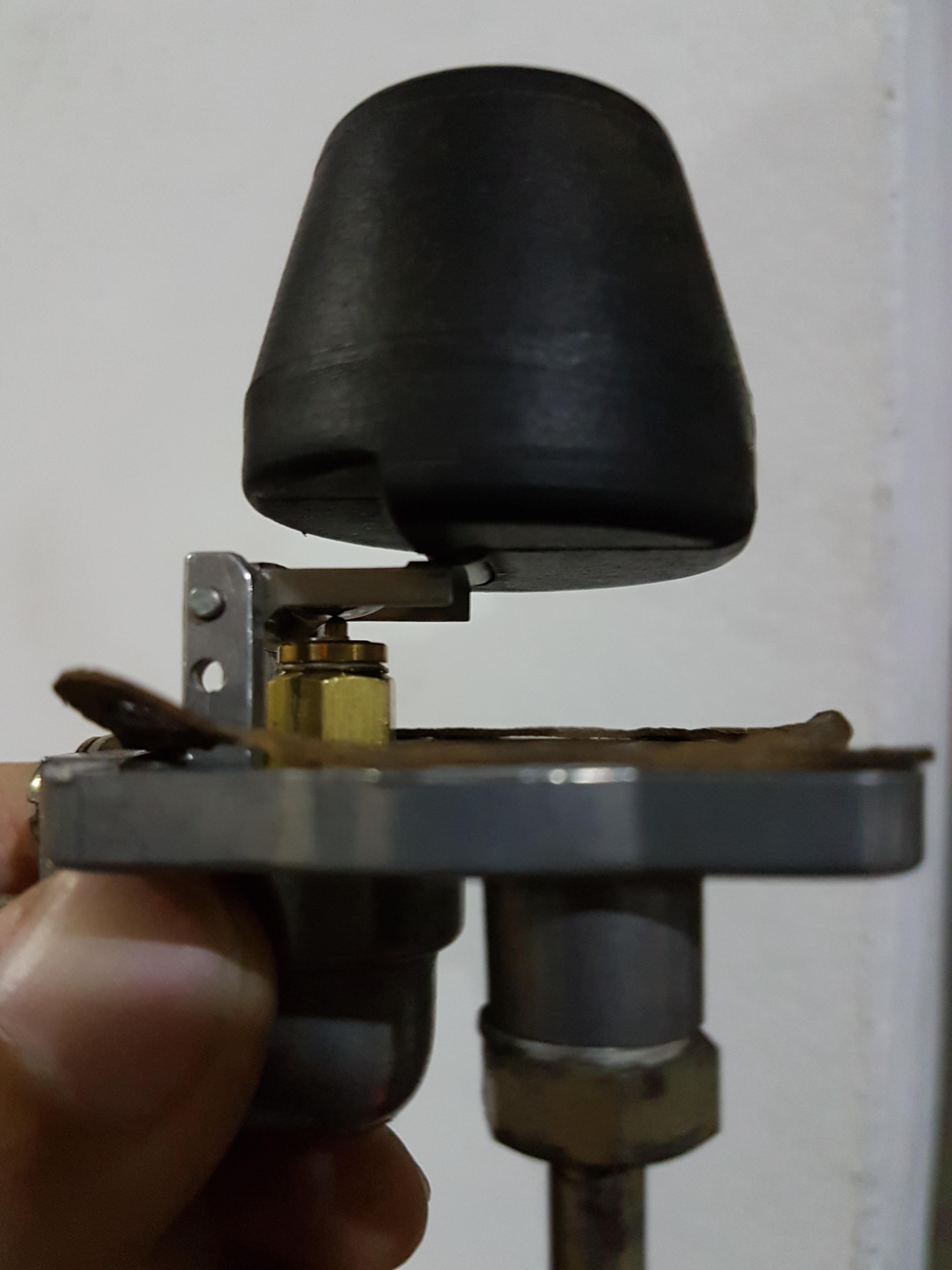

I installed the taller size needle and seat and move the pin of the float to the original slot.
 Sounds good. Give it a crude (grey area) 9/16" adjustment and reassemble the carbs. Start it up, run it for a minute, shut it down and check the fuel height in the nozzles. Readjust the float tangs to get the fuel level to within 1/16" of the nozzle tops which are still 2 1/2 turns down. This may take a few tries (along with float gaskets) to get them right. Keep us posted on your progress.

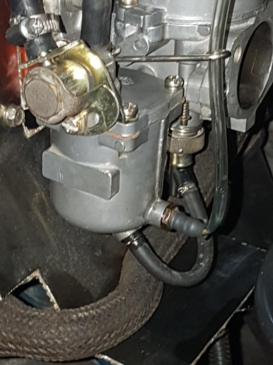

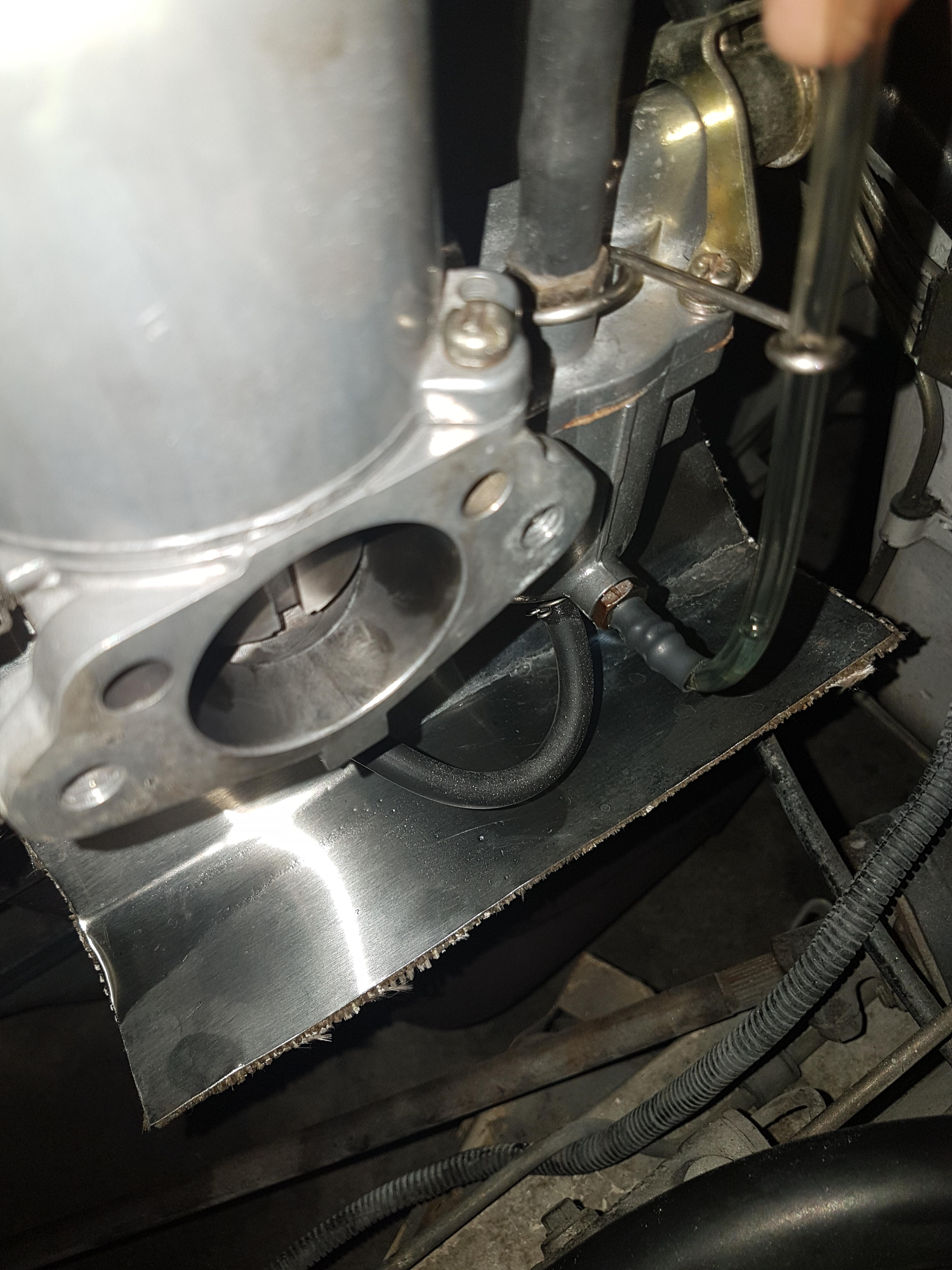

Can i try with the pair of clear sight plastic tubes i bought from z therapy and which are fastened on the drain plugs? Will i be able to get the floats set better with these tubes more precisely? If so how does this work?
 Sure, you can use the tube method and it will get you there or close to it. Probably "good enough". The method that I'm suggesting is the 100% sure way to know that the fuel is at the proper height. Keep in mind that the float adjustment is THE PRIMARY MIXTURE SETTING. Get that right and everything else gets a lot easier.

How to i measure the 1/16 over the top of the nozzle?
 Not over the nozzle. The fuel level should be even with or just below the top of the small hole in the center of the nozzle. This is the hole that the needle slides into. The fuel level can be below the nozzle top as much as 1/16" but should never be over the top of the nozzle. Fuel over the nozzle top will result in fuel puddling above the nozzle. No need to measure the 1/16". Just eyeball the fuel level so it's as close to the nozzle top as you can get it without going over. Luck.

I also did the sight tube test on the front and rear carb but it does not reach to the correct level in the rear and front carb.
