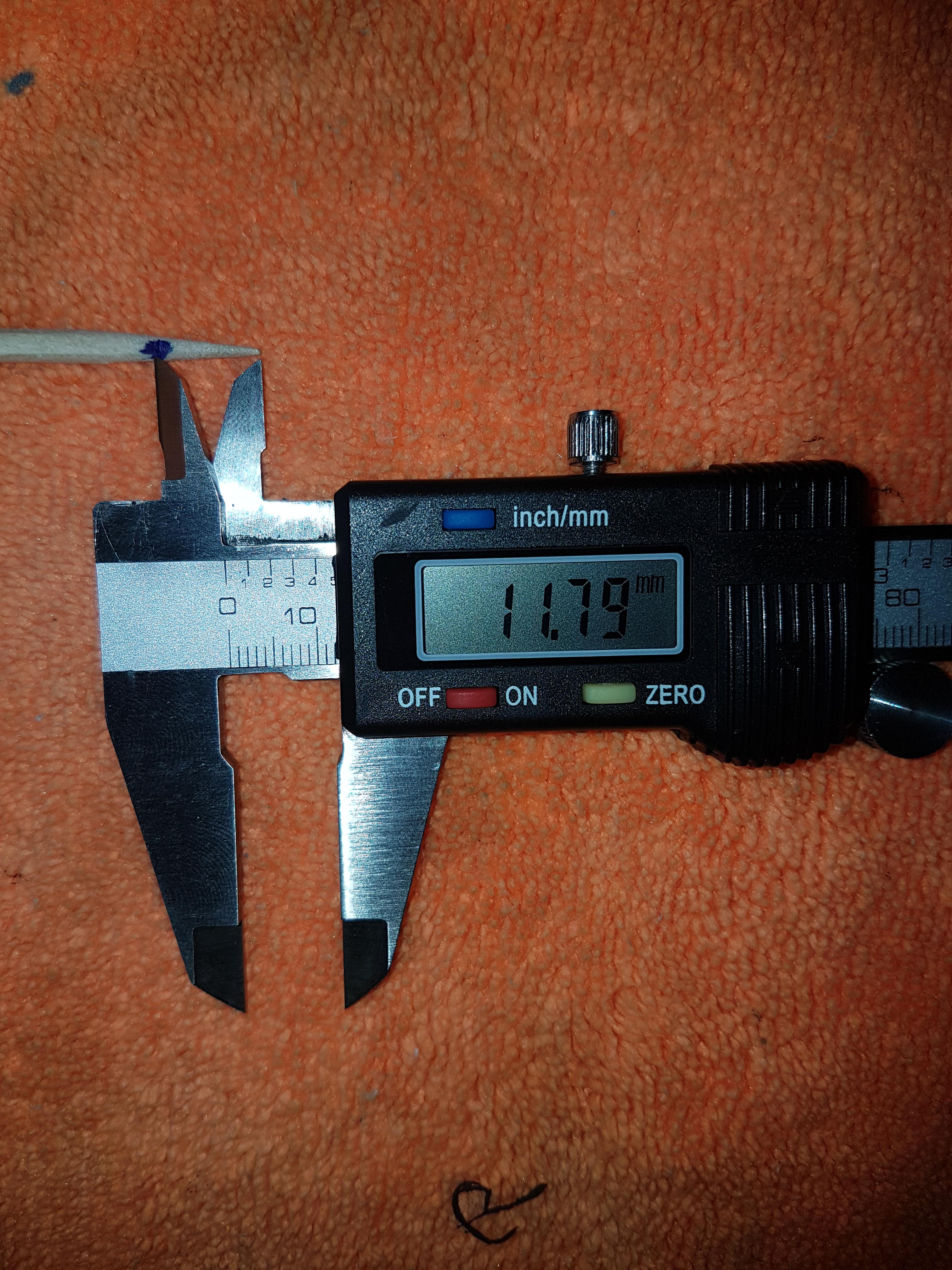

April 7, 20187 yr comment_546806 I hope that works, that would be great. If not, you could try sticking a toothpick down the hole until you hit the fuel surface and then mark the toothpick at the top of the nozzle or the top of the brass sleeve that holds the nozzle. Measurements don't have to be in the thousandths, Mm's would be fine. Link to comment https://www.classiczcars.com/forums/topic/47304-1972-float-adjustment/?&page=43#findComment-546806 Share on other sites More sharing options...
April 7, 20187 yr comment_546818 Just hope toothpick doesnt fall in the hole. Ill set it back to 2.5 turns clockwise and measure. If its not there should i bend the tab more? Link to comment https://www.classiczcars.com/forums/topic/47304-1972-float-adjustment/?&page=43#findComment-546818 Share on other sites More sharing options...
April 7, 20187 yr comment_546824 Even if the toothpick falls into the hole, it will float. There's no need to reset the mixture screws back to 2 1/2 as long as we know how many turns down they are during the measurement. Link to comment https://www.classiczcars.com/forums/topic/47304-1972-float-adjustment/?&page=43#findComment-546824 Share on other sites More sharing options...
April 7, 20187 yr comment_546825 It doesnt even get the toothpick wet at the meaurement shown at 2.5 turns clockwise. Link to comment https://www.classiczcars.com/forums/topic/47304-1972-float-adjustment/?&page=43#findComment-546825 Share on other sites More sharing options...

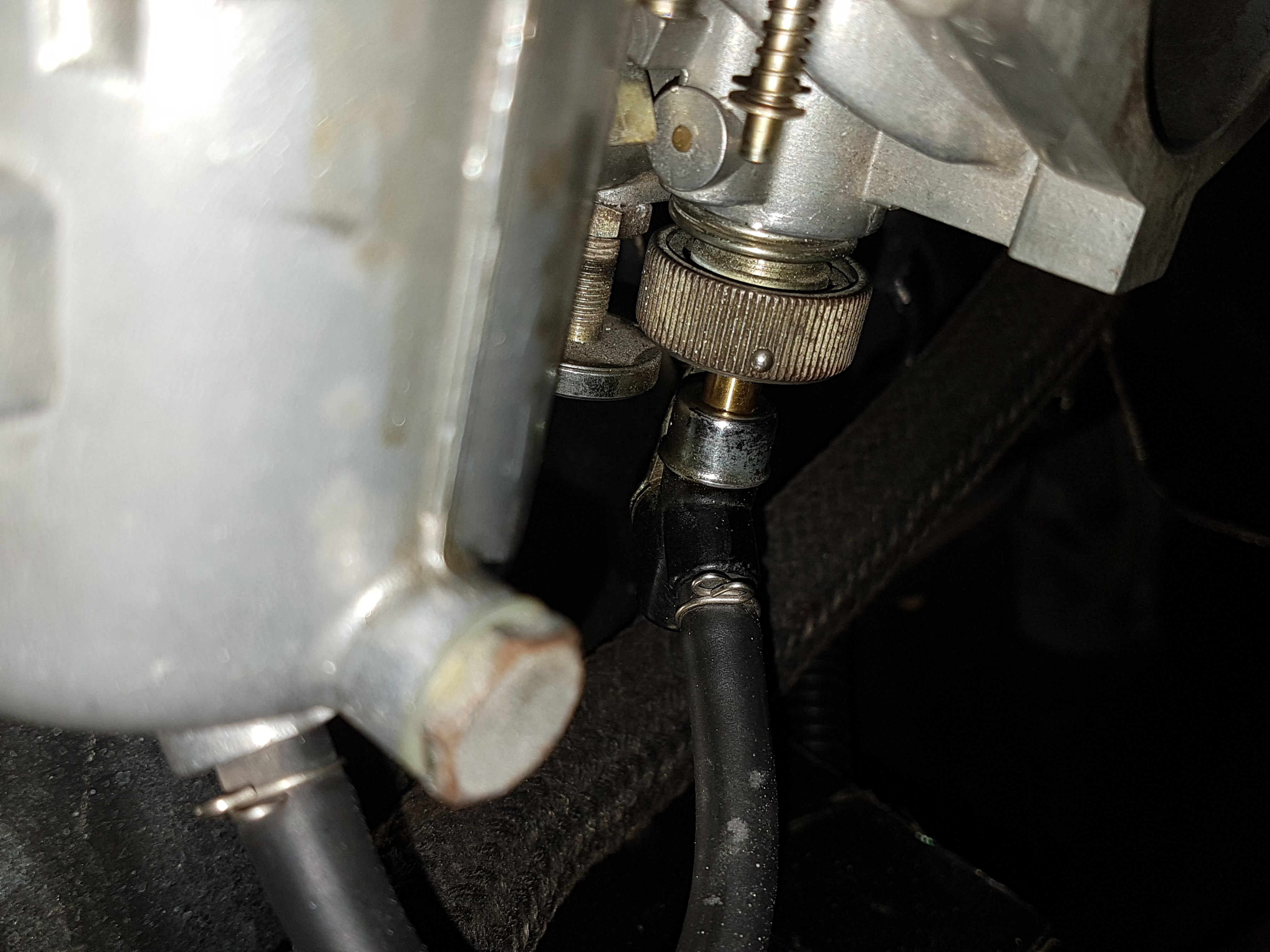

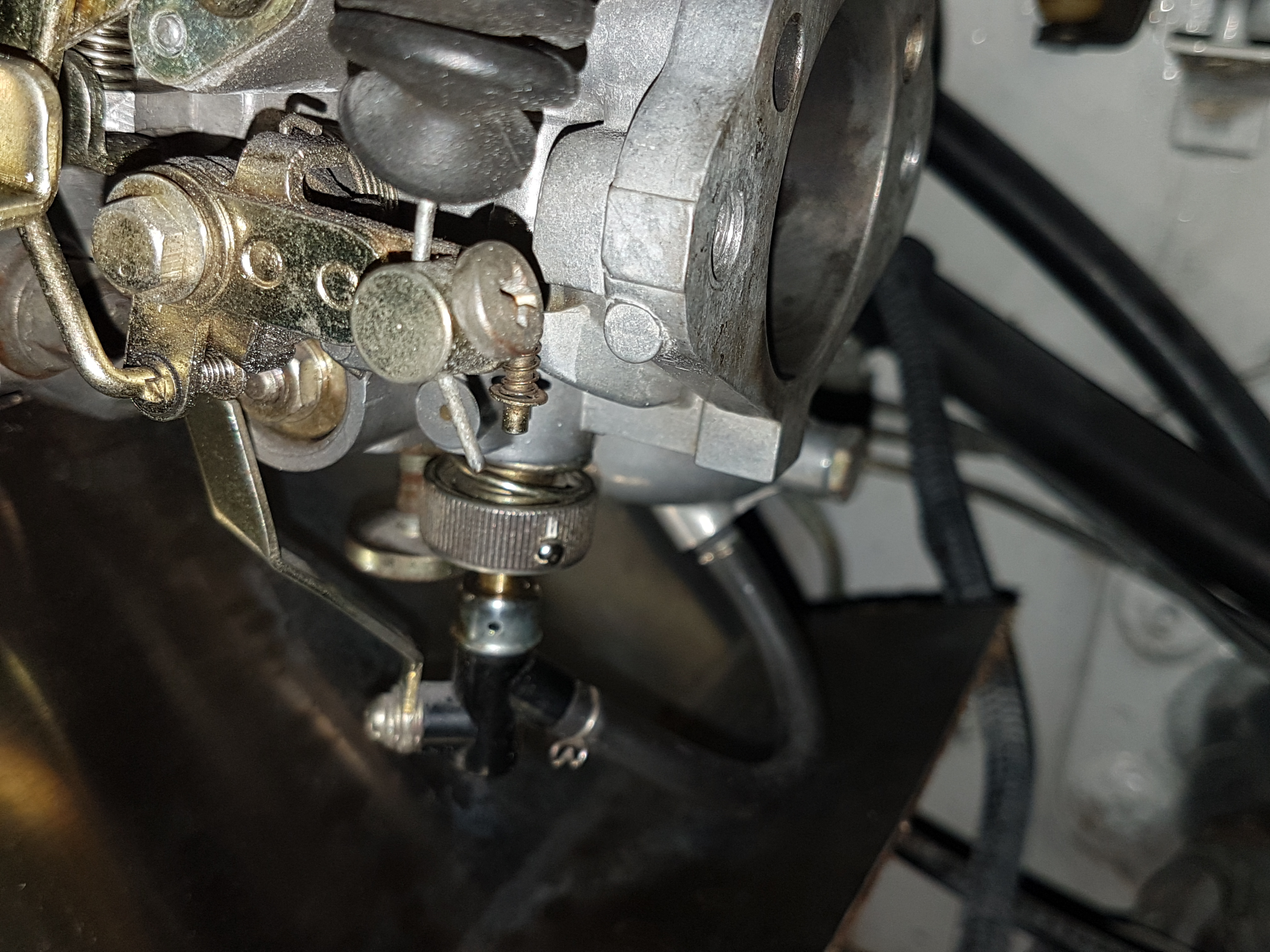

April 7, 20187 yr comment_546829 That doesn't help. I don't know what your reference points are. let me put it another way. However you can do it, the measurement that would help us, is the distance from the fuel surface to the top of the tube that the nozzle slides in. The brass tube surrounds the nozzle. BTW if you turn the mixture screws CCW, (Jalex's term for leaner), to zero turns, the tops of the nozzles will be even with the top of the brass tube. I would think it would be easier to get a measurement with the choke lever pulled all the way back which pulls the nozzles all the way down. If you can come up with that measurement, we can all get back to the unsettled, at least in my mind, question of the proper float height , and as C. O. brought up, how critical is the float level in SU's? We can also eliminate one of the cold sputtering causes. Link to comment https://www.classiczcars.com/forums/topic/47304-1972-float-adjustment/?&page=43#findComment-546829 Share on other sites More sharing options...

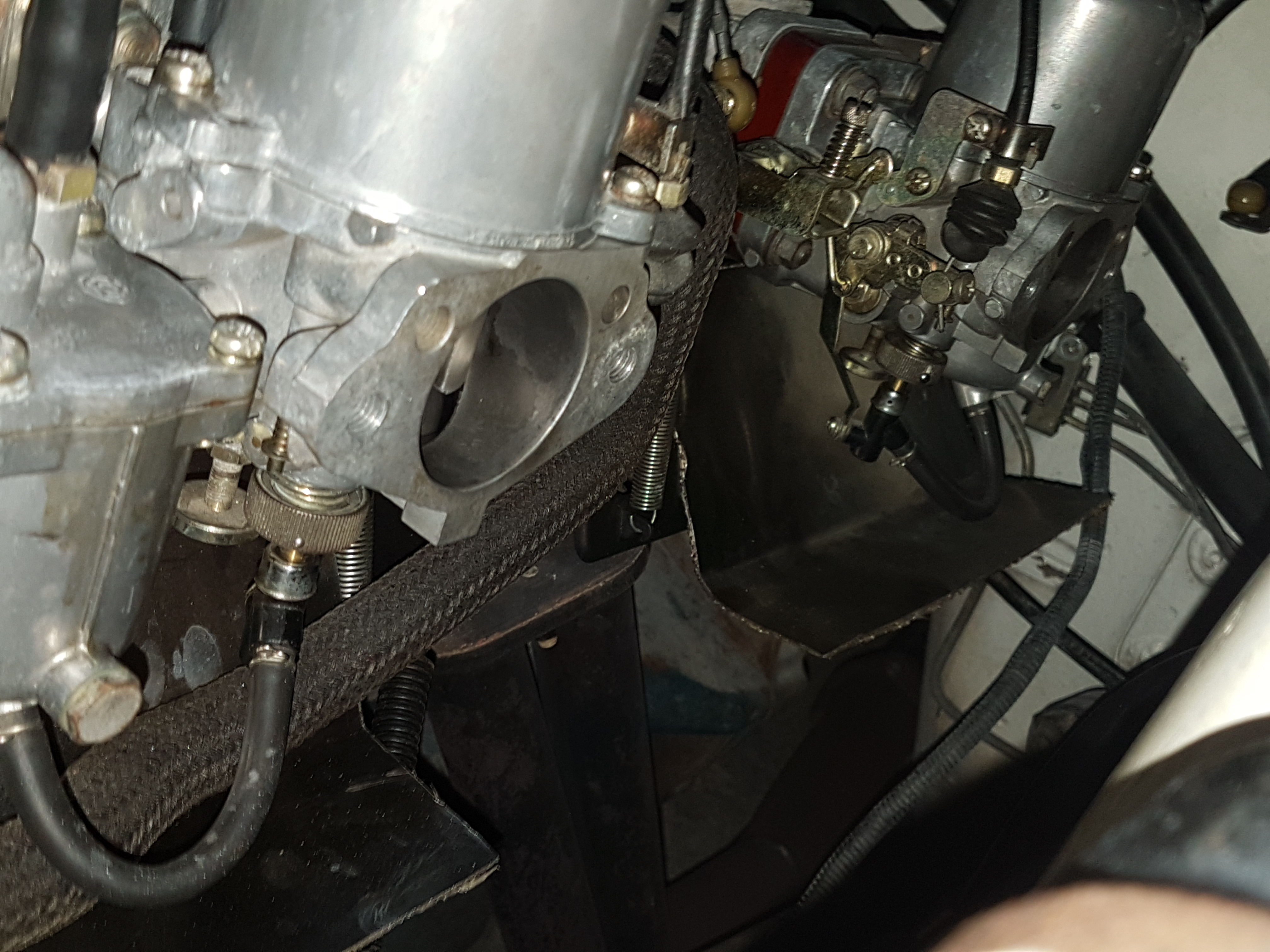

April 7, 20187 yr comment_546830 Choke cable was not well adjusted only front carb jet went down. Now fixed. Link to comment https://www.classiczcars.com/forums/topic/47304-1972-float-adjustment/?&page=43#findComment-546830 Share on other sites More sharing options...

April 7, 20187 yr comment_546836 17 minutes ago, jalexquijano said: Choke cable was not well adjusted only front carb jet went down. Now fixed. Told juh. Those things are tough to get right. I made marks on mine so I won't have to go through that again. Edited April 7, 20187 yr by siteunseen Link to comment https://www.classiczcars.com/forums/topic/47304-1972-float-adjustment/?&page=43#findComment-546836 Share on other sites More sharing options...
