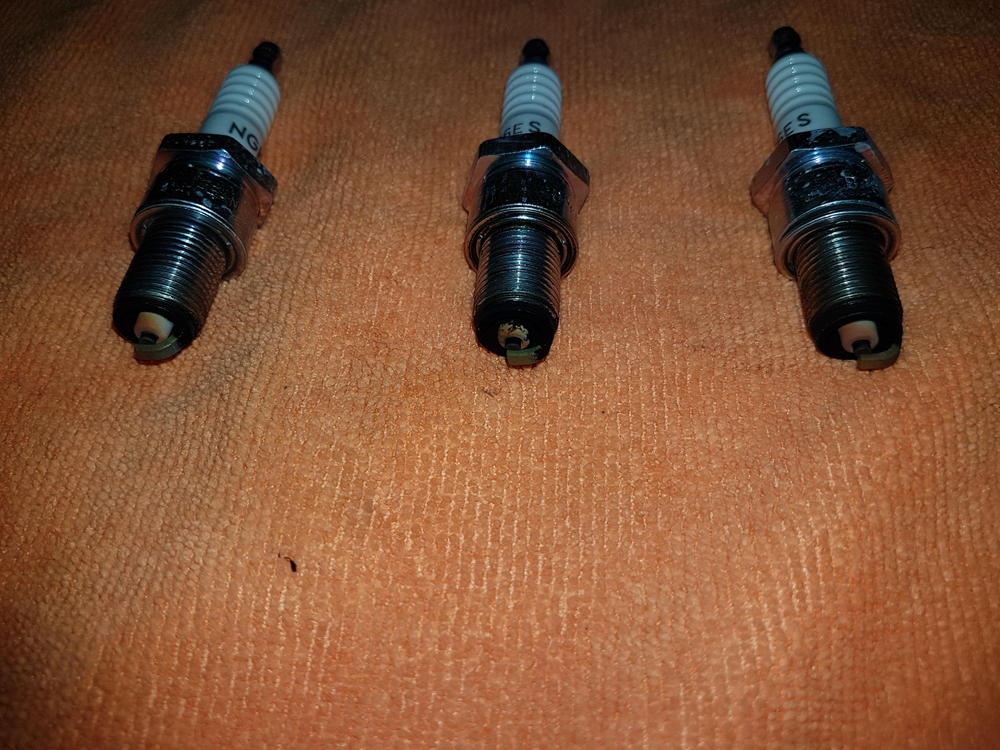

April 5, 20187 yr comment_546672 On 1/4/2018 at 4:36 PM, Mark Maras said: Excellent. The coughing you're describing is a too rich mixture caused by too much choke. You've figured out that the choke can and should be adjusted to suit the conditions, ambient and engine temperatures. While I'm thinking about it, should you ever want to see if the fuel mixture is too lean (when the engine is warmed up) gradually pull the choke while you're SLOWLY accelerating. If you feel the power increase the mixture needs to be a bit richer. Drive it for a few days or until a new question arises. Oh yeah, have you driven by your old mechanic's shop yet? Plugs 2, 4 and 5 at 3.7 turns clockwise Link to comment https://www.classiczcars.com/forums/topic/47304-1972-float-adjustment/?&page=41#findComment-546672 Share on other sites More sharing options...
April 5, 20187 yr comment_546677 that's the same plugs since float adjusting? #4 still looks bad. A proper valve adjustment may clear that up but after adjustment you'll need a new set. I know you get tired of buying plugs but you've spent sooooo much money on fuel pumps. Now your floats are right time to buy one more set. Sucks but that's part of the game. Link to comment https://www.classiczcars.com/forums/topic/47304-1972-float-adjustment/?&page=41#findComment-546677 Share on other sites More sharing options...
April 5, 20187 yr comment_546678 @jalexquijano Ditto what Cliff said. Swap #4 plug with any other plug and see if #4 cylinder fouls with a different plug. BTW, I'd like to see a little Never-Seize thread lube on those plug threads. Link to comment https://www.classiczcars.com/forums/topic/47304-1972-float-adjustment/?&page=41#findComment-546678 Share on other sites More sharing options...
April 5, 20187 yr comment_546684 24 minutes ago, siteunseen said: that's the same plugs since float adjusting? #4 still looks bad. A proper valve adjustment may clear that up but after adjustment you'll need a new set. I know you get tired of buying plugs but you've spent sooooo much money on fuel pumps. Now your floats are right time to buy one more set. Sucks but that's part of the game. Samr plug since float adjustment. Link to comment https://www.classiczcars.com/forums/topic/47304-1972-float-adjustment/?&page=41#findComment-546684 Share on other sites More sharing options...

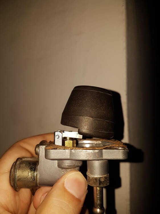

April 6, 20187 yr comment_546760 You still recommend setting the carbs at 2.5 turns and verifying the 1/16th under the nozzle? If its not there then i should take both floats out and bend the tangs a little bit more. This is how they look the last time i took them out several weeks ago after bending the tang more to reduce the gap. Link to comment https://www.classiczcars.com/forums/topic/47304-1972-float-adjustment/?&page=41#findComment-546760 Share on other sites More sharing options...
April 6, 20187 yr comment_546761 No need to readjust yet. I'd just like to know where the fuel level is to use as a reference point and to be sure the fuel level isn't too high and puddling on top of the nozzles. Also, I'd still like to know if easing the choke off a little when the engine is sputtering and cold makes the engine run better or worse? Link to comment https://www.classiczcars.com/forums/topic/47304-1972-float-adjustment/?&page=41#findComment-546761 Share on other sites More sharing options...

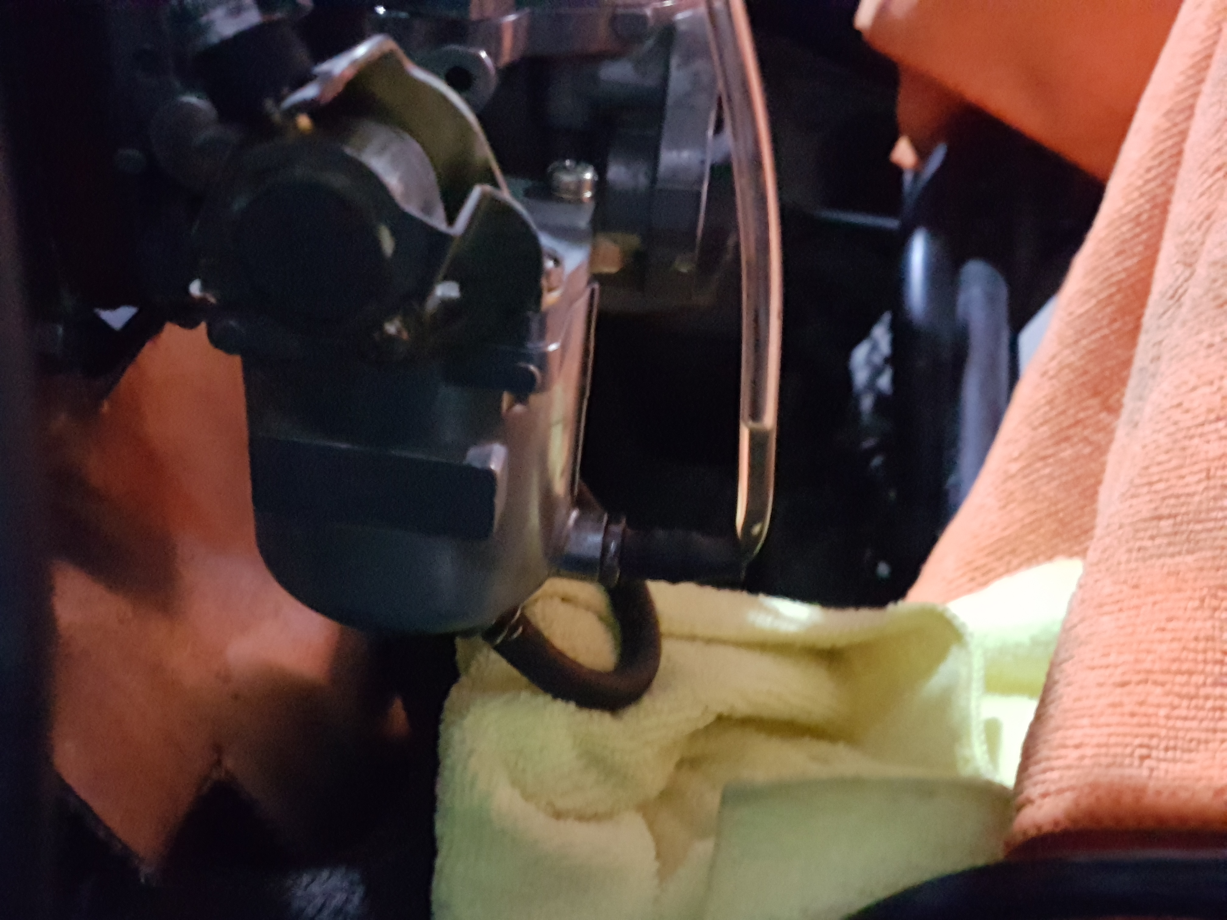

April 6, 20187 yr comment_546765 So if there is no puddling at 3.70 turns clockwise then i will need to take both floats out and bend the tang more. i thought that with the clear tube pictures above the fuel level was ok. Edited April 6, 20187 yr by jalexquijano Link to comment https://www.classiczcars.com/forums/topic/47304-1972-float-adjustment/?&page=41#findComment-546765 Share on other sites More sharing options...
