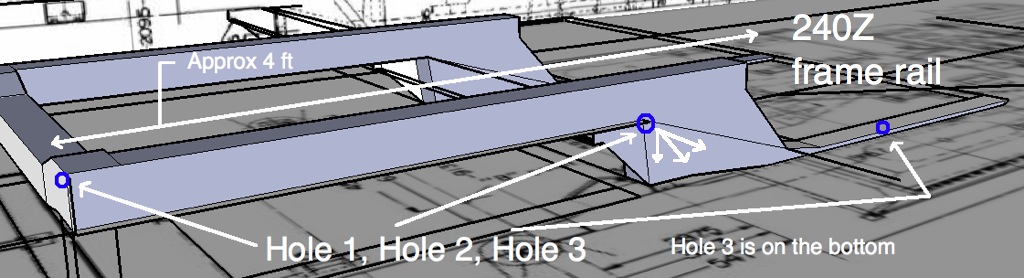

Holes I enlarged or existing holes I used to spray anti rust:
I also made twin holes 2 inches DIA, one under the gas pedal to get to the rear end of the driver's frame rail closest to the driver and a similar one under the forward foot area of the passenger floor to get to the inside of the passenger side frame rail. I used a Transtar Amber spray can as the nozzle for it (purchased separately) has a 360 degree spray pattern. The Eastwood spray can that Blue points out sprays radially which sounds like a similar pattern.
