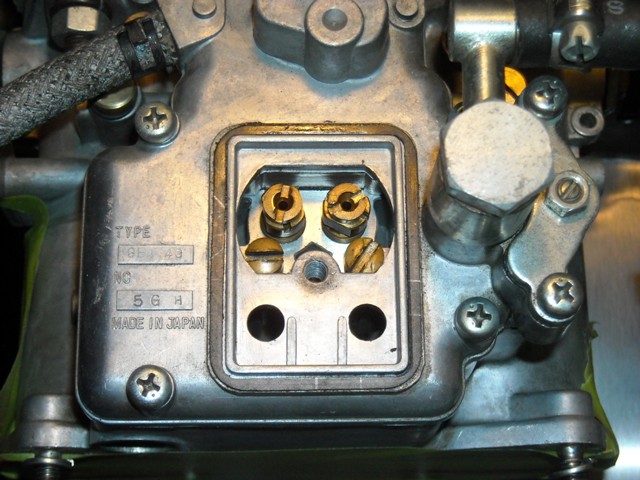

Hey all, my oer's came in. Older set from JP. Just wanted to let every one know some tidbits I discovered that Might not have been covered, if they have sorry for the double posting.
Well i made 2 carbs into 1 by utilizing my top half and a working bottom half. What I found out was Oer has 2 types of
Jet tower setups. A stnd mikuni jetting style and a weber type. The sk set on my car are weber style but the newer oer set are the newere stnd type. They do not interchange and you need to use one or the other.
Its an easy fix by swapping jet towers,but if you want to order a new set or find a used set ask the seller or specify what type of jettings it uses. So you can plan accordingly.
Type stnd or
Type w.
Well that's interesting, it would be good know when that change took place.
Any chance you could post some pics of your jet towers and the rest of us could do the same? But then SK may have just changed the Dia. of the hole and thread size and not changed the outer appearance, worth I try.
Chris
Yup, will take pics tomorrow. The towers are the same on the outside. The emulsion tube holes are def different dia. The weber tubes will thread in but not rest like the sk tube and cause the main jet to get stuck. Not that I'd know what a pita that's like LOL.

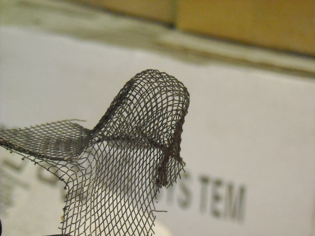

So here are mine, the air jet looks like your second photo so I guess that is a Mikuni style of jet, but my idle jet holder is just slotted like on the blown up parts diagram and not like yours. I'm pretty sure my carbs were purchased in 1999 new from OER.

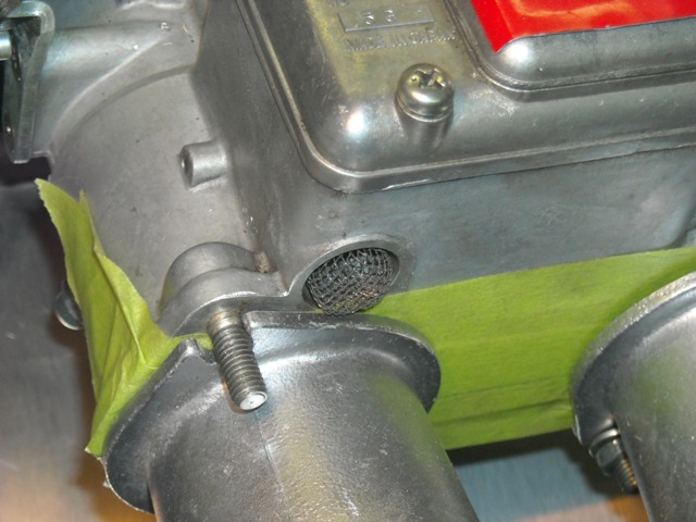

SK/OER carbs have this 1/2" dia hole on the face of the intake, a breather of some kind. We have a lot of pollen bees around our property and they are forever looking for any hole they can plug up with mud, eggs, larva and more mud so this is what I came up with to try and defeat them,
So far they feel pretty secure.
Man, it must be January if I think this is worth posting.
