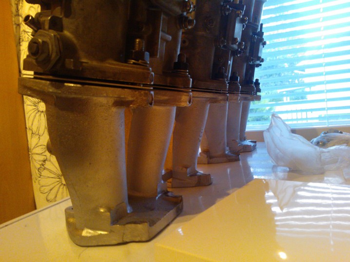

What manifold are you using? If you haven't bought one yet I would go with the shortest you can find only because by the time you have horns on or air filters there is very little room left between the carbs and the shock tower/Master cylinder.

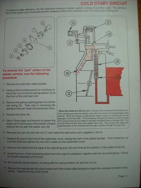

I am curious about how well the SK carb does with the cold start circuit in cold weather? Anyone know how it works?

post-26437-1415082541505_thumb.jpg This will probably answer your question.

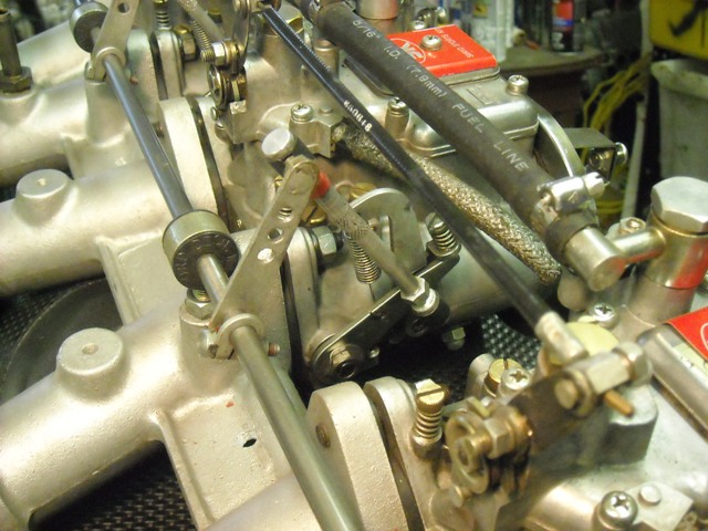

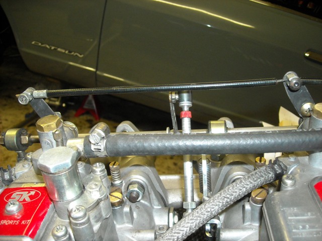

Koalia, here is a link to Wolf Racing, they have some good images of linkages,
Customer Gallery - 6 Cylinder Carb Setups

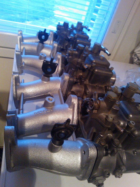

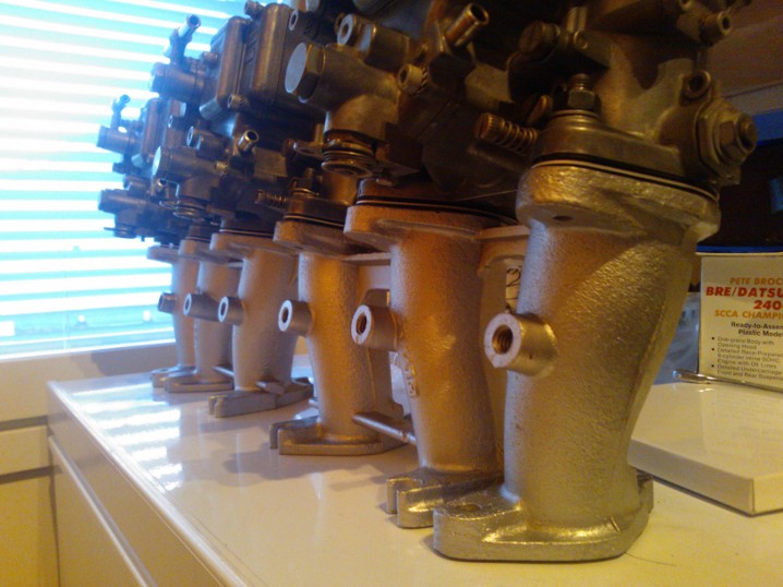

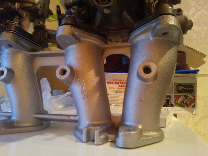

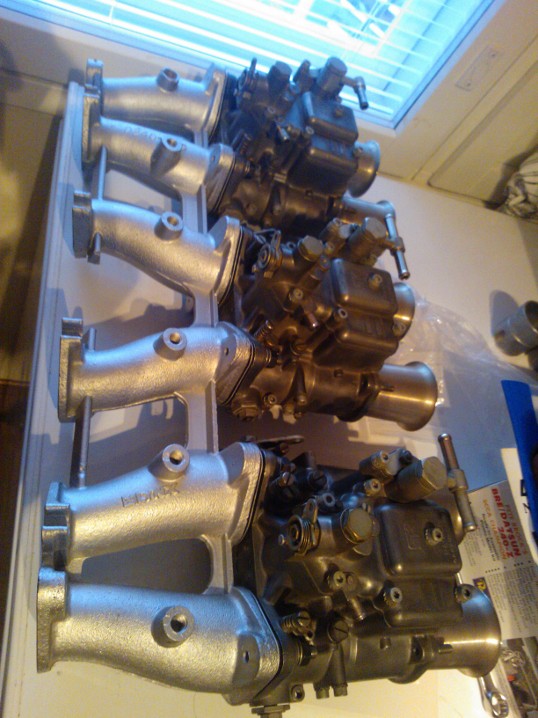

I have Lynx (quite short) manifold, at least its shorter than the Cannon manifold on the link you provided. It should fit quite well with the 62mm horns. Nice pictures, but there is so many kind of levers and shafts so i dont know which might be the right size, in that i was hoping you could give some measurements. I can measure the manifold etc if that helps.

Koalia, I'm happy to give you some measurements from my set up but you have to know that what I have and what you need may be two different things. Linkages by their nature are adjustable and it will probably be fine, but it also may not,
do your research.
Does your Lynx manifold have rod ends and a rod yet or is it bare? Can you post some pics, 5-6 with detail of the manifold and what is on it?
