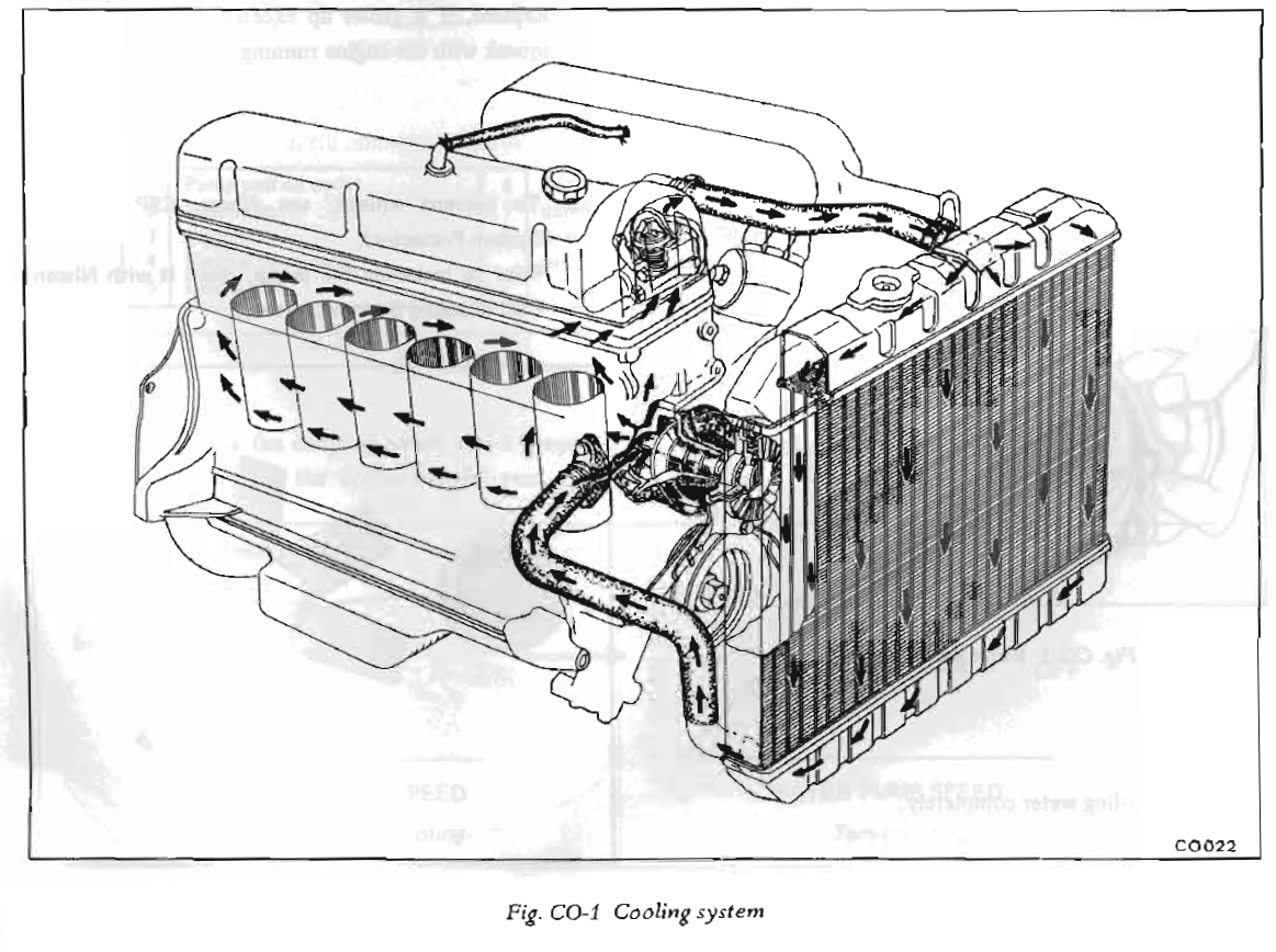

June 18, 201312 yr comment_425881 Just put a traditional thermometer in the radiator when the gauge was showing the above reading and it showed 180 degrees. Also checked the fan clutch and it appears normal. My guess is the gauge is off!Burl,Based on that it seems that the gauge maybe off. If I remember correctly, the coolant flows from the bottom of the radiator to the through the engine and out of the top, so the water at the top of the radiator should be the hottes - please correct me if I'm wrong. If you're worried about it still you could flush the radiator and see if anything comes out. When I first bought my Z and flushed the motor/radiator it was rather rusty and disgusting. I live in Tucson and in the summer it normally get well above 100 degrees here and is rather dry as hell. As I expressed in the last post, I personally don't enjoy when the Z runs about 200 degrees. Its my personal preference nothing more. As 280~master posted I think your gauge might be out of wack, though your thermostat might be a bit hot for such weather. Hope that helpsJan Link to comment https://www.classiczcars.com/forums/topic/46787-temperature/?&page=2#findComment-425881 Share on other sites More sharing options...

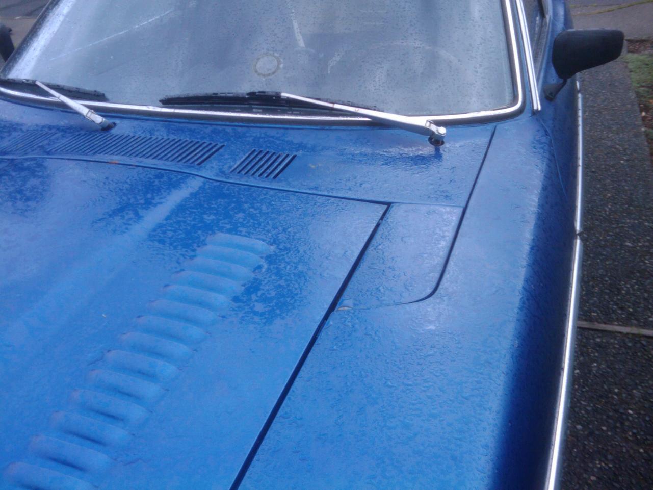

June 18, 201312 yr comment_425894 If I remember correctly, the coolant flows from the bottom of the radiator to the through the engine and out of the top, so the water at the top of the radiator should be the hottes - please correct me if I'm wrong. Yep! Downflow. For the visual learners: My car ran dead-center in the middle of the gauge on the hottest days with a 3 core 280zx radiator, and now that I have a dual electric fan assembly (out of a late 90s altima, $18 at the junkyard woo woo!) it runs about 1/3 of the gauge rock solid on 80 degree days, still haven't had a good 90 or 100+ yet here in Seattle since I did the swap though. (granted I have both fans wired to low speed, flick the switch over to dual high speed and I've got a hurricane under the hood) Other relevant data, I've got hood vents that actually exhaust visible wavy hot air, so I've got even more cooling airflow than most folks anyways: Sometimes I wonder if I'm the only guy out there with an early Z that actually runs cold Link to comment https://www.classiczcars.com/forums/topic/46787-temperature/?&page=2#findComment-425894 Share on other sites More sharing options...
