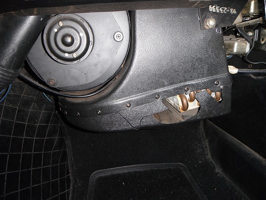

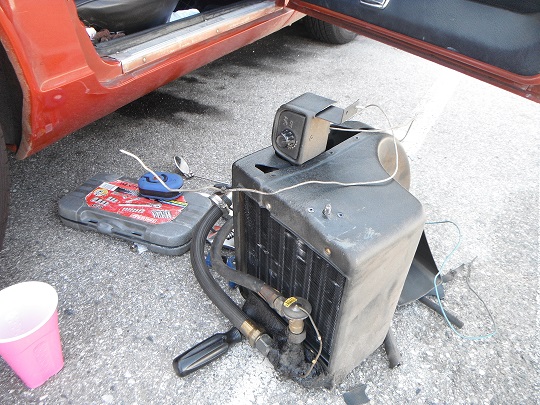

Does anyone know who the manufacturer was for the Receiver/Dryer used with the A-R-A dealer installed A/C system? I believe the original did Not have a switch mounted on top of the Dryer unit like what was used on the 1974 and up Nissan/Datsun installed units. Looks Like I have everything but this item as the Prev owner removed it for a much smaller barrel style in-line Dryer. Does anyone know what unit was used in the Dealer installed kits of 1970-1973? Almost done adding the dealer installed A/C components back to my car for vintage 05/72 240Z but am missing the dryer. Any suggestions. Currently I am installing more for the look and to keep the car as a vintage 1972 appearance and not looking to hook up the Compressor belt for functionality. Does anyone have the correct dryer that they are not using any longer?

No compressor, no drier, I'm beginning to see why the AC didn't work.
that and besides the hoses you would be missing the condenser (mounted in front of the radiator behind the horns.)
The compressor from A-R-A was mounted on the passenger side front of the engine by a mounting bracket that wrapped around the front of the engine block. looks like you only have the parts that were mounted inside the car and not the parts under the hood.
