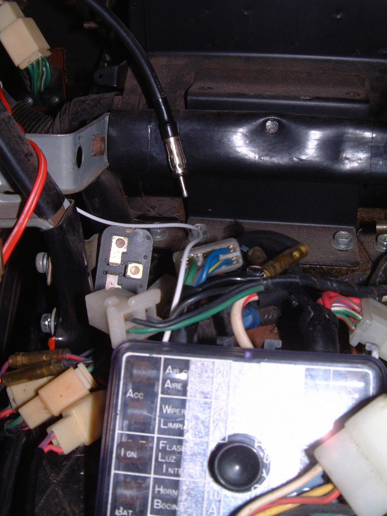

Posted May 4, 201312 yr comment_422489 Hello,I can't relocate a thread I read a few weeks ago which identified a plug with 2 black and 1 green wire behind the dash. I'm putting a new Radio in and the wires I'm looking at are under where the Radio sits with a 3 pin solenoid fixed to the left side bracket. The plug wasn't fitted onto the solenoid but it will fit. I've downloaded the colour wiring diagram but don't see it shown.Can anyone identify this or remember the thread which discussed it. Don't want to plug it in, switch on and see what happens. Thanks. Link to comment https://www.classiczcars.com/forums/topic/46459-two-black-one-green-wire-solenoid-on-72-240z-auto/ Share on other sites More sharing options...

May 4, 201312 yr Author comment_422508 They weren't the ones however they are very good articles I hadn't read before. I followed the 'Tech tips' link from one of those articles and it lead me to the one I was looking for by the same author, Turn Signal Repair | Fiddling With Z Cars Thanks for pointing me in the right direction. Here's a picture of the wires in question....... Thanks. Link to comment https://www.classiczcars.com/forums/topic/46459-two-black-one-green-wire-solenoid-on-72-240z-auto/#findComment-422508 Share on other sites More sharing options...
May 4, 201312 yr comment_422509 Okay, I believe that is the kickdown solenoid for the automatic transmission. Does your car still have the automatic?By the way, I'm glad you found the posts useful. If you need a switch rebuilt, contact Dave Irwin, aka Zs-ondabrain. Edited May 4, 201312 yr by SteveJ Link to comment https://www.classiczcars.com/forums/topic/46459-two-black-one-green-wire-solenoid-on-72-240z-auto/#findComment-422509 Share on other sites More sharing options...
May 4, 201312 yr Author comment_422510 Yes it does still have auto but I've not been able to drive the car since importing it because I need to pass a DMV inspection. If it is for the kickdown, I'm suspicious as to why it's been unplugged. The blower was also disconnected but seems to work now that I've reconnected the earth. I'll only find out once I get it on the road however those links you sent me had an article on relays so I'll have a read and see if there's a way to do some basic tests.Thanks again, hopefully If I've done it right there's now a signature at the bottom with car details.Thanks again. Link to comment https://www.classiczcars.com/forums/topic/46459-two-black-one-green-wire-solenoid-on-72-240z-auto/#findComment-422510 Share on other sites More sharing options...
May 4, 201312 yr comment_422512 I could be wrong about the relay.You may need to download the 73 FSM to get info on the automatic transmission. The 72 manual doesn't have it, not even the hardcopy I have. The transmissions must have been covered in a separate manual for that year. Anyway, the AT section describes the operation. There should be a switch on the throttle pedal that closes a switch. That switch completes the circuit that should activate the kickdown solenoid on the transmission. It doesn't talk about a relay.If you know how to use a multimeter, I suggest looking for the switch on the throttle pedal. It should have green wires. See if one has continuity with the green wire going to the relay. Also check continuity to ground on both of the black wires. I suspect one of them does not have continuity. Also, can you remove the relay from the car and post the part number? Link to comment https://www.classiczcars.com/forums/topic/46459-two-black-one-green-wire-solenoid-on-72-240z-auto/#findComment-422512 Share on other sites More sharing options...
May 4, 201312 yr Author comment_422515 I'll have a look at the 73 FSM.Yes, there is a switch on the accelerator.It's dark here now, after 10pm, and I don't have good lighting where I keep the car so I'll do those checks tomorrow and have a look at the relay.Thanks for your help, it's much appreciated. Link to comment https://www.classiczcars.com/forums/topic/46459-two-black-one-green-wire-solenoid-on-72-240z-auto/#findComment-422515 Share on other sites More sharing options...
