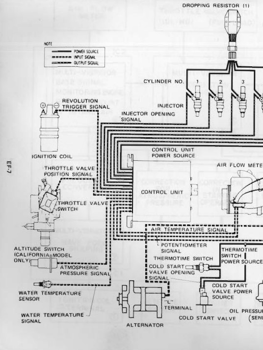

What I was saying is that the fuel injection book was updated in November 1975, an my car is a 78. It's fairly close, but there's enough of a difference that I'm not comfortable with relying on the guide. The FSM is a little bit better though. I have to trace down each and every wire to see what it is as well.

Here's a start.
That does help a little, thanks! Do you have a slightly more complete version of that though? I have the actual 78 wiring diagram printed out, which will help me greatly in tracing down the wiring.
You can lead a guy to the FSM, but you can't make him open it. Har har hardy har. It's a bread crumb.
It's from the Engine Fuel chapter of the 1978 Factory Service Manual (FSM). That thing that we keep mentioning. From XenonsS30. It has smaller, specific wiring diagrams in it also, easier to work with than the the big one, although the big one is worth having also.
Not kidding! It will help you out.
