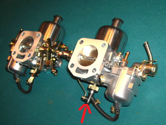

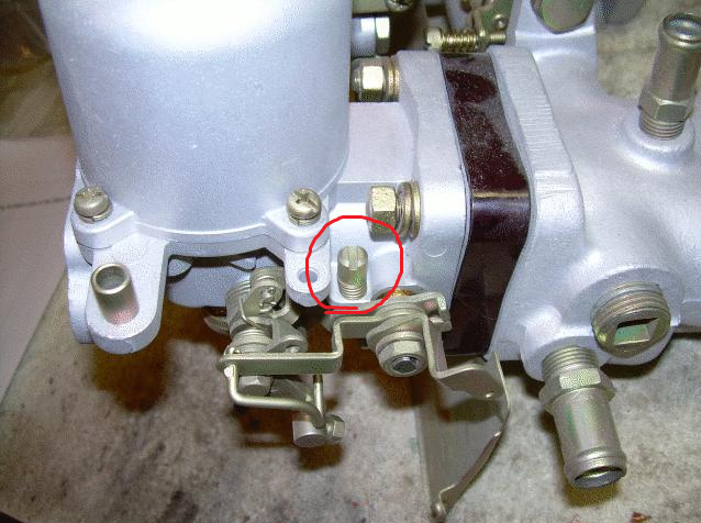

May 24, 201311 yr comment_424096 things to check in no particular order: vacuum leaks float level is absolutely critical to making SU carbs work good. make sure your choke linkage isn't sticking open... in fact make sure none of your linkages are sticking. If you take the domes off and remove the pistons you should be able to see the carb jet, if it moves up when you press up here: that means it was sticking in the down (choke on) position and you have things to tweak on in your linkages. throttle linkage balancing screw each carb's idle control screw (look down the throat of the carb, all this does is crack the butterfly open a little at idle, does nothing when pedal is depressed) pictured: Tightening it all the way and then loosening it 2.5 turns or so should get you pretty close to a decent idle in a carb that is functioning right. if there is play in the throttle butterfly shaft you'll have a big vacuum leak no matter what and the carbs are in need of more servicing than I know how to do. Ztherapy can make 'em better than new if you can afford the price. make sure the pistons drop freely, if they're jammed all kinds of kooky stuff can happen. Speaking of Ztherapy, I highly recommend their Just SU's video. It's all killer no filler and probably 75-90% of how I know a dashpot from a grose-jet. Edited May 24, 201311 yr by Captain_Zeros more good stuff Link to comment https://www.classiczcars.com/forums/topic/46229-260z-doesnt-crank/?&page=4#findComment-424096 Share on other sites More sharing options...
