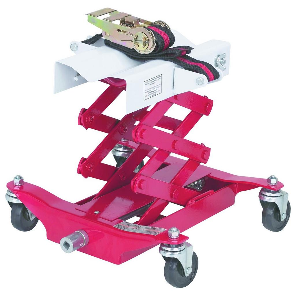

Transmission Jack - 450 Lb. Capacity
- transmission jack really made the job easier
- I had to bend the strap mounting plates on the left side (far side in above pic) to clear my headers
- in my case, dropping the exhaust was a necessity to give me the required clearance to remove the transmission

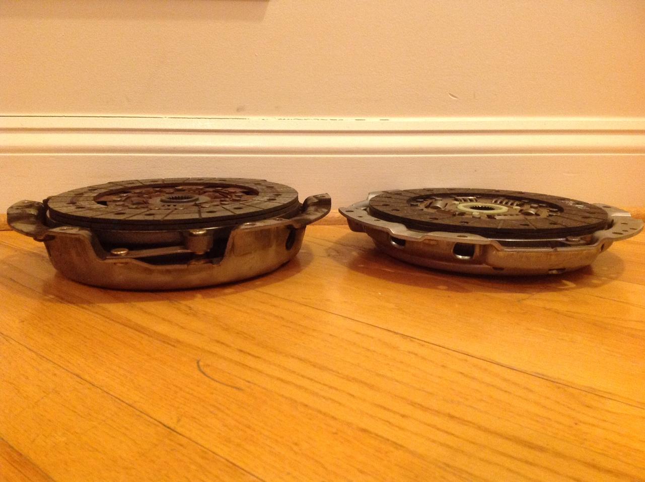

- my 240Z has five-speed from 280ZX installed
- when I removed clutch, I realized the pressure plate installed was a 240Z (240Z pressure plate on left, new 280ZX pressure plate on the right)
- new clutch pressure plate was much thinner, therefore required taller clutch collar
- ordered taller clutch collar from MSA

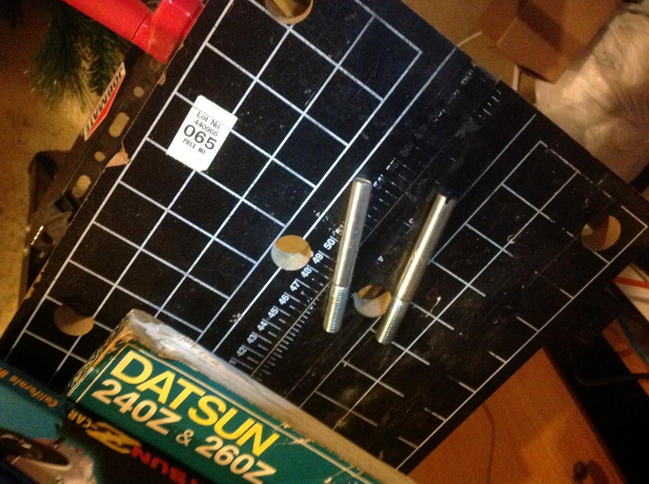

- I used long bolts with bolt head removed and slot cut into shaft
- screwed them finger tight into the top bolt holes in the head to line up transmission for install
- I first tried to install transmission with it in gear and it wouldn't go
- once I put transmission into neutral, install was easy and it slid right in

I always recommend the headless bolts when lining up the tranny. Whether finding that tip on the forums or something you figured out on your own, good job.
Thanks. I searched the forum for suggestions before I started the work and the headless bolts idea, was one I found.

Good thread! I have few questions: i have 77 280z tranny and i have both small and big collars, when i bought the clutch i did not think any further and bought it for 240z, so should i use bigger collar? And does 240z slave cylinder work well with this setup?
Edited by Reverend
Koalia - If the pressure plate you received in your clutch kit is truly a 240Z pressure plate (i.e. the thicker / taller one on the left in the image above), you would use the shorter / smaller collar.
Wrt slave cylinders, mine is the non-adjustable slave cylinder and fork from a later 280ZX. I understand the the 240Z slave cylinder was adjustable and had a slightly different fork. Can someone confirm?
