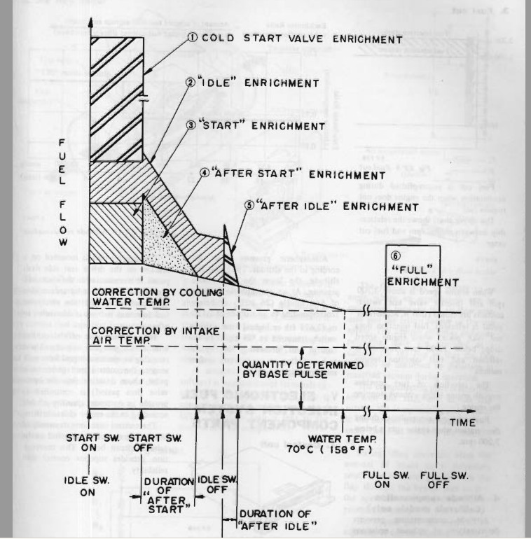

I think that Pin 21 is used by the ECU enrichment algorithm to determine whether or not the engine is cold or has been cranking without starting for a while. The descriptions and this diagram imply that, in addition to the CSV enrichment, that there is also an injector pulse duration enrichment. Two independent Start enrichments.
I don't believe so. I suspect the pin you are thinking of is pin 4 which goes hot in START. That would be the signal to the ECU of how long ago the engine was started. And The ECU already knows when the engine is cold due to the water temp sensor.
I'm no expert, but that's my read.

If you read the description in the image I included you'll see that it says "irrespective of the cooling water temperature" (#3). If you look at the wiring diagram you'll see that my description is consistent with the FSM documentation. "Thermotime" has a time component from the internal resistive heater which heats the bimetal strip casuing it to twist and open the relay (Pin 45 to ground which gets power when the starter is used), and a thermal component, the bimetal strip twists from coolant heat (that's why it's mounted on the thermostat housing).
Pretty sure my reasoning is sound. Just sayin', for the record. Still doesn't help the OP get his brother's engine started when it's cold.
Edit - I think that the difficulty in looking at the wiring diagram is that it's showing mixed serial and parallel circuits, plus a "thermomechanical" device. Power is supplied to several different spots, the ECU, the relay for the CSV, the internal resistive heater in the TS. But, unlike most relay circuits, the mechanism for opening the relay, which is normally closed, is the twisting of the bimetal strip. The little blank rectangle in the switch diagram is not descriptive enough.
Edit 2 - actually, this statement "irrespective of the cooling water temperature" is double-edged and confuses things. I think that they meant the sensor readings, since the thermotime switch is affected by cooling water temperature, therefore would affect the the enrichment if Pin 21 does what I've suggested. Maybe lost in translation. Who's got an oscilloscope and some free time?
