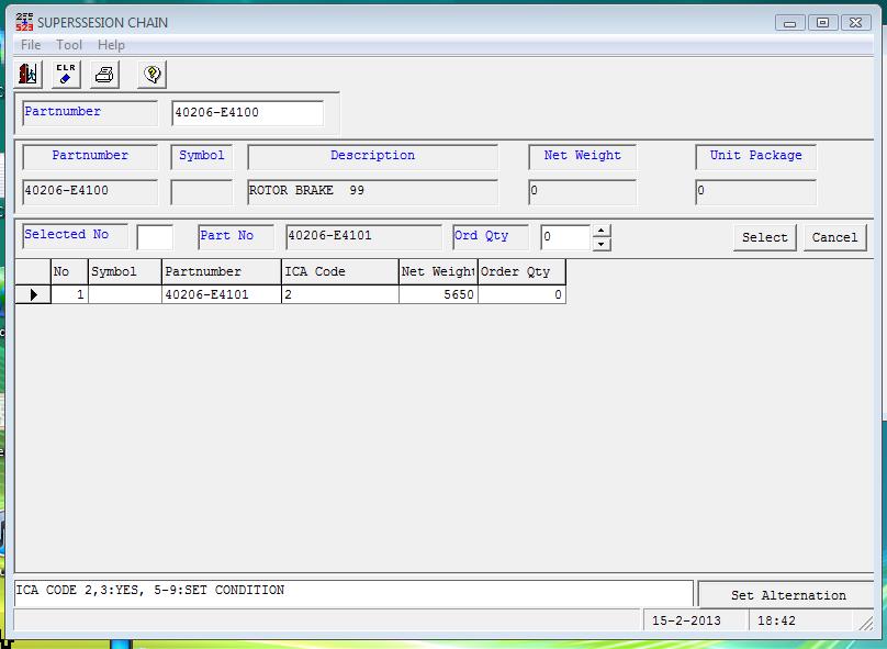

Out of curiosity I looked it up in the E-fast Nissan cat. The catalogue says 40206-E4100 is replaced by 40206-E4101. Its probably the same just improvements over the years.
