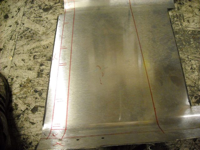

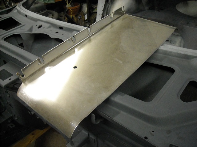

Steve, this is some old stainless steel from a bbq shelf,
I hate parting with hard earned dollars. It still needs to be finished for rough edges and a better shine but you can get an idea of the good materials that are thrown away all the time.

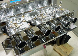

There is nice shinny design Heat Shield(we called heat plate in Japan) getting popular in Japan.
Heat Plate for L6
@ Yahoo Japan Auct
L6 Heat Plate for Solex, OER, and Weber - Yahoo! Japan Auction

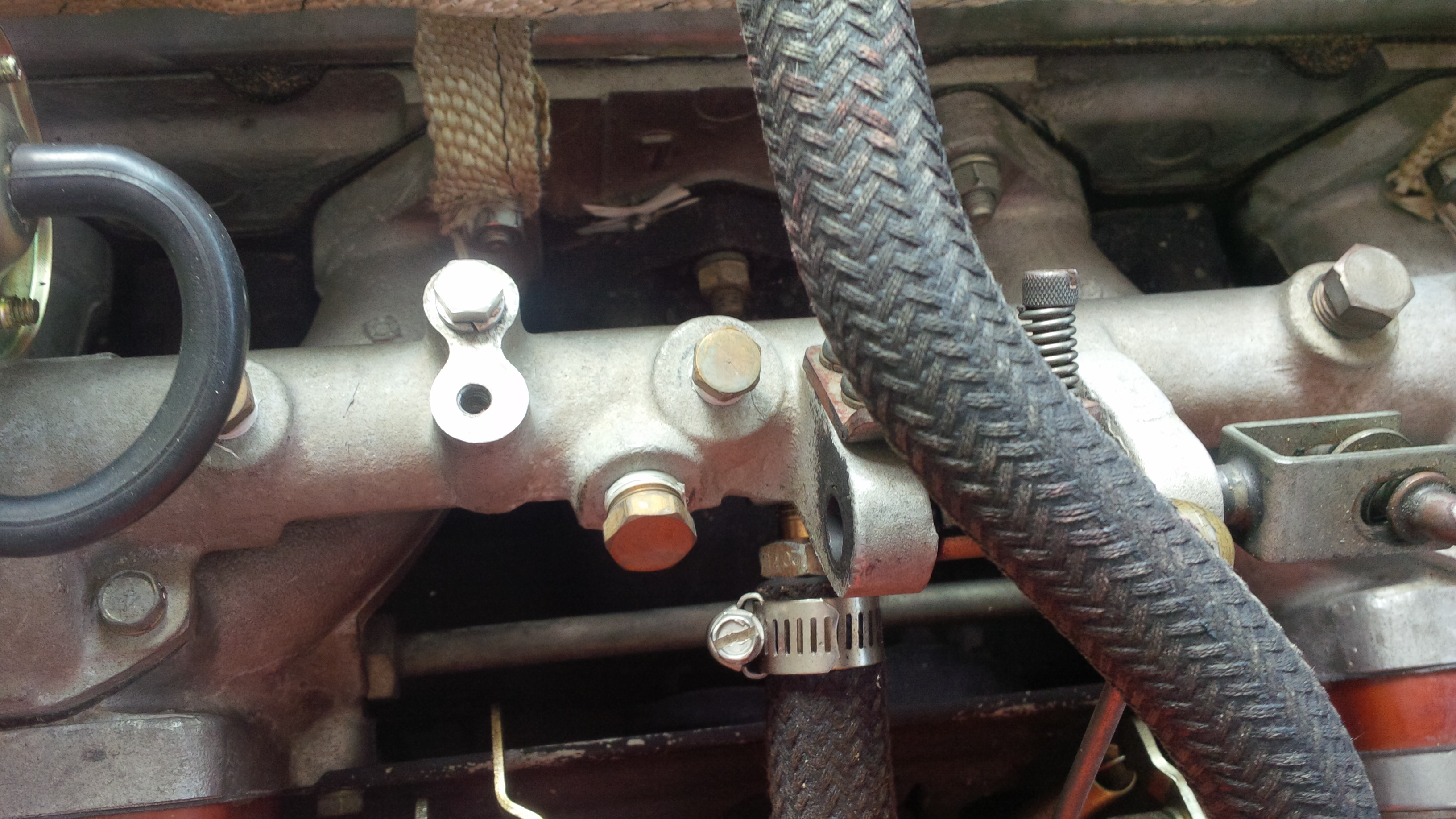

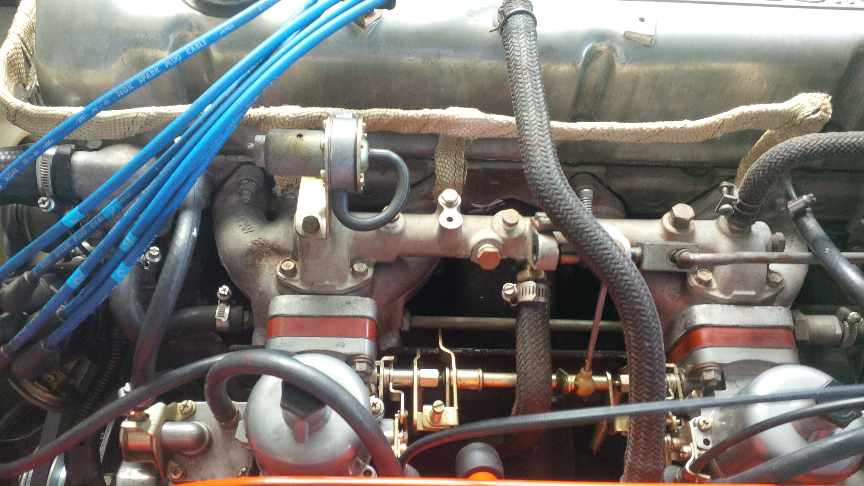

WHere can i get one of these stainless Steel heat shields for my 1972 240z with stock rounded SU CARBS?  This is the one i have in my car and its producing vapor lock or percolation as the manifold transfers too much heat to the carbs. Idle becomes rough in traffic and car tends to stall. Maybe i can get a quote from any of you?IMG_00003174.thumb.jpg.8ce6b0dcfb63a9d76
