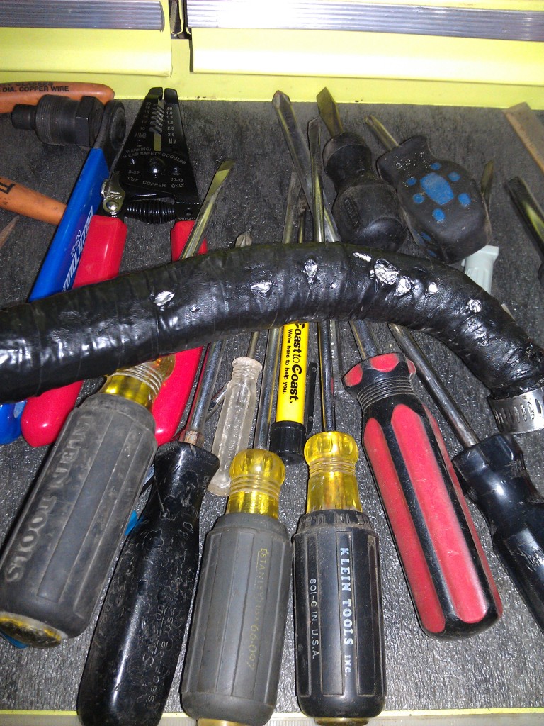

Also just to note, i started to inspect the engine bay more closely and noticed the hose for the PCV valve was horrible, it has a crack at the end that goes into the PCV valve and seems to be wrapped with foil, then electrical tape.. sigh. I guess i'll be replacing that too, now would i have to get a 280z specific PCV hose? because it has a bend to it, or i'll be fine with just some normal 5/8 hose from the parts house? Thank you all in advance.
Picture of the hose
