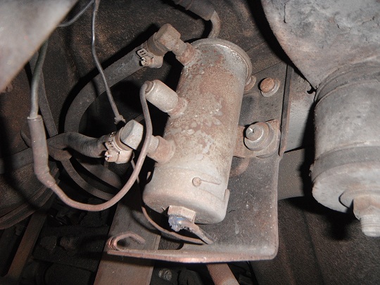

post-24191-14150820976996_thumb.jpgHope this helps. The wire attached to the bottom of the pump is the ground. It's about a foot long and attaches to metal. The one in the middle is the power wire. Took it (the power wire) off the pump to clean the connection which was a mistake, it's sorta not removeable. Stock pump on my 73. Looks better since the photo with black epoxy paint. Not hooked up yet.
