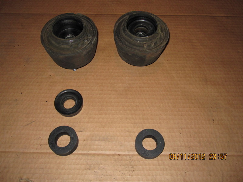

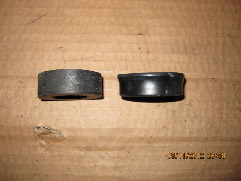

Attached few pictures of what I found in my car. Really not bad but had an effect. Mounts are still rock hard.
Interesting stuff, I didn't even know those spacers were there and didn't realize how much set the old mounts and spacers had taken.
No I did not compare the mounts, the spacers looked just like your old ones, mashed. The rubber on the new mounts was softer to the touch. I really don't know exactly which component made the most difference, but the washers were mashed, the old mounts were hard and the old shocks were stiffer, they had more resistance to being pushed in. Anyway, I will compare on the front and let you know what the difference is. I do know that the wife is happy and that is good. She drives a new Avalon and she knows what smooth is!!
